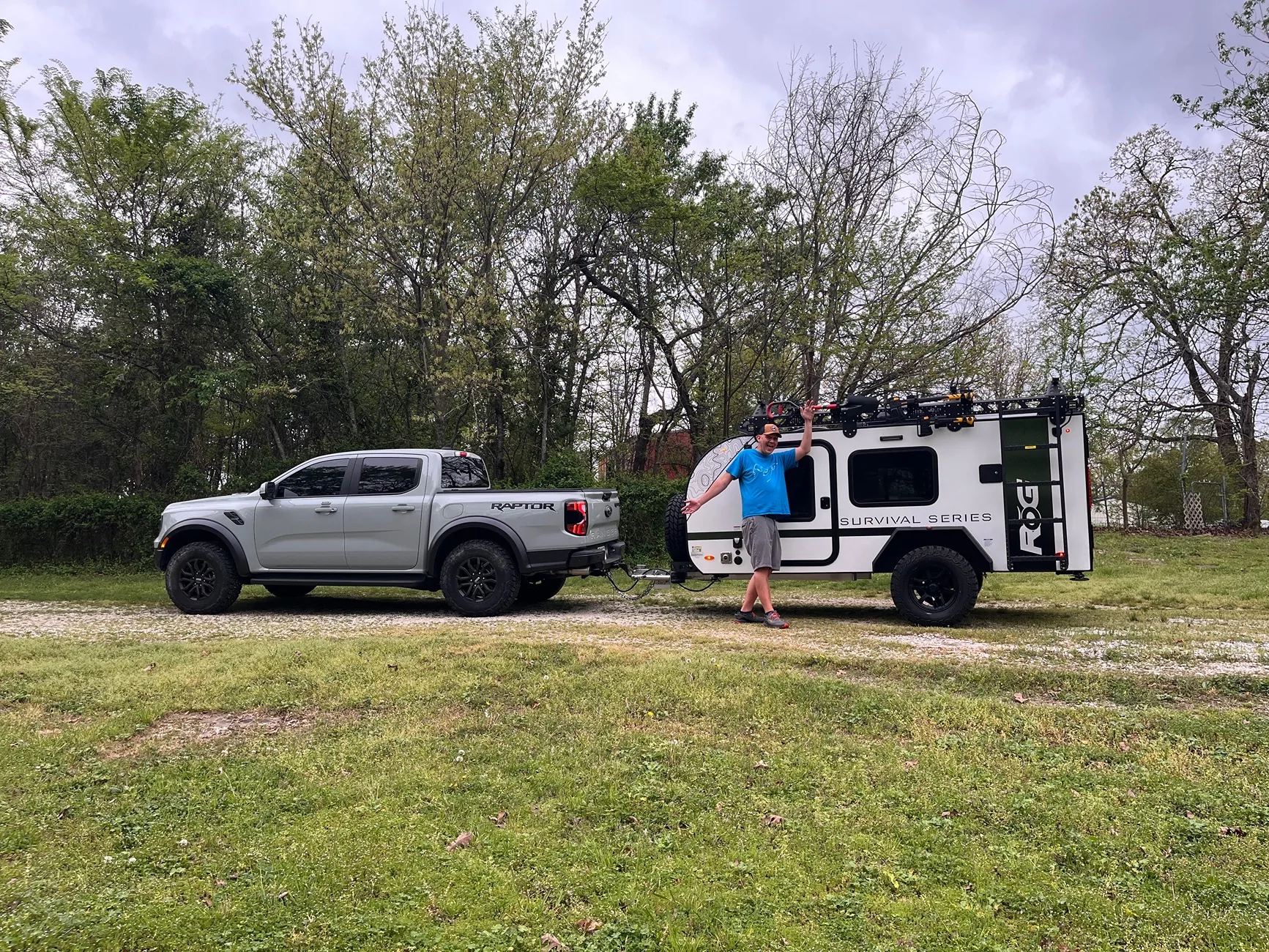

We have a Rög 12RK. Just 2 of us and has everything we need. Kitchen setup is great, 3 batteries plus solar so if off grid can go a week (45 gallon fresh water). Truck handles it no problem, 14-15mpg at 65mph.
Ford Ranger Camper Trailer recommendations IMG_7320

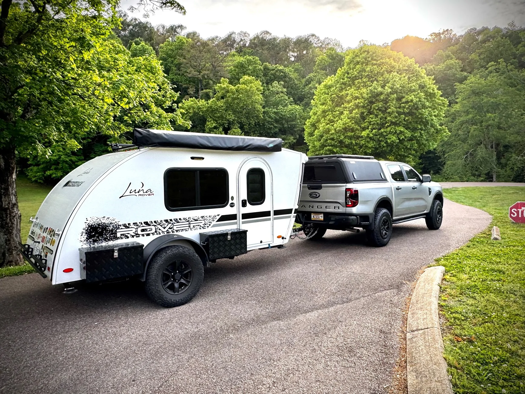

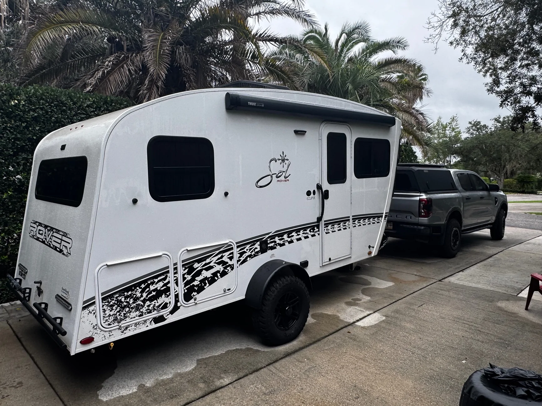

Had an Intech Luna for years, can't even tell it's behind you. Loved it but felt it was time to get an inside toilet and a little more space. Just got an Intech Sol Eclipse. Can feel it a bit more at 3600 dry, 4800 GVW but 2.3L XLT FX4 with 2" Eibach lift and 33's does just fine. Avg 15mpg towing.
Ford Ranger Camper Trailer recommendations IMG_3999
Ford Ranger Camper Trailer recommendations IMG_3412

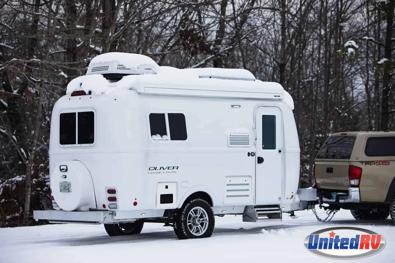

You need to tell us your budget and how many miles per year you would travel.. Most new trailers under $40k are pretty much garbage. It might be time for a field trip to tour the Oliver factory in Hohenwald, TN, the Legacy Elite single axle trailer would be a great match for your truck. They have been out long enough that there are a fair number of used ones on the market.
Video This Oliver Legacy Elite Fiberglass Trailer Has Some Luxury Secrets!
https://olivertraveltrailers.com/travel-trailers/legacy-elite/
I had the bigger LE2 for about six years, it is a truly incredible rig, but that one is too heavy for your Ranger. I no longer have any interest in RV camping, but I would get the small Ollie in a heartbeat for my RR if I did.
