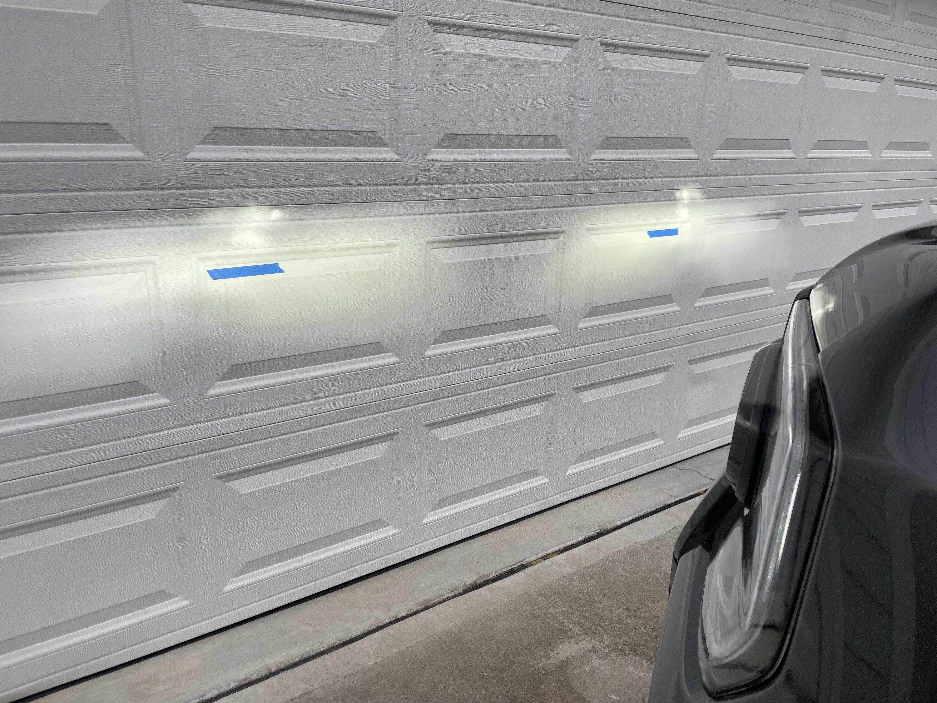

Before I had the lift done in the front, I marked the location of the lights to see if there was much of a difference with the throw. I was happily met with several folks flashing high beams at me the next night.

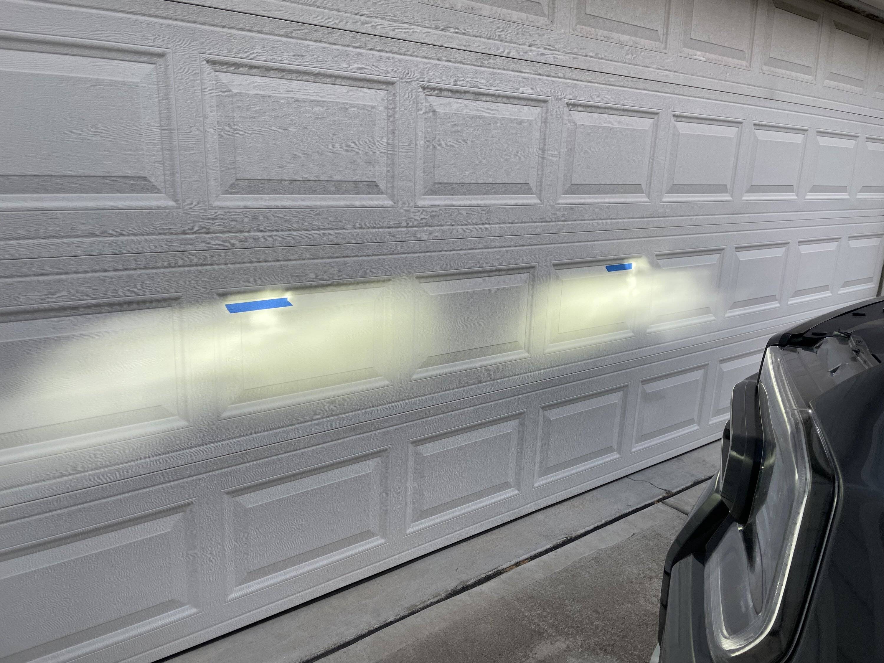

I'm thinking it can't be that much of a difference with a 2.5 level, right? .....About 4".......I'm just blasting folks, which is dumb.

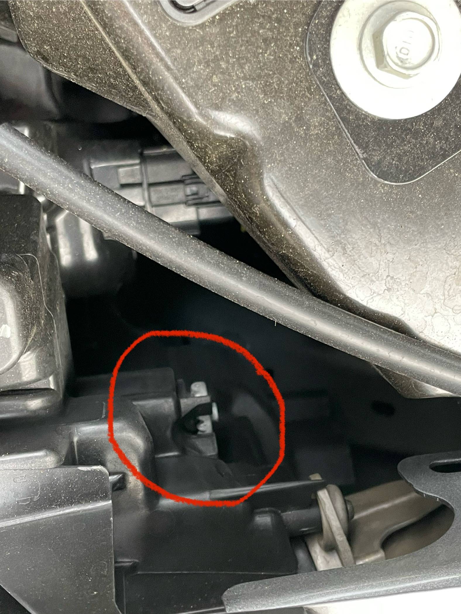

So I located the handy gadget that adjusts the throw of the lights back to normal. I am the saver of retinas. :crackup:
Blue tape is stock height

The headlights are self leveling to the height they are adjusted to. This feature is to keep your headlights shining at the same adjusted height when you have weight in the truck. If you shine your lights on a wall, stand on the rear bumper, you will see the headlights go up, then come back down to the original height. If you put in a leveling kit, or anything that changes the stance of the truck, the headlights need to be re-adjusted.
You can also test by marking the height of the headlights like you did, then use a floor jack to lift the front a few inches and check the lights again.

Did anyone Adjust @ 25" on level ground?
Also curious as the Facebook boys are saying the performance LED needs no adjustment as they auto level. Are they wrong?

You are WAY too close to make a meaningful adjustment and your beam will be too low. Have to make that measurement at 25 feet.
Yes.
They self adjust to the level they are adjusted to, so they stay same height with different payloads. Jump up on the tailgate and watch them go up and come back down to the height they are set at. Half the people replying on FB aren't as smart as a dog.
