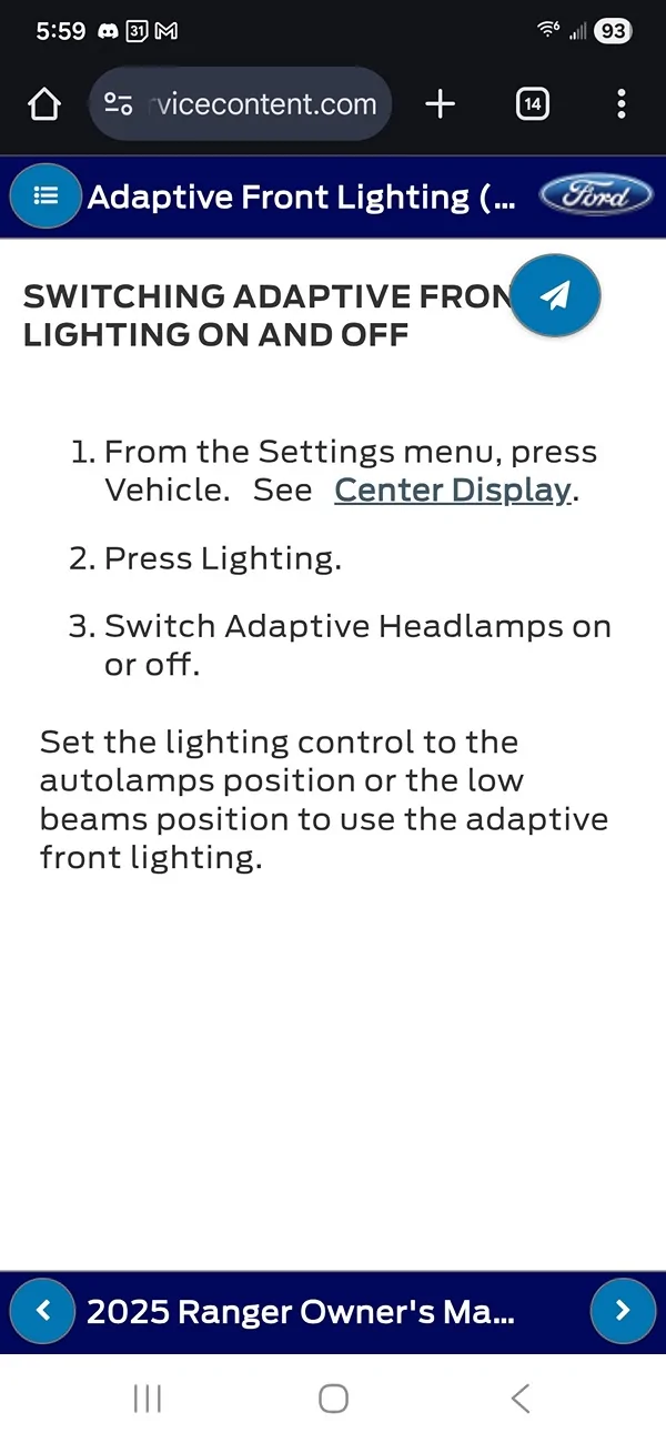

What setting do you have to adjust?
Found it in manual I don't know if it's on or off will check tomorrow when I back in truck.

I am not doubting testimonials here but I just checked and my vehicle settings (sync center screen) and there is no toggle for adaptive lights. My headlights are set to auto so maybe they just do it? I didn’t set the lights to on and then check again though.

So I checked maybe because I am in Canada and not USA I don't have the adaptive lighting function in my settings to turn off or on.
I am also in Canada and do not have this option (I know the manual shows it as well). I have not found a Forscan setting listed in the spreadsheet that enables it yet.
If someone knows the setting, that would be great.
