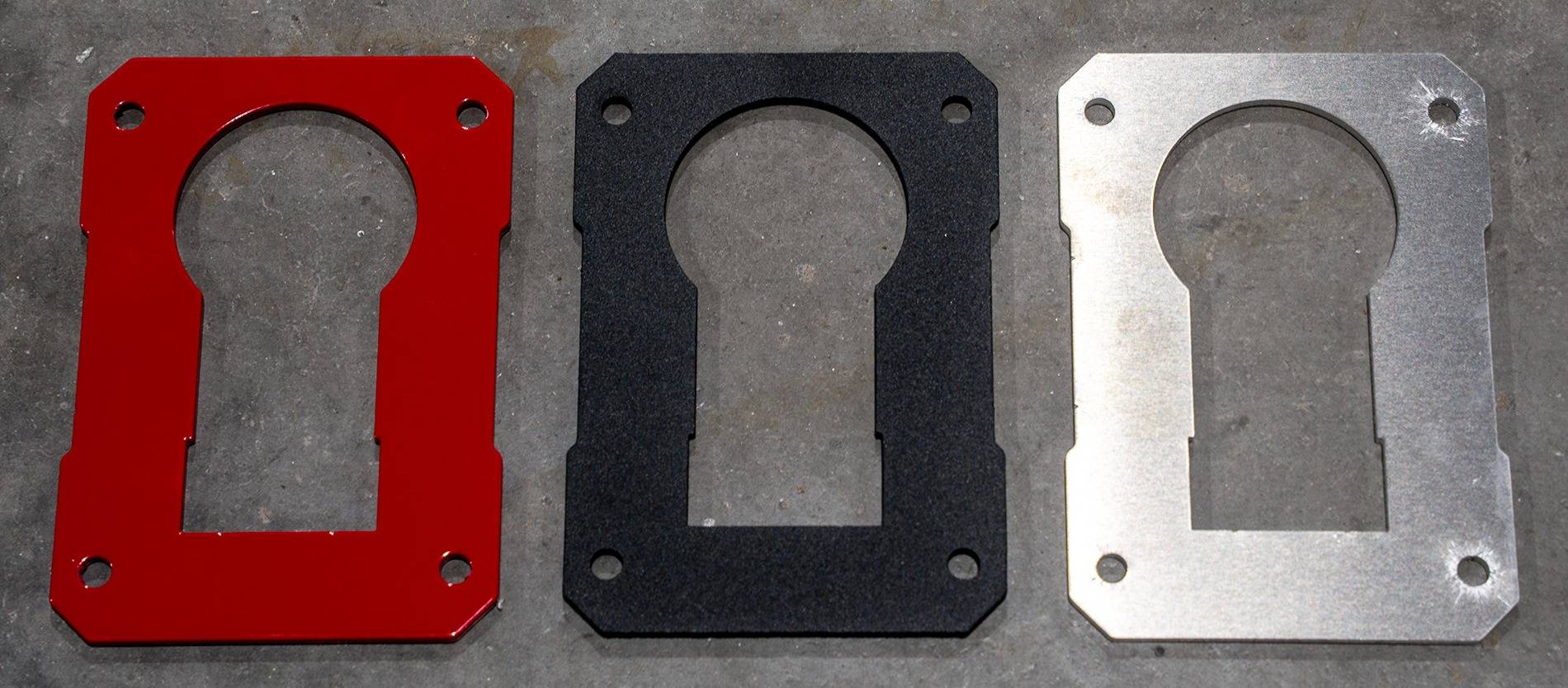

I added this photo to the product page and included the powder link below the Red. There isn't a link available for the textured black, unfortunately.
Ford Ranger Raptor Hitch Plug Relocation - Color Choices - Black Red Raw Aluminum.jpg
I like the red. I’ll be buying either the textured black or the red. Thanks for posting!.

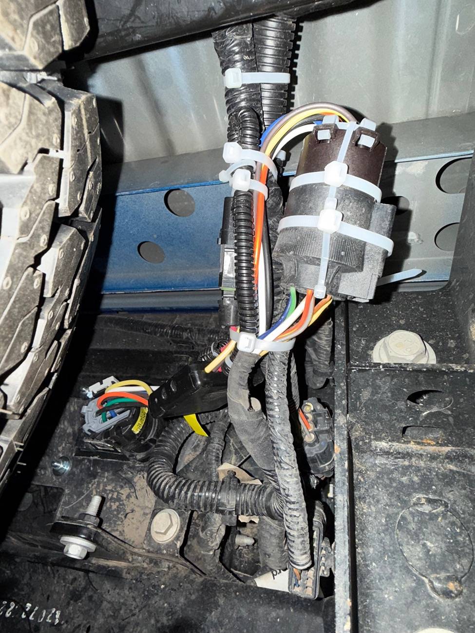

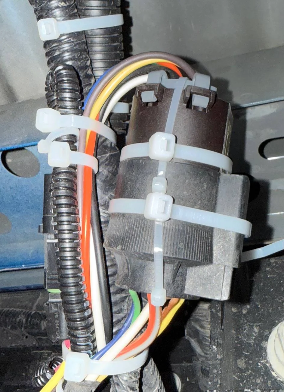

That's a bummer. They just don't make plastic like they used to. You might be able to find that plug at a salvage yard and just pull out the retainer clip and use it on yours. Just a thought. Otherwise, you could try adding a thin amount of silicone to the outside of the plug before connecting the female side. Other than that, you could zip tie the wiring harness in a way that applies inward pressure to the connector to keep it connected.

Thanks for the comments, already did this:
Ford Ranger American Adventure Lab Ford Ranger Trailer Plug Tuck Kit Install IMG_0573
Ford Ranger American Adventure Lab Ford Ranger Trailer Plug Tuck Kit Install IMG_0572
I put it up high it in a spot where I can easily keep an eye on the strapping….. the nylon ties don’t get exposed to any UV, but it does get a little hot in that spot. Tho all those wires are exposed to rock strikes, some kind of ABS or nylon sheet guard zip tied across the front would make me feel better about hooning around on gravel ranch roads… any ideas about that?
