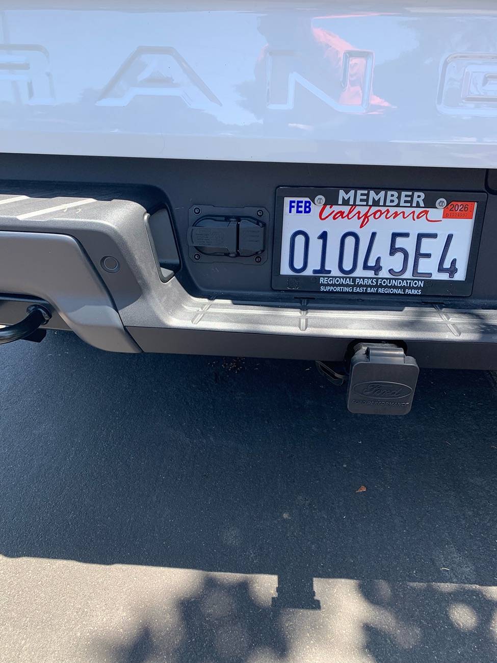

Can confirm that this fits with a 35” tire.(315/70R17 BFG KO2) No need to put any kind of bend in the wiring harness and I even had enough room to get my hand up in there and put the nut on the bolt. No need to drop the tire either.
As others have said, this is where Ford should have put this in the first place, can’t understand the reasoning behind mounting under the bumper.
Also, black hardware is the way, thanks for listening AAL!

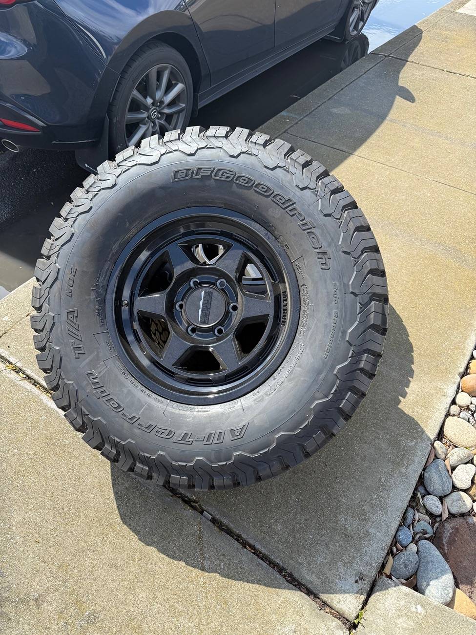

Would you please take several pics from underneath showing the clearances all around the circumference of a 35” tire, and start a new thread about this? I don’t recall seeing this posted before.

Sorry Mr. Davies, you will have to just take my word for it.
Maybe someone with more time in their hands can help you with that request.
To be clear, I own a 2024 Ranger Raptor. I have 5 matching wheels and tires and I do a 5 tire rotation every 5k miles.​
Thanks,
John Davies
Spokane WA USA
I have had some issues with the offset on the aftermarket wheels we chose. So, I don't have the 35's on the spare wheel yet. As soon as I do, I'll get those photos added that you requested.
I have the 35's mounted to the stock wheels right now and really like the look. I did have to put a 5mm spacer on the front to keep the tires off of the spindles. Not a huge fan of that, so still wheel shopping.
