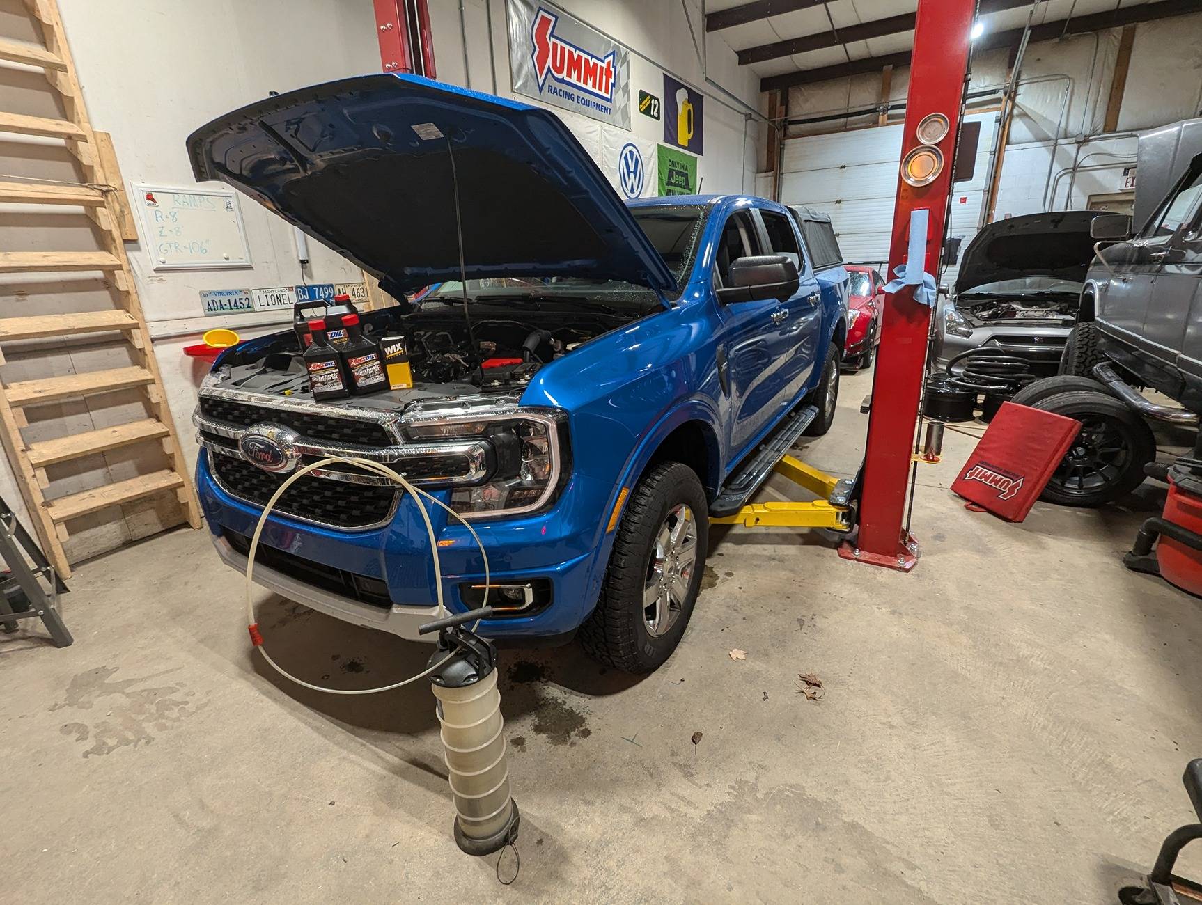

Did my first change this afternoon at 3k and converted over to Amsoil and a Wix filter. I used my oil extractor and managed to pull every bit of 6qt out of it (took a couple of tries to position the hose at the right point in the pan) so this seems like a very viable option for us and will keep us from having to remove skid plates and such.

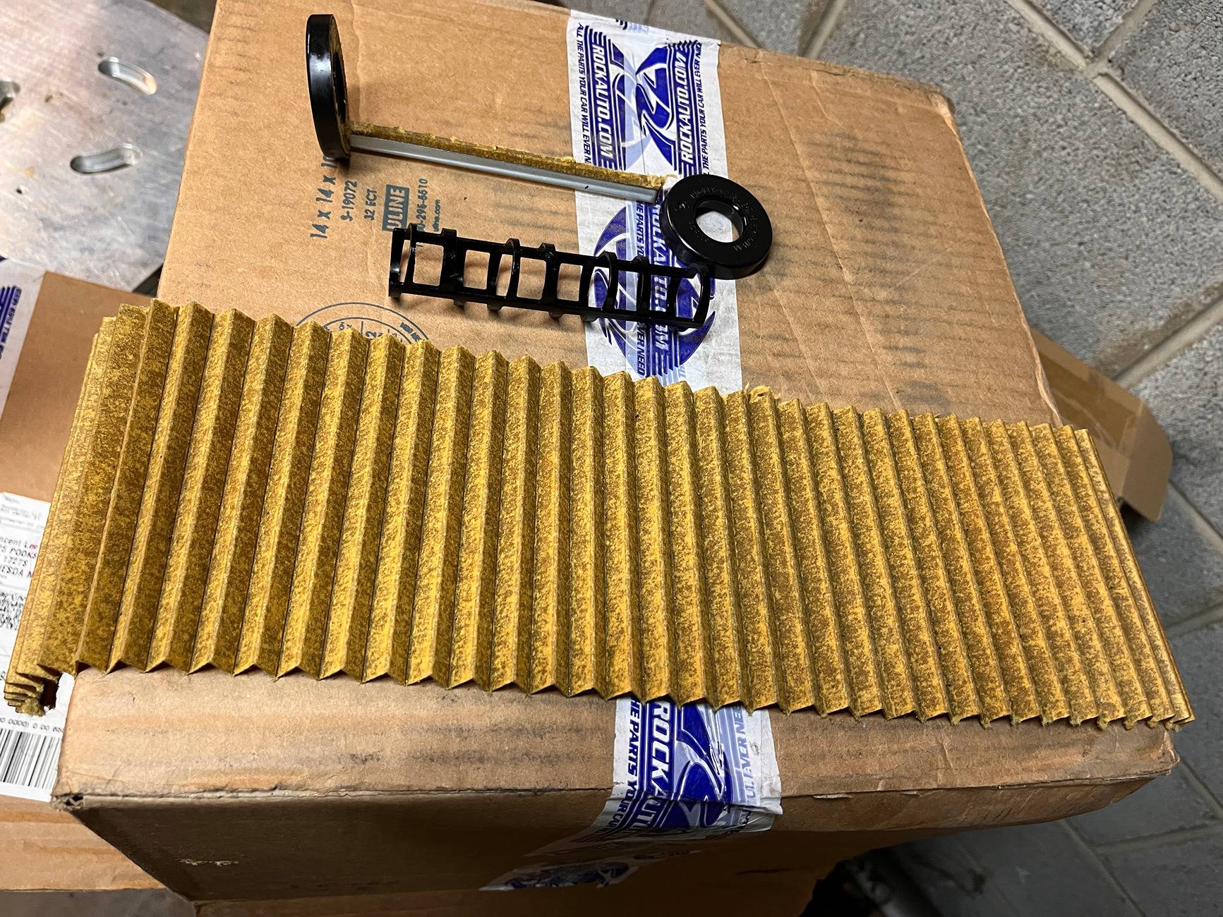

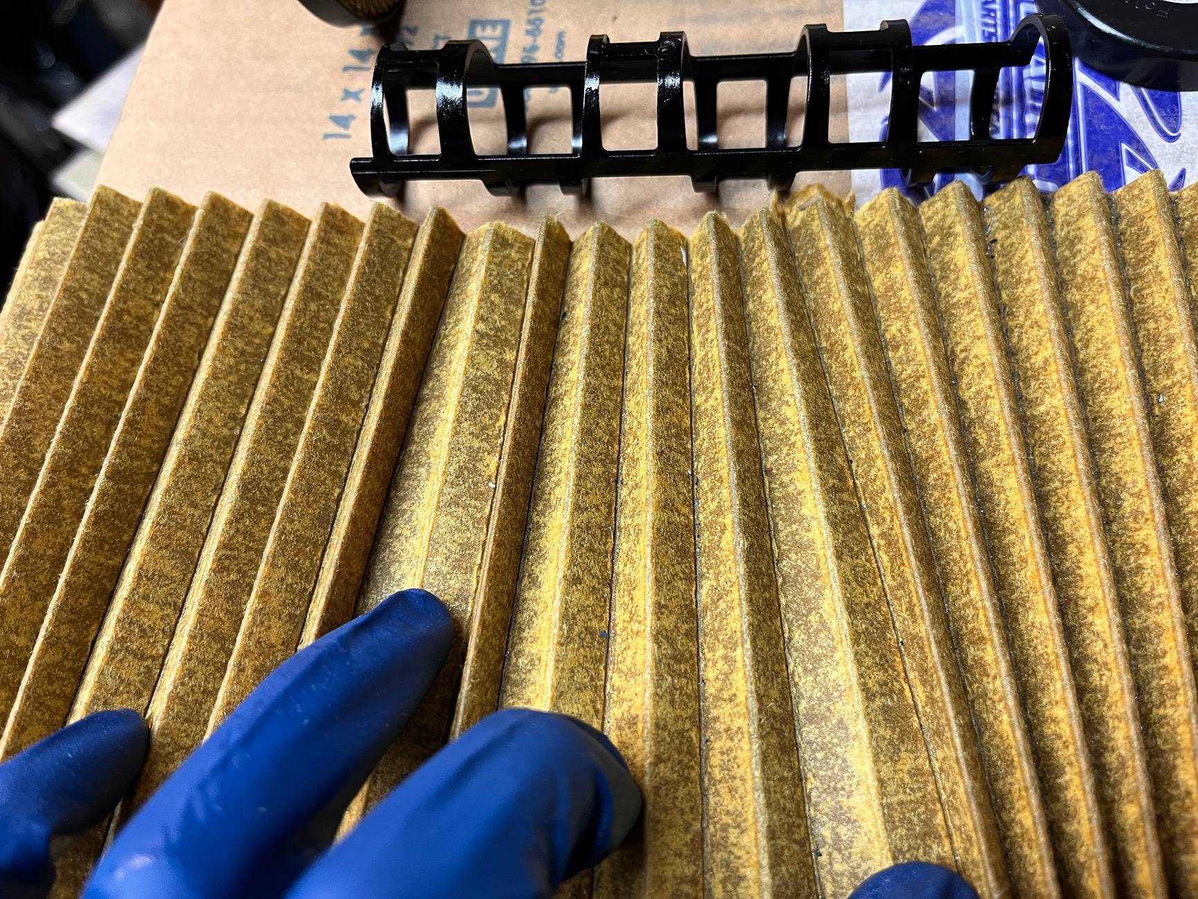

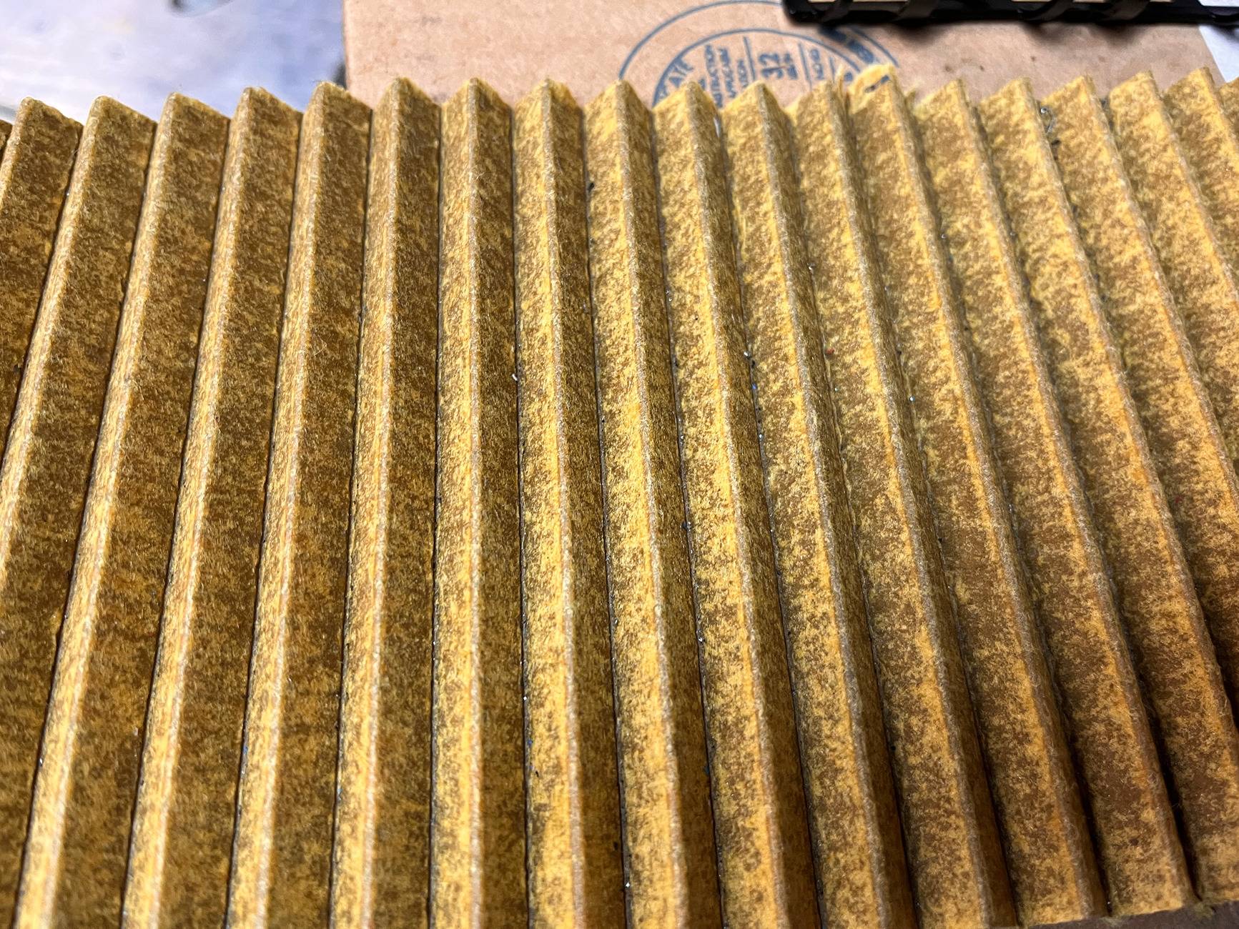

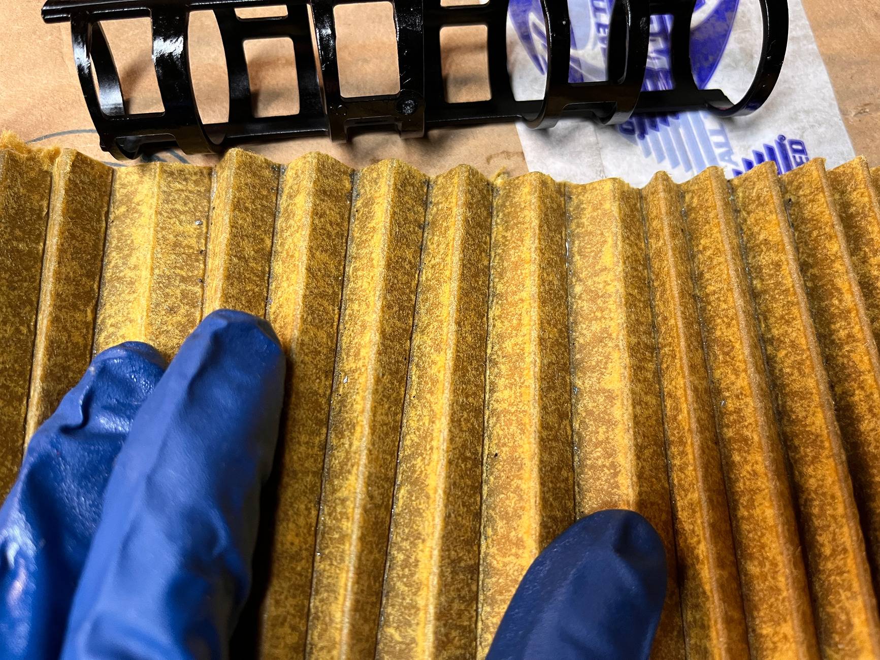

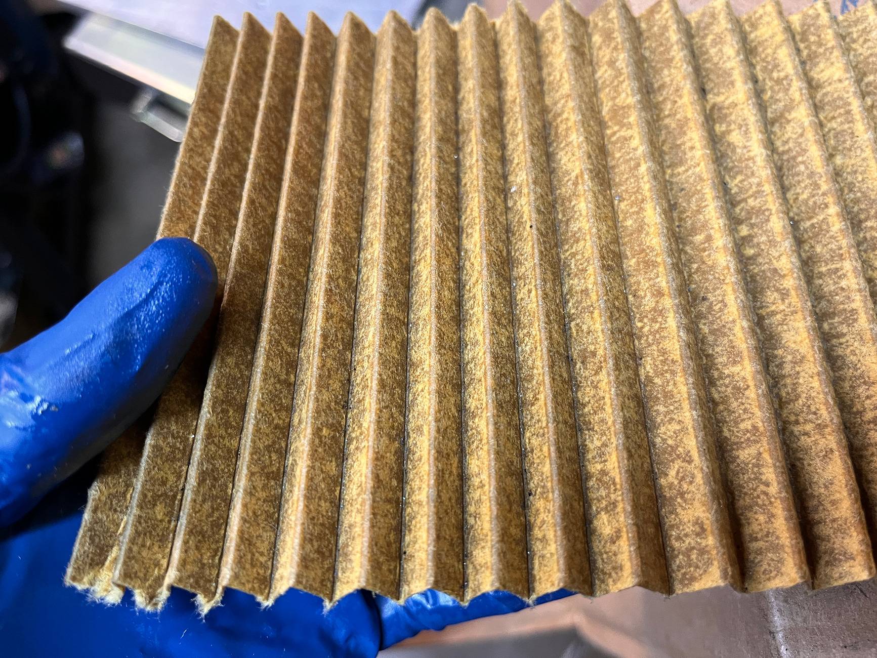

I recently did an oil change on my with about 1,000 miles on it. As others have mentioned, the oil splashes onto the cross member which was annoying. But it was fairly straight forward. Here are some photos of the factory oil filter cut a apart. There is a lot less "glitter" than I expected with some very small bits of silicone in between the pleats.
