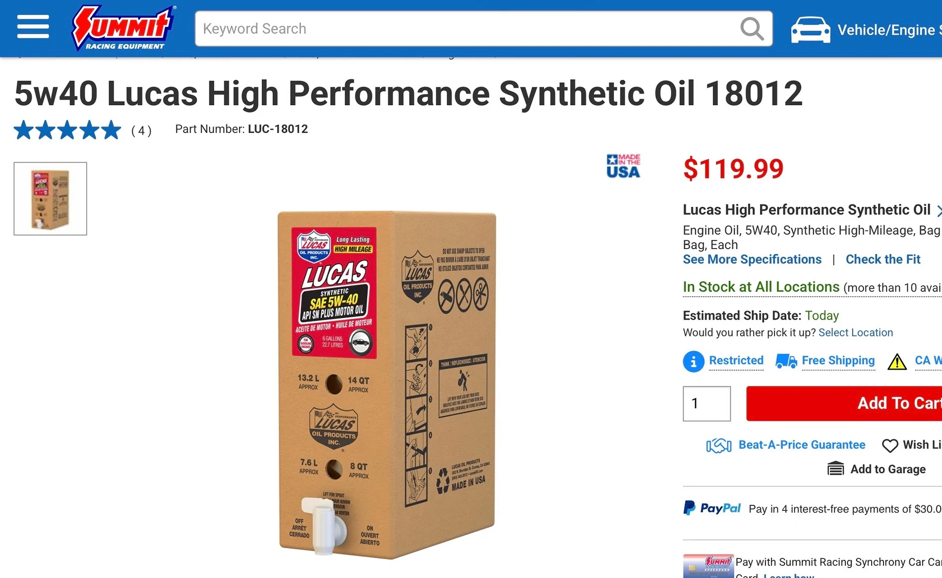

Wouldn’t 5w-40 be a heavier/thicker oil?
10w-30 is the same viscosity as 5w-30 when up at operating temps
You might be correct the 5W-40. Looks like the better choice than the 10W-30 .
So I have found this . I do use Lucas synthetic oils in my motorcycles .

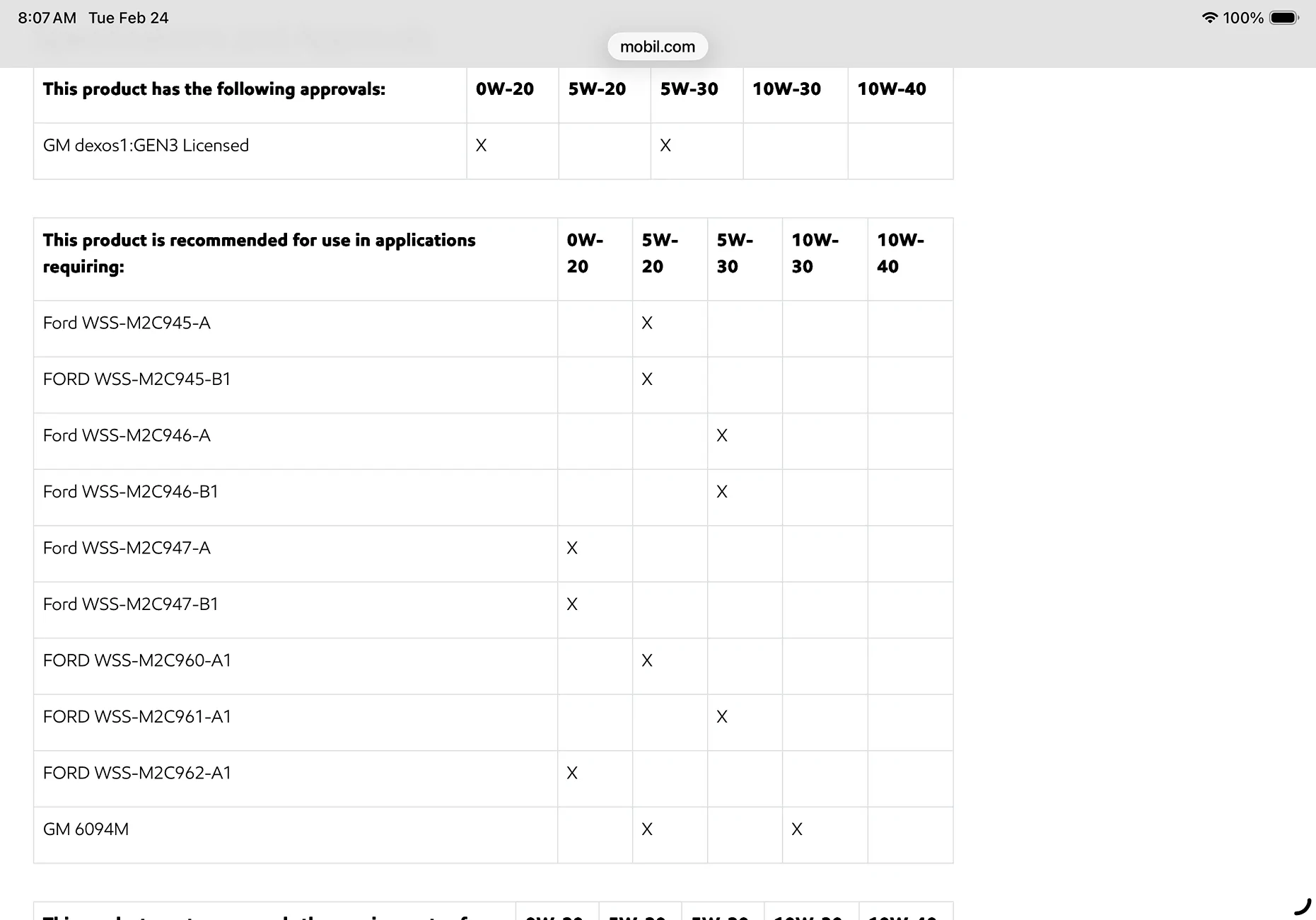

First, use the proper spec oil all the time; it’s WSS-M2C961-A1 or WSS-M2C963-A1 I think for 0w30 (https://www.fordservicecontent.com/...nformation/2025_Ranger_P703_TRD_OM_ENG_V1.pdf). Can you even get the improper viscosity in the correct spec?
As has been mentioned the first number only matters in cold temps. As for the aforementioned theory that a 10w30 will be better than a 5w30, there’s some merit to that theory, but in reality no two oils are the same, so the question about which is more durable between two needs to be left to actual tests and spectroscopy analysis. I'd bet my engine that a premium 5w30 will be "better" than a cheap 10w30.
5-40 would would have a higher viscosity. Meaning thicker oil better suited for higher operating temperatures and higher ambient temperatures.
You can't make generalizations like this about oil. Sure, a higher second number means the oil is more viscous when hot, but that doesn't mean it's "better" for a given engine. For our Fords specifically, you probably can't find one of these oils with the wrong viscosity for our engines that meets the Ford specification, and it's the spec that is ultimately more important than whether you choose the 5w30 or the 0w30 that are the only appropriate viscosities for our engines.
Correct! There is a unique Ford specification for each type of oil (0w-20, 5w-20, 0w-30, 5w-30, and so on) used in their engines. The only application where they spec 5w-40 is the 2016-2019 3.2L Turbo Diesel Transit. As many have reiterated in this thread only 0w-30 and 5w-30 are specified for Rangers. If OP wants to use 5w-40 no one can stop him, but I think it's a terrible idea unless you are actually racing the truck.

The difference between 5W-30 and 10W-30 is negligible as far as gas milage goes. On cold start up the oil is more viscus and your engine will work slightly, and I do mean slightly, harder, but unless you are in sub-arctic conditions it won't matter.
10W-40 would achieve your desired outcome but your gas milage will decrease slightly.
The most import component of modern oils is their wear additives, and these are what engine manufactures use for their specification recommendations.
So as long as the oil meets those specifications you should be good to go.
Mobile 1 10W-40 meets the Ford specs as does several others. Using 10W-40 oil will NOT harm your engine or void any warranties but it will cost you slightly in gas milage.
