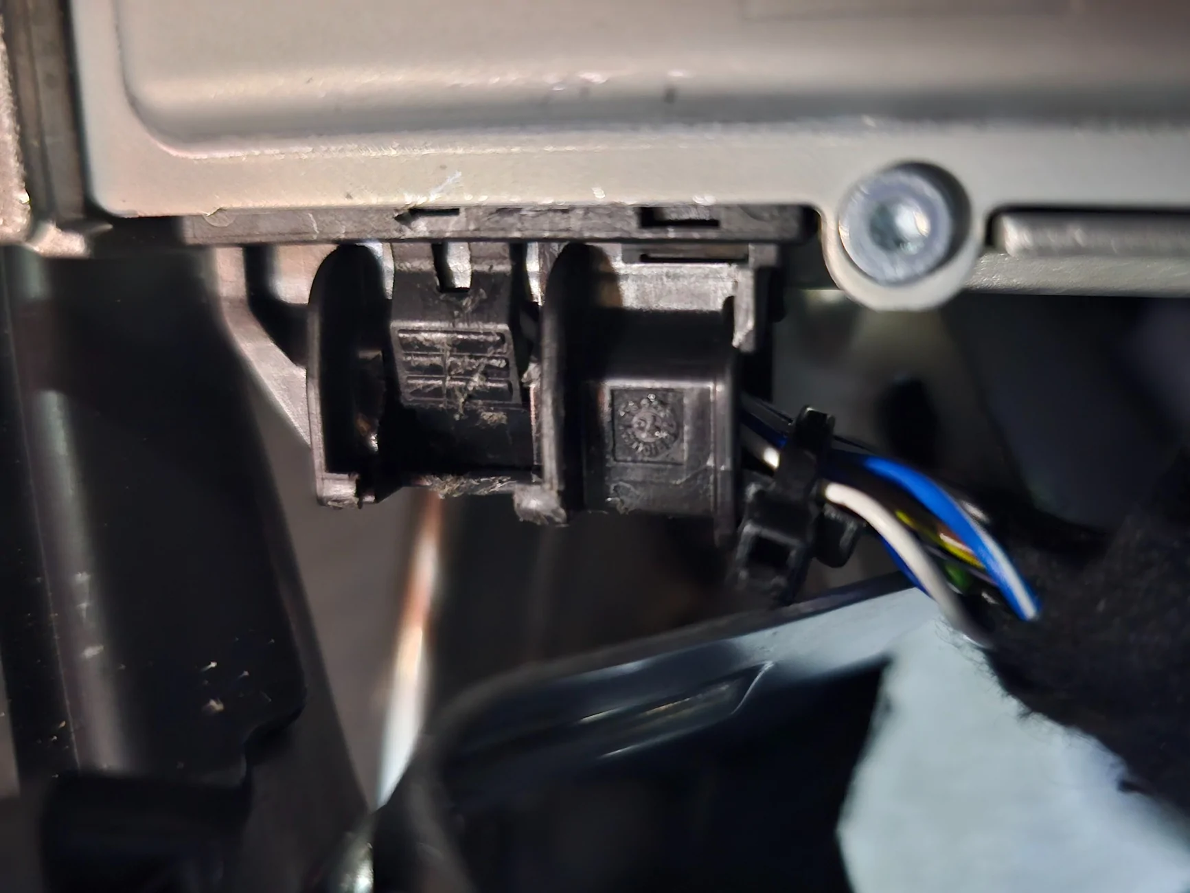

I installed the 4DTech last weekend.
2 days (ok, not all day) to undo the connector and maybe 2 minutes to install.
I watched videos, looked at pics, read posts over and over... and could not undo the connector.
I unscrewed (10mm if I recall correctly) the 3 bolts holding the module in place and even when looking directly at the connector, I could not undo it.
I used a super thin flat head screw driver to press down on the connector just inside (barely) the edge of the module and it finally released.
I have included a photo of the harness still connected to the module.
Hope this can save someone time.

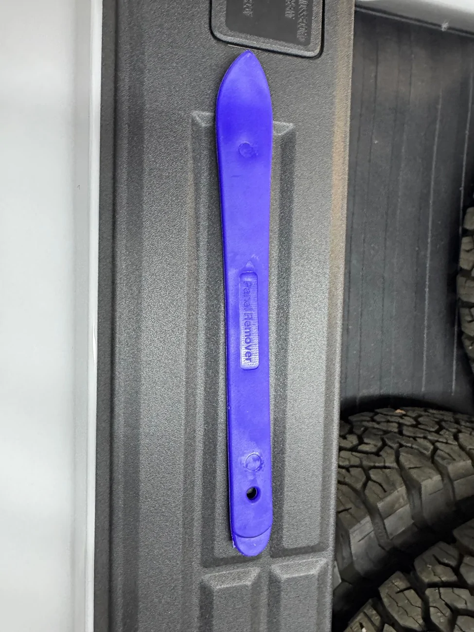

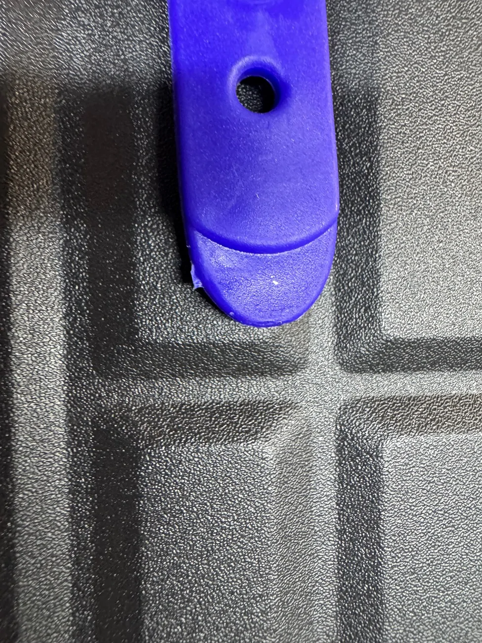

I got my eliminator in today, install went pretty easy.
‘Used a body clip pry tool. Pushed in the release button and used the pry tool, came right out.
Ford Ranger Auto Stop / Start Eliminator IMG_4318
Ford Ranger Auto Stop / Start Eliminator IMG_4319
‘All works perfect.
