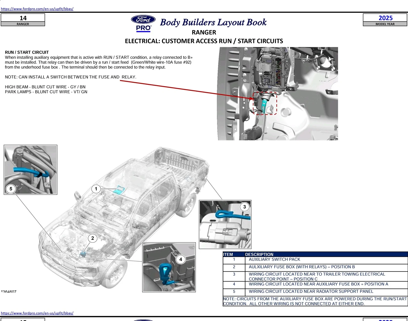

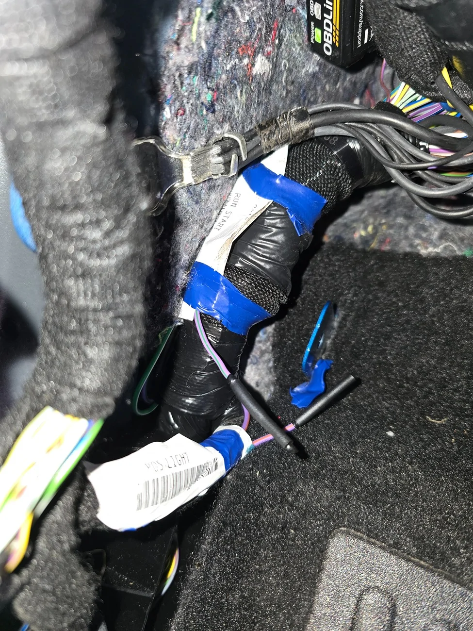

theres a ignition wire behind the drivers kick panel. green run/start wire. also a highbeam trigger and marker light trigger.
you can use that wire to power a relay for large draw items, if its just the ignition trigger for the dashcam hardwire. should be fine. I would add a fuse to it.
my marker and highbeam wires where physically labeled wrong. and wiring colour only matched 1. but the highbeam labeled wire was my marker. and my labeled marker (pos light) was my high beam
all in the ford body builder guide. it also shows the wire grommet locations, brake light signal wire location, etc.

Ford Ranger Dash cams, why so difficult? PSA: Make sure you connect the ACC to an appropriate port/input/whatever Screenshot_20250910_185236_Adobe Acrobat
Ford Ranger Dash cams, why so difficult? PSA: Make sure you connect the ACC to an appropriate port/input/whatever 20250822_150423
Ford Ranger Dash cams, why so difficult? PSA: Make sure you connect the ACC to an appropriate port/input/whatever 20250822_150451
