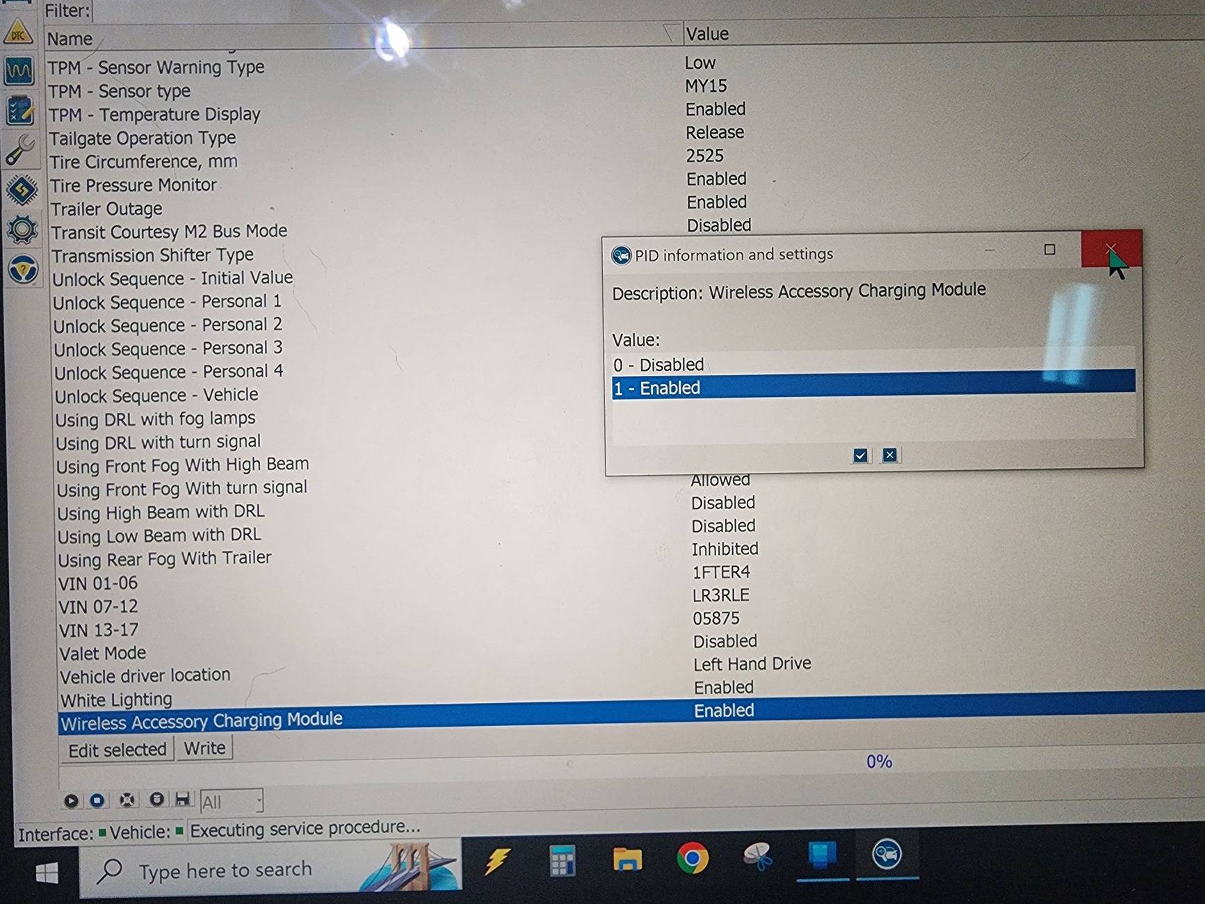

Forscan may be another option, perhaps?
Ford Ranger Disabling Wireless charger 20240524_234014

does it also allow auto start/stop to be disabled ?
It's in there but I haven't tried disabling it. It doesn't bother me much since I use MyMode either way, so it's disabled through my settings. According to the spreadsheet posted in one of the threads, disabling in Forscan results in error codes or disabling other things.
