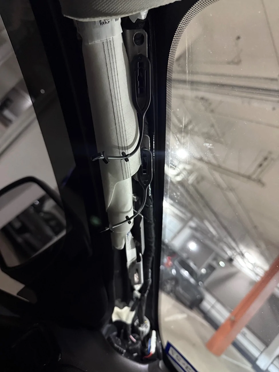

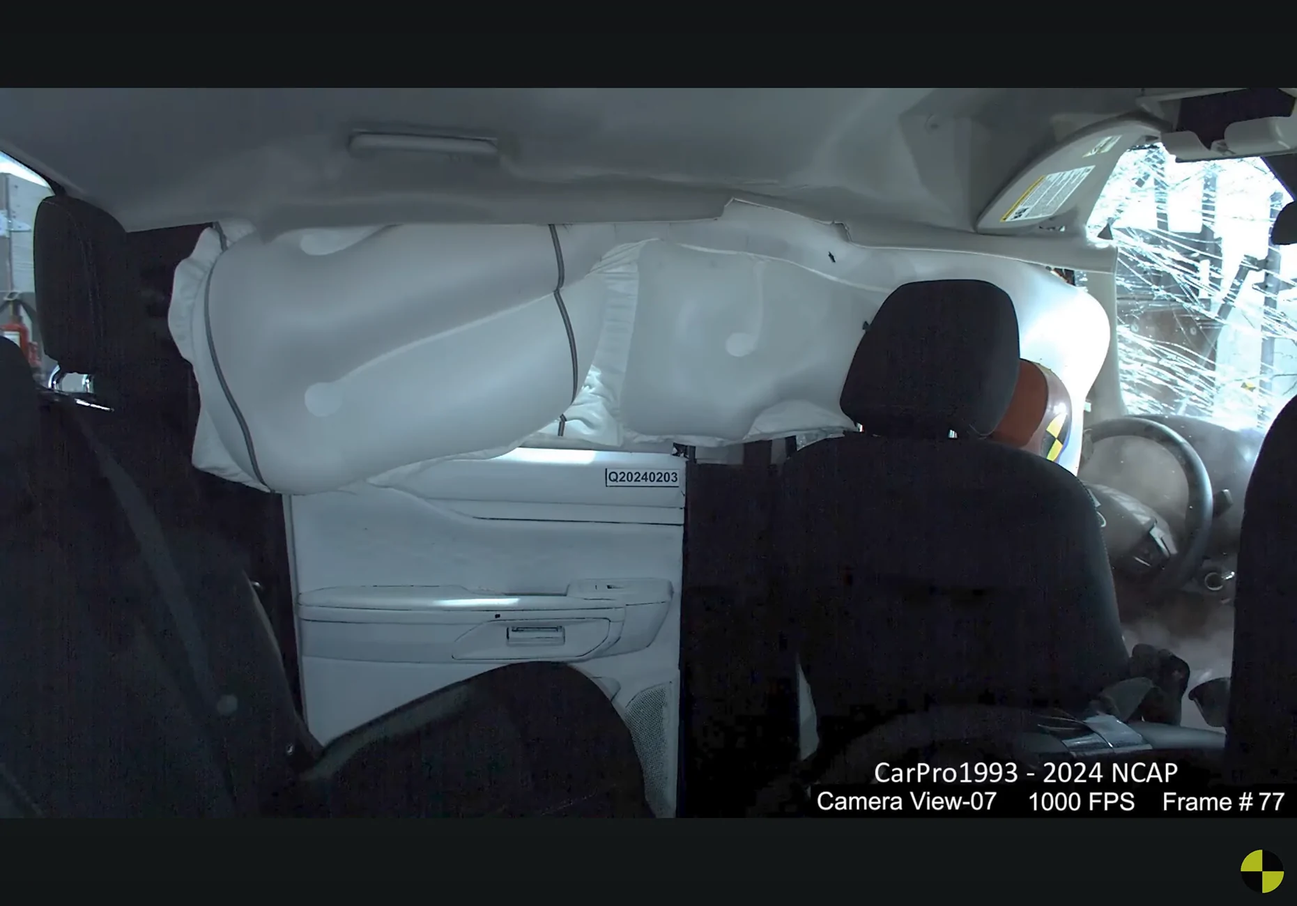

As a design engineer, the problem I see is the fact there is an airbag and introducing an anchor point that does not break away for the airbag could cause the airbag to not deploy properly. While yes, the EU Rangers have this capability with airbags, it was designed for EU regs, so I would venture the airbags are different and the way they deploy is different. It would be nice to see exactly how the EU version is built and allows the airbags to deploy properly so the US owners could reverse engineer one, but this is a big hurdle and likely not something a reputable aftermarket shop wants to tackle just due to liability alone. I would not want introduce a product into the market that could potentially inhibit the airbag from deploying properly and then be sued after a big car crash resulting in injury or death. I would love to be completely wrong and off base but the Ranger already barely passes with the current side curtain airbag debacle, hence the active recall.
Can it be done? Sure, I think so, if one does not care about the airbag and POTENTIAL risks of modifying the system and is willing to own up to the liability themselves. But I doubt there will be an aftermarket solution you can just buy online. This would have to be a crowdsourced and sharable R&D project where any user accepts the risks and installs themselves.
*Just my thoughts and ramblings, I am not a lawyer of any type, SME on US/EU vehicle regulations or airbags or vehicle safety, and I am also not your dad. Please take the above with the utmost respect as a human being and a hint of humor.
as far as I know the airbag extends into the pillar on the passenger side as well.
and that works with a handle.
it looks like, the airbag kicks off the cover but doesn’t really extend down the pilar very far.
there was this thread on modifying the pillar cover for a different speaker where the airbag was shown.
https://www.ranger6g.com/forum/thre...-pillars-and-wideband-speakers-project.22870/
i suppose liability is always a concern.l although somehow seat cover manufacturers get away with it.
