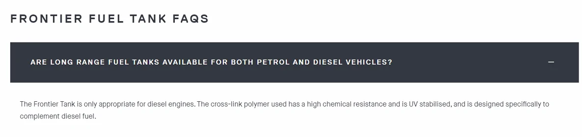

I was sort of curious if they just labeled them Diesel only because all Rangers in those countries are diesel of if there was a reason they would not fit or work on gas US spec truck.
ARB Frontier Long Range Extended Diesel Fuel Tank Ford Ranger T6.2 P703 2022-on - 4x4 Works

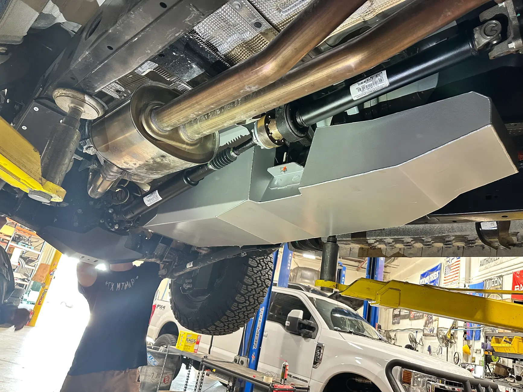

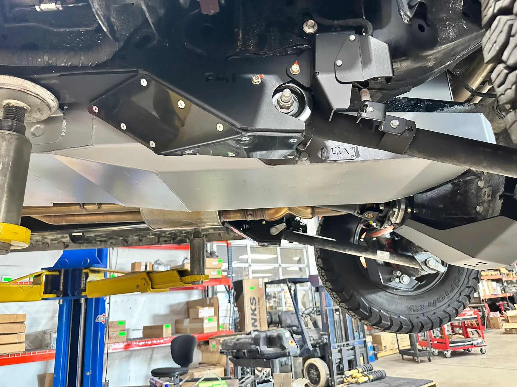

Has anybody found a solution to this yet? I installed a Long Range America tank about 3 months ago and I have no clue as to how much gas I have in the tank--and in all honesty, I really haven't looked at a conventional fuel gauge in 20 years--I only look at the Distance To Empty (DTE) and MPG--which do not read correctly now--and the Ford gauge sucks. I'm kind of old and blind, I would rather have all the gauges with a needle, and the needle, in normal operation is at 12 o'clock. Oil pressure, Temperature, Fuel, etc. In your peripheral vision, you just have to know all the needles are pointed up at 12--even fuel 1/2 tank--you don't have to focus on anything unless the needle is not pointed up and there is a problem.
For anybody considering installing one of these tanks, they are extremely well made and take up virtually every square millimeter of space possible under your truck to achieve that 35 gallon capacity. A lot of attention to detail. I purchased mine from Long Range America, the US distributor out of Boise, Idaho. Even though they say Long Range America--they still are made in Australia and only fit US spec-ed Ranger Raptors. I bought mine on sale for quite a bit less than they are now--I think they were pre-tariff priced at less than $2500 total with tax and delivery to the shop I had install it. I saved a couple of hundred on delivery, as the shop was able to forklift the pallet off the delivery truck. Installation I think almost requires a 2 or 4 post lift and transmission jack. It could be done in a good DIY garage but I had a pro shop do it for about $1200. Here is a pic of it installed.
Ford Ranger DTE with the Long Range America 35 gallon fuel tank (500+ miles range now) tempImageHrj4ZQ
I have had it at two different shops--my installation shop, TMX, in Dallas (which are Raptor specialists) had already done several extended tank installs on f150s with some years that they could not recalibrate and one Ranger Raptor before mine that didn't work either--they didn't even attempt to do mine because they experienced it before. I had it in at my Ford dealer at the same time to warranty broken driveshaft (don't ask), and they had no idea what I was even talking about.
My truck is highly modified--(well, at least I think it is), but even without all of the speed parts, the original fuel tank is way too small--a sub 300mile range is not enough--come on Ford, what were you thinking? Just for clarity, modifying and tuning my truck INCREASED my fuel mileage almost 1MPG from 14.7 stock to 15.4-15.6MPG at about 475whp on chassis dyno (that's about 555bhp at crank)--so it didn't make it worse---but, with what I am doing now, the mileage is about to get way, way worse, 30% worse.
I have spent the last couple of months preparing my truck to run ethanol--e85 specifically. E85 requires 1/3 more fuel (by volume) to do the same work as gas--so instead of getting sub 300mile range on 93 octane gas, I would have only been able to do sub 200mile (I think my exact computation estimate was 187miles) per tank range on e85--that is just way, way too little range per tank. With this Extended capacity fuel tank, I should be able to get over 500mile range on 93 octane gas, and about 350miles on e85 (which is more range than the stock tank on gas). Now, someone is going to ask why switch to e85? There are a whole host of reasons beyond Recalibration our fuel gauges which we are talking about here--in a nutshell--1. Performance, 2. Engine Longevity, 3. Greener Emissions, and Economics.
But here is another reason I need my tank/fuel gauge calibrated, I need to know almost exactly how much fuel is remaining in the tank to safely change the Tune to run different fuels. I am in the Dallas area and e85 is available here all over and is relatively cheap--$2.30-$2.70 a gallon verses $2.99-$3.54 for Top Tier 93. But, in winter/cold weather, or if I head out towards California or Mexico there is almost no e85 and it even becomes hard to find 93 octane. When I switch fuels, if there is 1 or 2 gallons left in the tank and it becomes diluted by the new fuel I am changing to, the computer can adjust for that. If there were 10 gallons left in the tank and you top it off with a different fuel, the resulting blend is more than 30% off and the computer will fault--you risk running way too rich and clog or overheat Cats, or way too lean and burn pistons and valves--either way, it could be lots of money. There are other ways to monitor and correct. If you look in the picture of my fuel tank above, look at the fuel tank just below the front of the trailing arm, where there is the welded on tag that says LRA--just to the left of that you see a silver bolt head (it is kind of in-between the LRA tag to the right and the Faust Trailing Arm Skid. That's the drain plug. Its a pain, but I could just drain the tank and know exactly how much is in it--or I could use an ethanol content meter like the Nostrum ESSIM. etc (when they get a new sensor kit).
Now, somebody correct me if I am wrong, my understanding of what is going on is that newer Ranger Raptors Store and receive data differently than the older/Aussie/Worldwide versions. Older versions/Worldwide spec trucks store the tank capacity in the dash module and we can use Forscan to change the fuel tank size using published data in that location. The problem is with the newer US vehicles, they store and retrieve the data from the PCM--not the dash module. If you use Forscan on the dash module of a later vehicle, it still has the legacy fuel tank parameters there--you can even change them--but nothing happens or changes because it draws the data from the PCM. How do we change the tank capacity in the PCM?
I am not sure, but if our tank capacity is stored and has to be changed in the PCM, is this something that can be accessed and changed using a tuning device like HP Tuner, Cobbs, Livernois, etc? Is there something I am missing?
If anybody has any knowledgeable input how to do this I'd really appreciate an answer.
