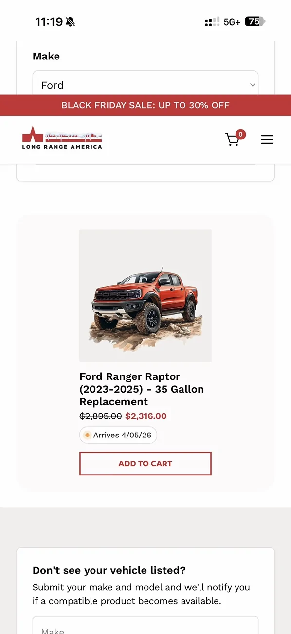

I have been seraching high and low for Poly version for Gas US built trucks, not finding anything.
Only Poly tank I can find states Diesel fuel only.
Anyone know why that is?

Here are some educated guesses why:
They would be much more expensive. They would have to develop molds for every single tank style rather than just have a water jet cut the parts out of aluminum sheet. R&D costs and the mold costs would have to be recouped. Molded parts cost WAY more to make up front.
Using a poly tank would constrain the tank design to have the same dimensions at the bottom that the OEM tank has or would require all new tank mounting straps and skid plate. Not ideal.
A plastic tank might not handle the weird tank shape required for the extra capacity. My tank goes over the driveshaft and has other weird dimensions designed to make the best use of space possible.

I was thinking one it would look more OEM if in poly, and two I was concerned that every pebble flying off the tires and bouncing off the tank would make a lot of racket.
That is sort of in a nutshell why I would prefer a poly tank.
I was sort of curious if they just labeled them Diesel only because all Rangers in those countries are diesel of if there was a reason they would not fit or work on gas US spec truck.
