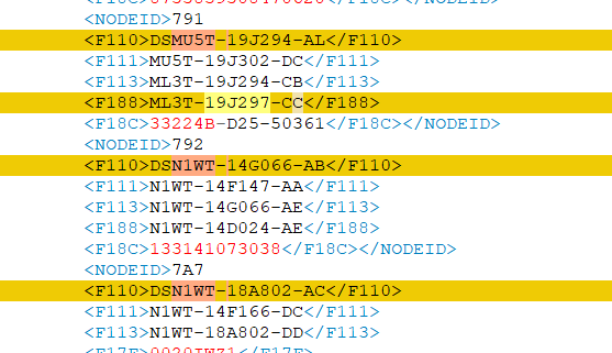

Well, if it gets to that point, I took snapshots of all my ecm monitor screens to prove it. I still think it's partly the FP app. The vehicle starts fine with the key fob in the house. It would choke if the battery was dead. Even after I run it, the amount of gas left and gps doesn't always update.
I'm determined and have all the software and hardware to do it myself. I have 2 modules that need updating, the acm and trm.... Both will get done because the dealer is a pain in the arse about it. Tomorrow or Weds it supposed to get warmer. We shall see.
I'm attaching the SSM I found. PDF format...
Also an AB screen shot of the firmware of the mentioned serial number.
Thanks I’ll take a look at it.

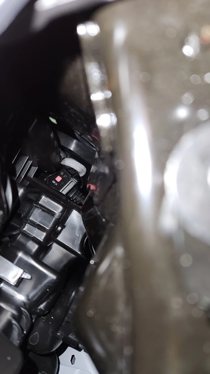

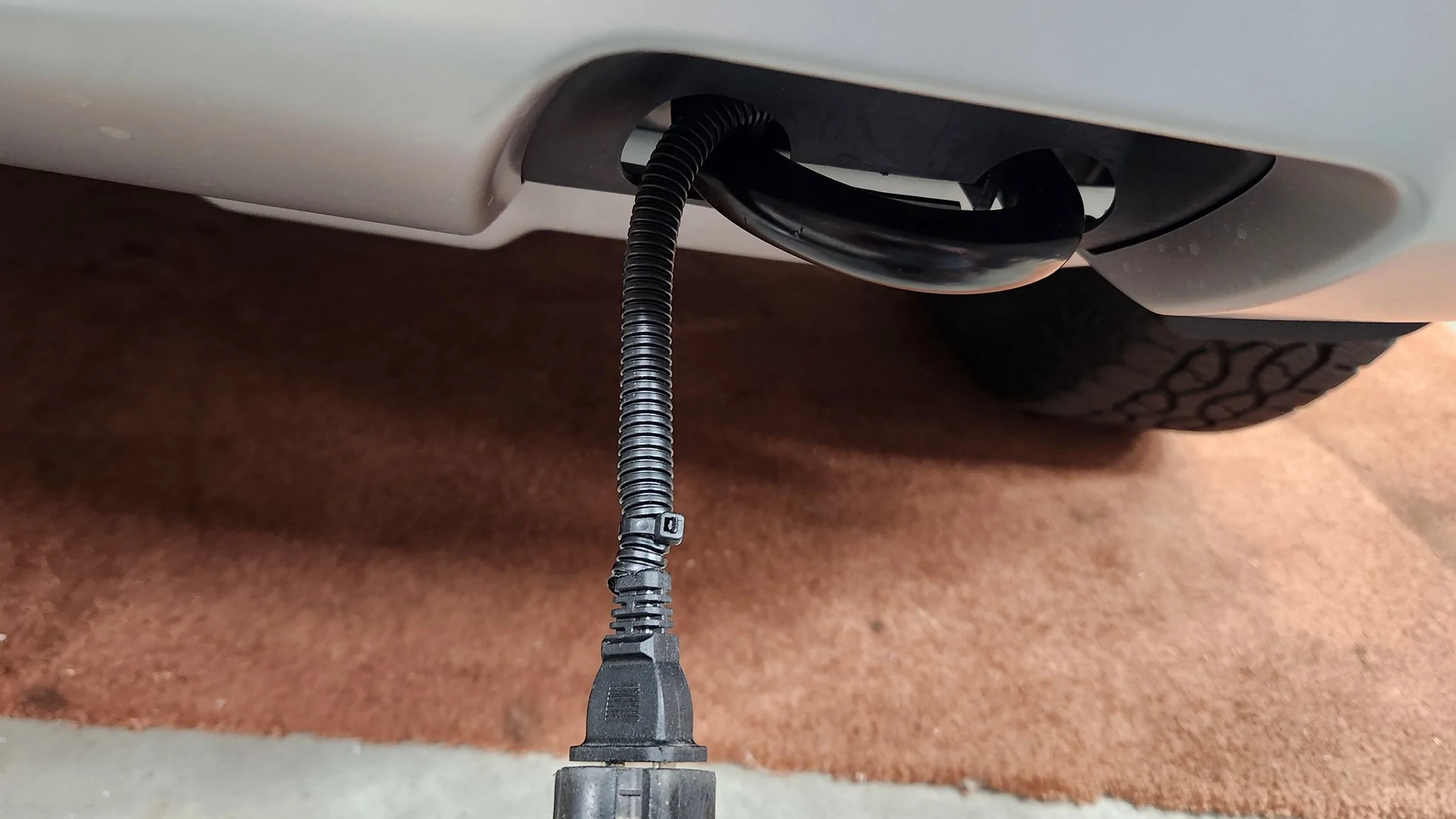

I would disable auto stop/start for one, and I would install a battery maintainer like the NOCO 2D. There is room for one down behind the left headlight next to the frame and the power cord just reaches the tow hook which makes for a good place to stow the cord when not in use. Long skinny arms help with the install and a zip tie or two to hold it in place. Remove the skid plate for better access.
I have maintainers on all my vehicles, modern vehicles are always sapping your battery when parked and if you don't drive long enough they don't get topped off which is detrimental to lead acid batteries, every day they sit under-charged they lose capacity that they don't get back.
Starting your truck and driving to the store, then starting it and driving home likely leaves it under charged and losing ground daily, not to mention any auto stop/starts on your short trip and the normal parasitic loads when parked.

That would be nice but I live in a town house and have no way to run power to the truck. I do have the stop/start disabled.
