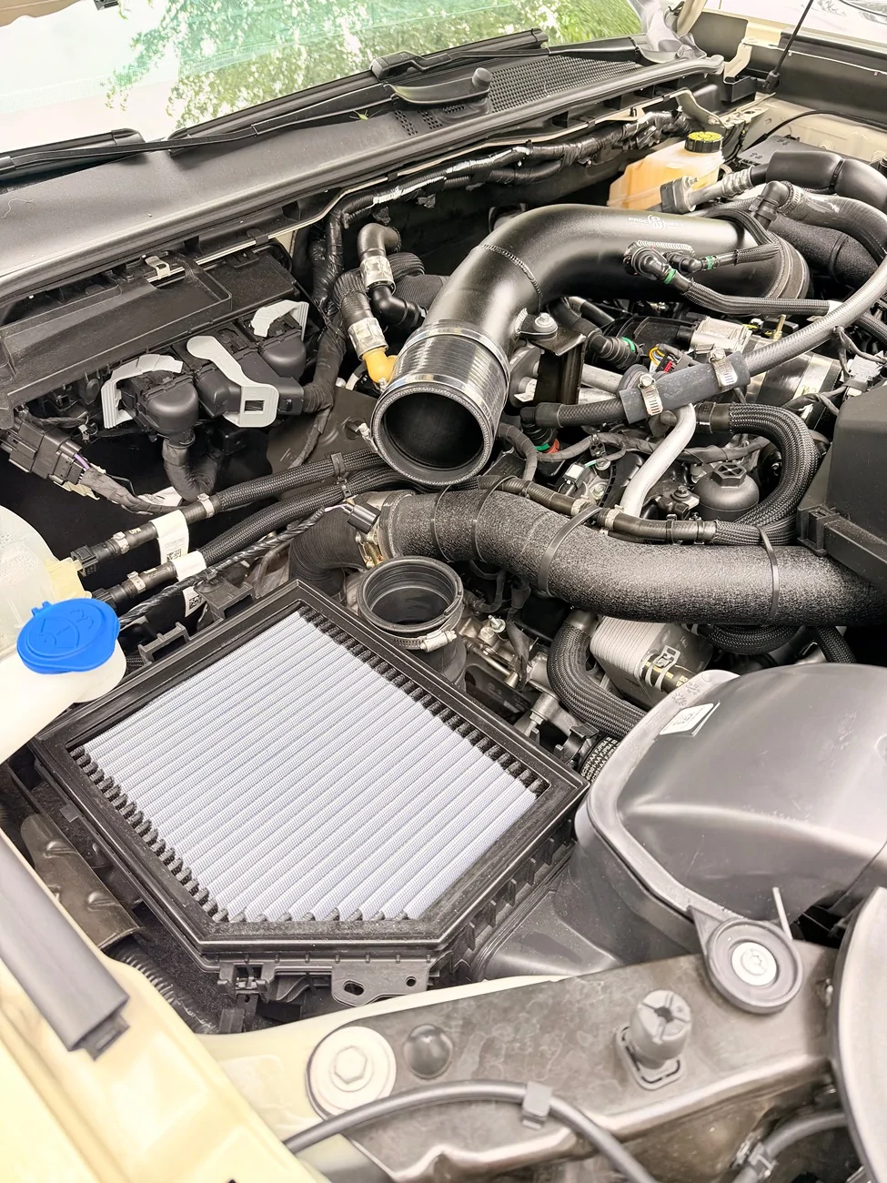

Looks like an AFE oiled filter.
No thanks.

I found this while searching the Ford Performance website.
https://performanceparts.ford.com/part/M-9601-BR30
Rebranded K&N?
Regardless of 'rebranding'' source, spec states "washable, reusable" which means oiling required.
Certainly, tradeoffs for oiled vs dry media; however, with turbos and direct injection an incorrectly over oiled filter either another source for intake gunk accumulation, under oiled potentially decreased filter efficiency and/or more frequent filter monitoring ➡ especially if off-roading.
An advertised 7.6% flow increase totally negligible 👎
IMO, don't see compelling benefit of oiled filter for this application.
