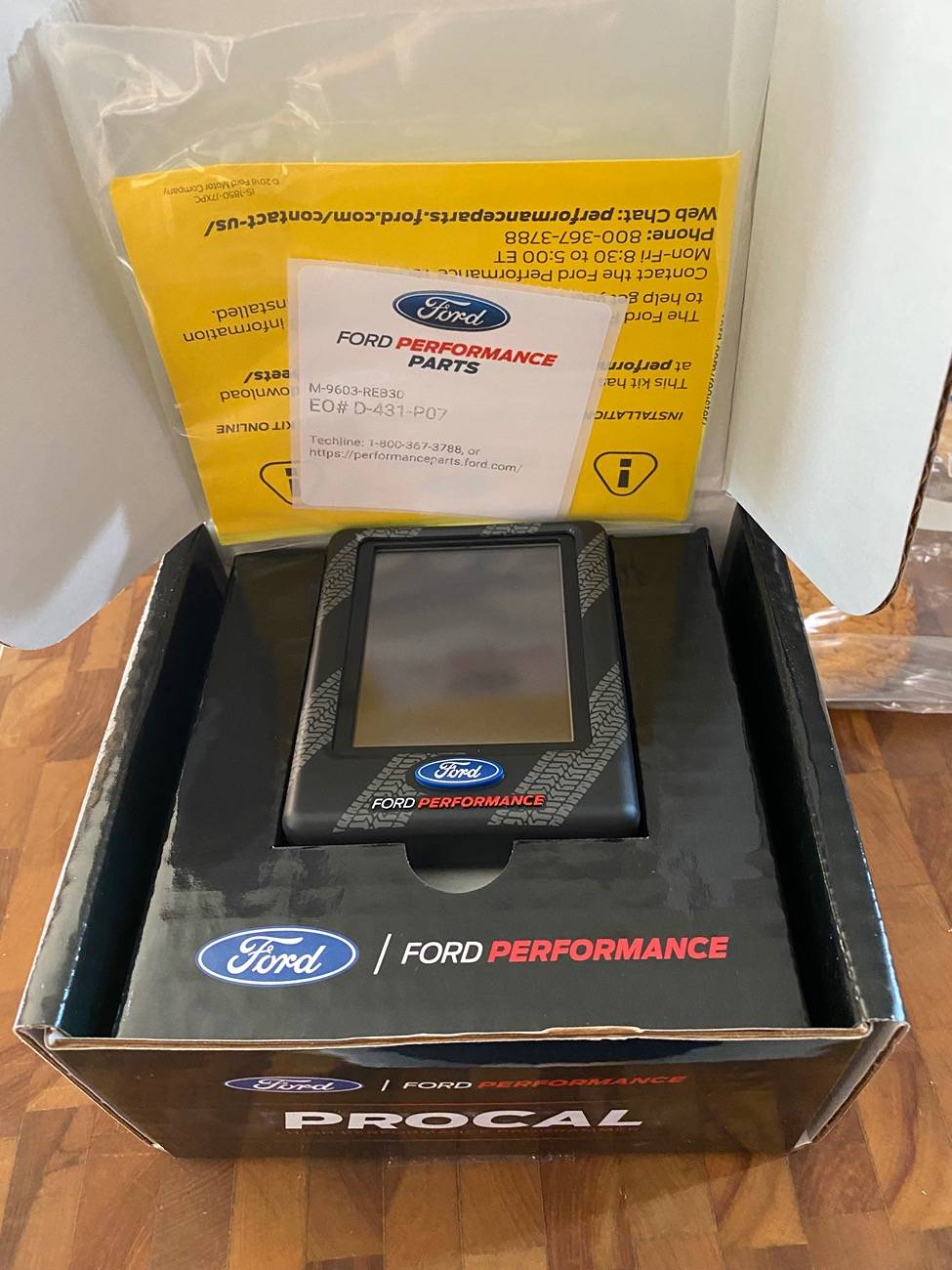

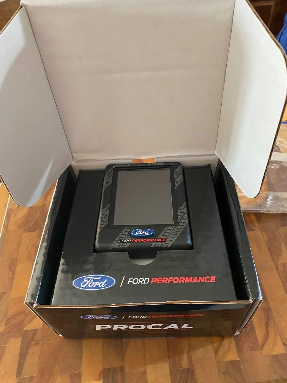

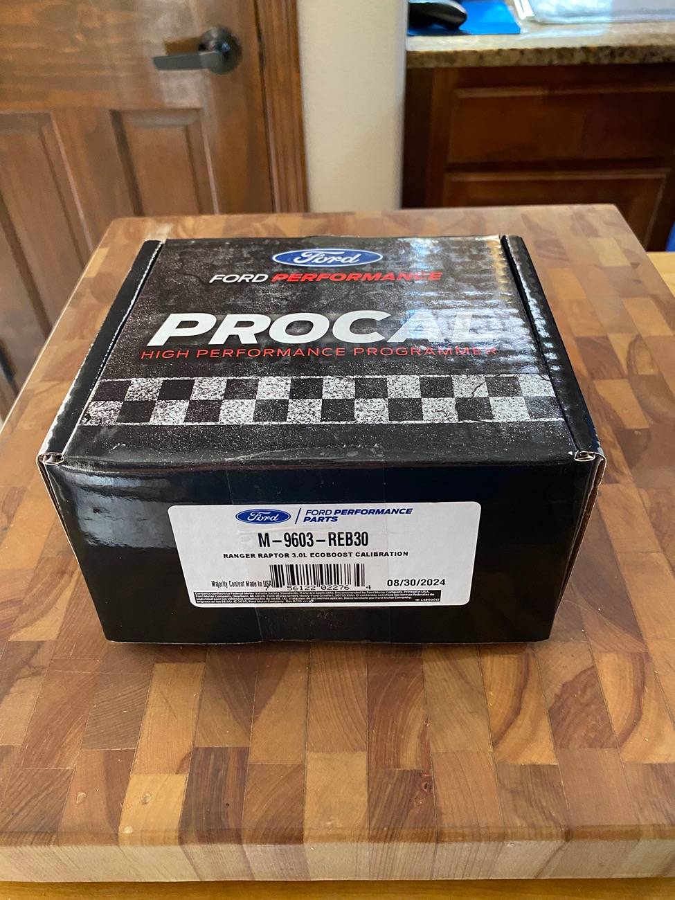

Recieved mine today, and installed right away. For reference I own an ASE independent shop, and I am a former Ford dealer tech, so I do mine myself, but, ANYBODY could do this...there's literally no way to screw it up. Unlike Bronco, it worked properly right out of the box. Also I DID notice that when saving the stock cal it also saved the steering rack cal...this leads me to believe we will be getting the FP steering rack soon, and can use procal to program it (although on Bronco that has been hit and miss...w/emphasis on miss!).
1st thing you are gonna want to do, if you have never had one of these, is start an account on performanceparts.ford.com and assign your voucher code to that account. Then if you are having a 3rd party install for you, give them those credentials (email, password, voucher code). After that it's very simple. Connect the blank procal to the desktop w/procal software installed. Allow it to check and update firmware (while still blank). Once done attach the procal to vehicle OBD port and allow it to save stock cal (does it automatically from the "programming" tab). It will marry itself to the vehicle's VIN at this point. Then, return the procal to the desktop where the desktop tool will upload the stock cal, and prompt you for your login credentials for Ford Performance. If everything is correct it will burn your credit for the tune, and download the tune to the procal. Device is now married and loaded w/the tune software. Then back to the OBD port and (best to have a jump box on the battery just in case), flash the performance cal...takes about 10 minutes.
