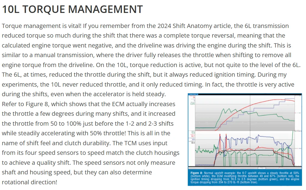

Just some additional food for thought on the Pro Cal and the 10R60, but I made this point before about torque limiting during torque lock engagement. The ECU calibrators can limit torque significantly during the lock-up phase, so the torque lock only needs to manage "holding capacity" vs transitioning capacity (where you're fighting the rotational mass AND the applied torque).
It's kind of like the concept of a manual with rev matching and it's not new, I suspect this has been common for the last decade or so ever since drive by wire became standard (although it could be done on older cable throttle systems to a degree with engine timing, but that was much more limited).
Gears Magazine - Shift Anatomy: The GM 10-Speed
The link is to an article on GM's 10-speed, but if you scroll down, there's the section of interest (which proves the point about the Pro Cal and the 10R60, how the powertrain engineers at Ford could easily torque limit the tuned 3.0L to the same values as stock, just apply more power after converted lock-up):
Ford Ranger Ford Procal Performance Tune Installed! 1773855016810-jy
So, in the GM 10-speed example, the powertrain engineers were adjusting throttle electronically regardless of pedal position to sync the speed between the crankshaft and the torque converter input for the next gear ratio (increase or decrease RPM depending on up or down shift), kind of like rev matching.
The point isn't that Ford does it exactly like this with a Pro Cal tuned RR, but rather they could literally mimic the stock operating conditions on a Pro Cal tuned RR and only allow full timing / throttle after full converter lockup. There isn't going to be any more wear on the torque locks than on a stock truck and the slight increase in torque at WOT is negligible (at WOT, your shifting at redline, about 6kRPM, so the next gear the throttle is back on at about 5k RPM, where the 3.0L is only making about 420 lb-ft of torque even with the Pro Cal, or about 30% less than the 600 lb-ft of holding capacity aka 2/3 derated for high reliability).
What that really means is that the durability of a Pro Cal tuned RR is going to be so close to a stock RR that under the same driving conditions, it's not going to have a significant impact on the powertrain wear. What matters more is maintenance, allowing for full transmission and engine warm-up before WOT and finally driving conditions (aka, don't do stupid stuff like pulling other trucks or 5k RPM drag launches on pavement, all of which can damage even a stock powertrain).
So, feel free to go WOT on your Pro Cal tuned RR and enjoy it just as you would if it were stock! You can tow with it just like on a stock truck too. I use mine for a wide variety of things, family trips, occasional towing (maybe 3-5x a year), Baja in open fields, hooning around on back roads in sport mode with WOT pulls, touring, sometimes home depot runs and when there's a ton of snow on the ground my daily drive Mazda 3 can't handle, once it's warmed up, I'm not afraid to flog it if I feel like having fun, but I always wait until the trans temp hits at least 170F first as its the slowest to warm up, engine oil hits 180~200F range much quicker.

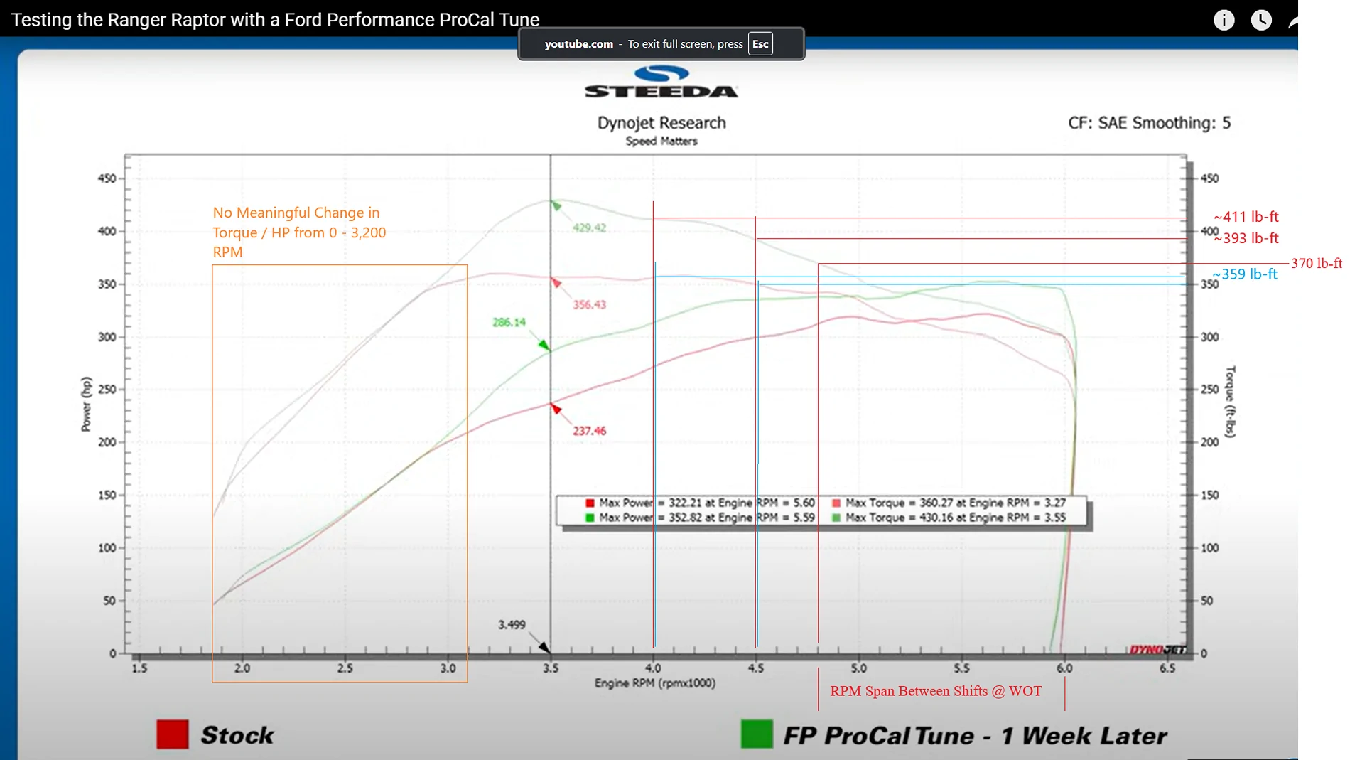

Ford Ranger Ford Procal Performance Tune Installed! RangerRaptorProCalDyno1WeekAdapt - Copy
Here's a mark-up of Steeda's Pro Cal tuned RR dyno (real numbers after LEARN). There's ~1,200 drop between gears (20% ratio spacing), so the Pro Cal tuned 3.0L is making around 370 lb-ft at the wheels @ ~5k RPM when it starts in the next higher gear.
14% drive train loss in 2WD nets us about 421.8 lb-ft at the crank (what the 10R60 sees). So, at WOT, gear after gear (not including the effects of gear reduction which helps durability more in lower gears), even going into 7th gear (1:1), that's about 70% of its rated max input of 600 lb-ft.
Lets' also not get into the internet conspiracy theory about nm.....I'll defer to the F-350 Power Stroke 6.7L HO on Ford's website. The HO 6.7L is rated for 1,200 lb-ft, says right on their site. If the 10R140 were 140 * 10nm, that's about 1,032 lb-ft....see the issue? Clearly it's in lb-ft, IF it even means that (which I'm not entirely convinced it has anything to do with input torque anyway).
For now, lets assume the 10R60 is 60 * 10 lb-ft, so 600 lb-ft just for the sake of argument. That's with an expected severe service life of 200,000 miles (severe service is worst case) which previously was listed at 150,000 miles for most vehicles in the user manuals maintenance (now has increased a bit) so long as the input torque doesn't exceed that rating. So yah, it will hold pending there's no assembly / mfg. defect.
What's the point of all this? Durability and performance. The torque at WOT is barely any more than stock, RPM has an outsized effect on power (torque pulses per minute), so small torque increases at higher RPM matter WAY MORE in terms of making power than large increases at low RPM and that's where the 3.0L truly lives at, WOT, high RPM. The larger turbo's and higher flow induction system cater to making power rather than low end torque like the 2.3L or 2.7L, which are more work / daily driver-oriented designs. The 3.0L is about performance and durability under sustained high RPM.
The 10R60 transmission isn't going to see much of a difference between the Pro Cal and stock cal since the output torque is within ~25 to ~30 lb-ft of each other in the power band and that's not even counting all the torque limiting and RPM sync that goes on between shifts. I really do not see a reason other than not maintaining your vehicle or using fuel below 91 RON that you would have any meaningful effect on longevity between a stock cal and pro cal, at least with the 10R60.
Maybe the Pro Cal could shorten the life of the turbo's a bit as your running more boost, which pushes them further out of the efficiency window (higher heat), but there not a lot of added boost, only a couple PSI, most of the power is coming through more aggressive timing from the higher base octane threshold. If you run into issues, it probably would have occurred bone stock too.
Based on all of the study I have done on ECU calibrations, what makes them reliable vs. unreliable, safety margines etc. I do not see a significant enough of a difference between the Pro Cal and stock Cal to expect a significant degradation in service life pending maintenance and good driving habits during warm-up, all of which I apply to my daily drivers too.
