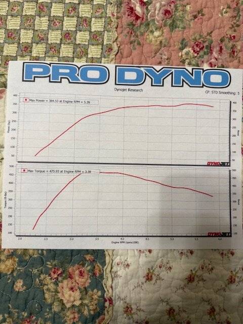

Had the FP tune installed many months ago.
It wakes up the truck, especially in Sport Mode.
I thought the R-Raptor ran good before but now it runs great.
I've just finished a period of around town driving totaling 1248 miles and the mileage shows 18.7. On the road highway mileage is 20.9 depending on traffic and how heavy the foot gets.
I think it was a very worthwhile upgrade.
See dyno sheet below that shows the rear wheel HP and Torque.
384.53 HP and 475.93 Torque. Between 3000 & 4000 rpm it's making a lot of torque for a stock (except for the tune) 3 liter TT motor.
I'm please with this tune, and hope everyone has the same results!
Pro Cal done at 5k miles done by dealer.
That dyno graph really shows why the truck picks up a solid 4-5 tenths minimum, sometimes a bit more. It's area under the curve and your gaining 70~80 hp in the mid-range, but it's holding strong all the way across the 4k to 6k RPM band. For those worried about the transmission, think about how the PCM shifts, it doesn't short shift, your torque at 5k RPM is way down compared to at 3,500. So, there's not going to be a huge difference in durability (that and they can torque limit while the torque locks are still slipping during the lockup process).
It think the internet hysteria about the 10R60's capabilities and the Pro Cal is full of actual false information (i.e., it's rated for only 600nm instead of ft-lbs like every other Ford transmission) and lack of context (i.e., locking up with 536 lb-ft input torque applied is different than being locked at 536 lb-ft, aka torque locks are no longer slipping). There's all kinds of things the engine / power train engineers can do to limit torque during lockup phase, then go full bore after lockup to keep things reliable.
Then they forget that you only make peak torque at WOT and when do you go WOT at 3,500 RPM and then short shift at 4,500 so your starting the next taller gear down at 3,500? Even if your cruising along, manually shift it so you're at 3,500, then got WOT and let the PCM continue the shifting, it is shifting at ~6k RPM or just a bit higher, so you're starting the next higher gear at about 5k rpm, meaning you're staying right in the meat of the power band all the time, not the torque band. You're "only" making around 400~450 lb-ft of torque in that RPM range, which is what the transmission sees.
That's one thing I do like about the 10 speeds, those short ratios make the truck's acceleration feel more linear vs. a 4 speed with dual over drive (aka 6 speed), where it's built up (getting close to fun), power band (fun), next gear, bogged down (boring), build up (getting close to fun), power band (fun), bogged down (boring), repeat. It's just on gear after gear in the RR and torque more slowly tapers off, so it's more responsive overall.
