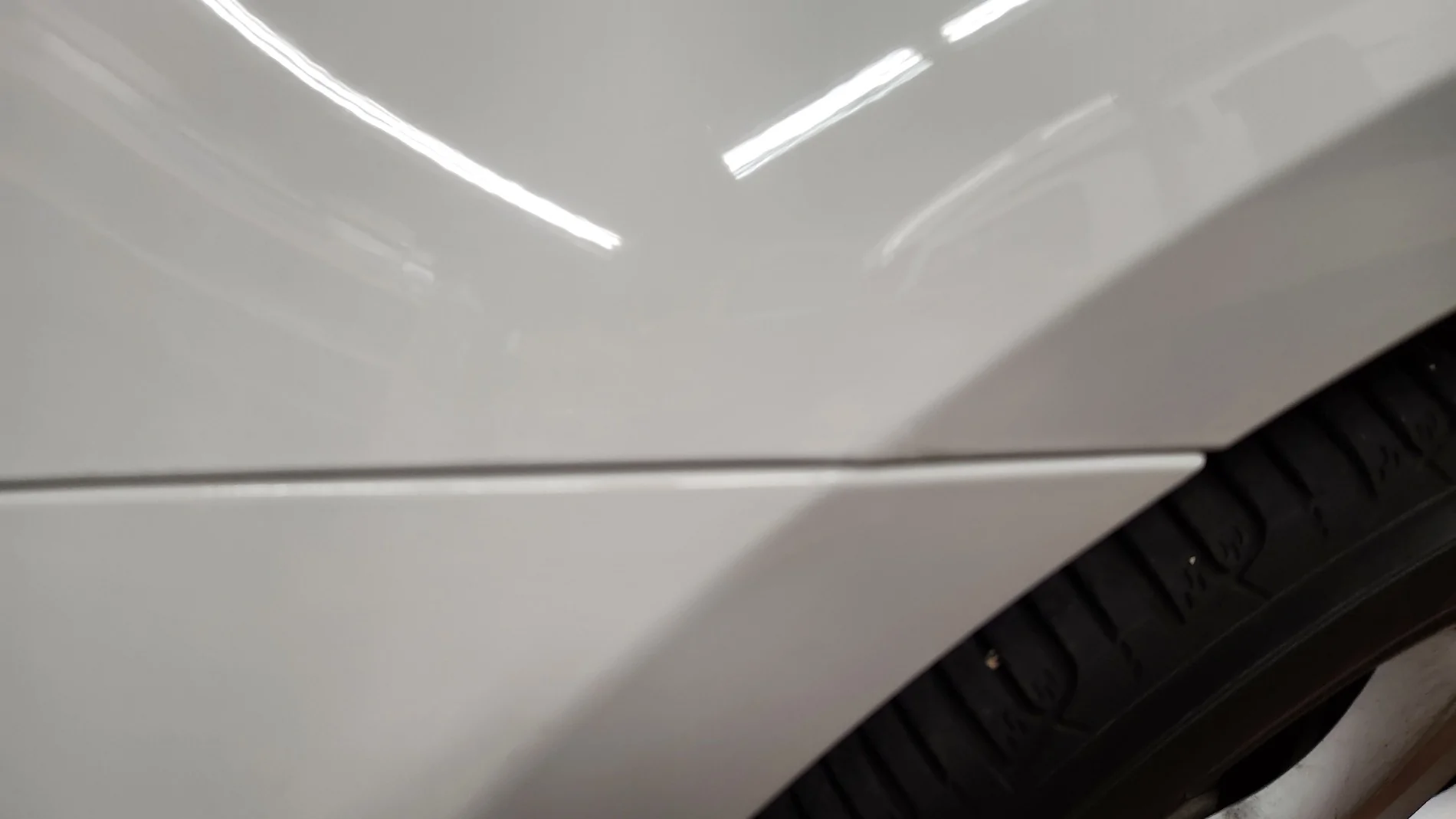

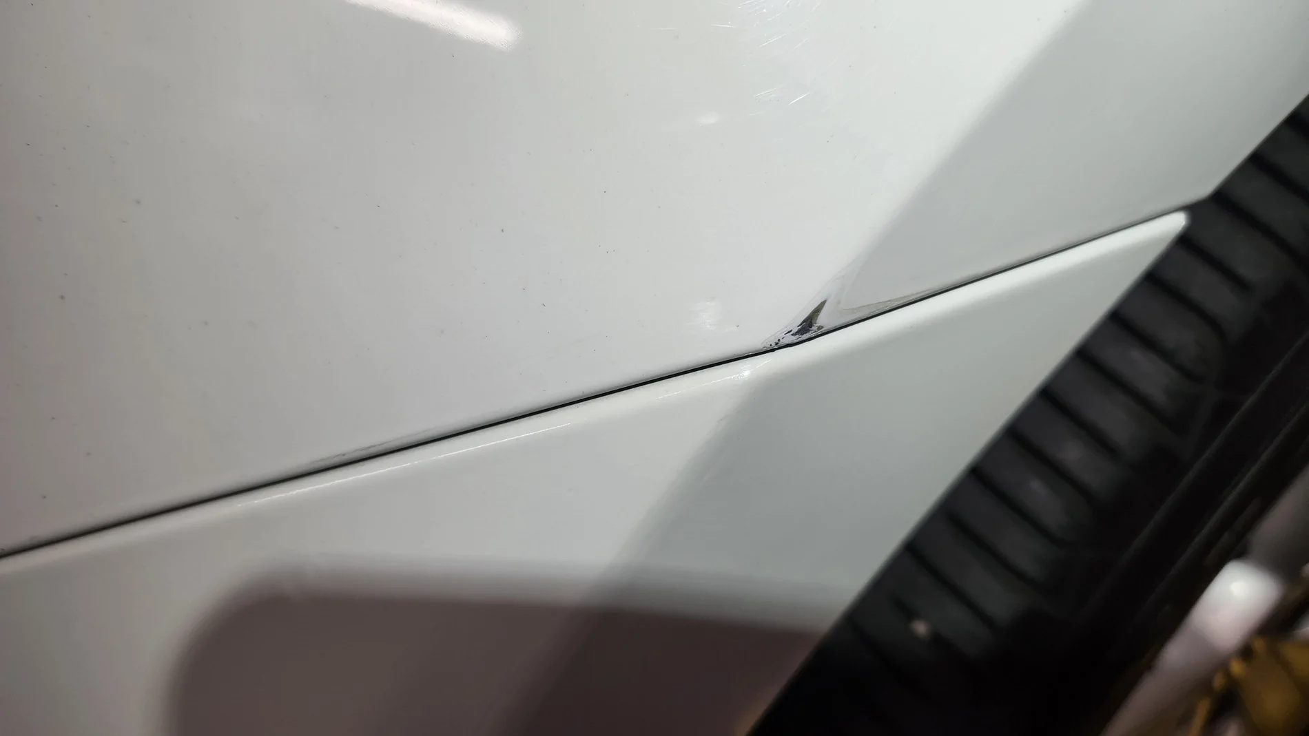

Here are the results of the door dings on the side of my TDI. They were very difficult as not only were they were on a horizontal surface but they were right on a raised crease. I worked on them off and on for 2 days until I was finally satisfied. I had to keep applying paint and shaping it with bits of 2000 and 3000 stuck to my fingertip. I used a super magnifier with a jeweler's eye loupe and a bright headlamp. When it came time to buff the area I applied a piece of pinstripe tape so the buffer wouldn't burn thru on the crease, then at the end I removed the tape and carefully and briefly buffed over the crease. They are not perfect but you cannot find them unless you know exactly where they are, they are nearly invisible without magnification.
I'd say they were about 6 times harder than the hood chips.
Here they are before I started, zoomed in and zoomed out. You can see there was a pitiful attempt at fixing them at an earlier date. There is also paint damage between them which I was able to completely sand out.

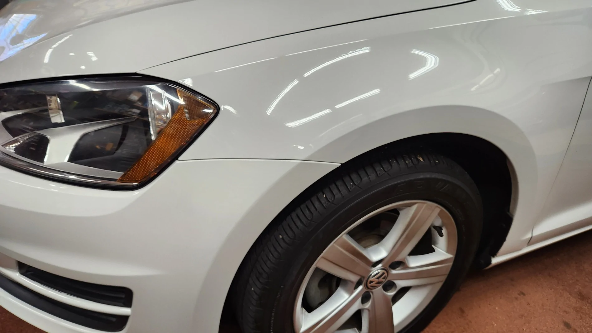

As promised I started practicing on my VW TDI which I am detailing in order to sell. Between yesterday and today I took care of about a dozen very small rock chips on the hood and a chip on a fender. The hood chips were all very small as in 1/8" or less and the fender damage was about 1/4". I decided not to try the product in the first video I posted because it just didn't look that great of an option, even in the video he didn't bother to show the final results which tells me they weren't that good.

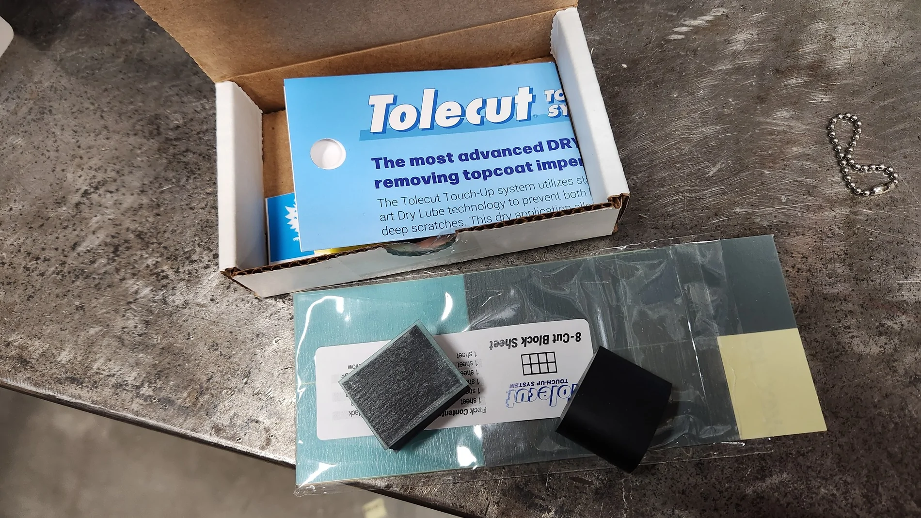

Once you have enough color in the chip to hide all the damage, and after it dries, lightly sand it, clean it again then apply your clear. The clear you want to fill in so it is slightly proud of the surface, this is so you can sand the clear flat without sanding your color out. This will make the repair disappear. When you have enough clear on (I waited 15 min between dabs) wait overnight. The next day, sand the clear flat starting with 2000 and finishing with 3000. Make sure to sand a little wider area with the 3000 to be sure you remove all the 2000 scratches. I used the Eagle Abrasives Tolecut kit which makes it very easy, and their abrasives are meant to be used dry which means you can watch your progress easily without constantly wiping the water away. Again, magnifiers and a headlamp help a lot. Keep compressed air and a rag with solvent handy to keep the little abrasive pad clean as it loads up. I will put a picture of the kit below.

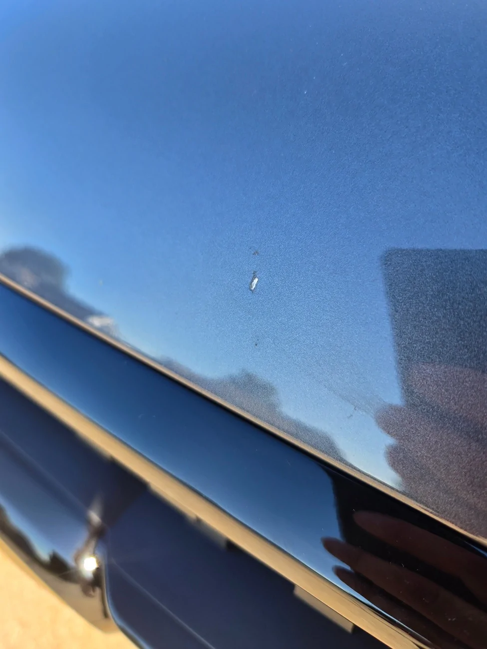

First is 2 small rock chips on the hood. This is what it looks like when you haven't sanded enough. I laid a flashlight on the hood to make it easier to see the raised bumps, which will be highly visible if you don't keep sanding. The bumps are clear coat, the color is below.
