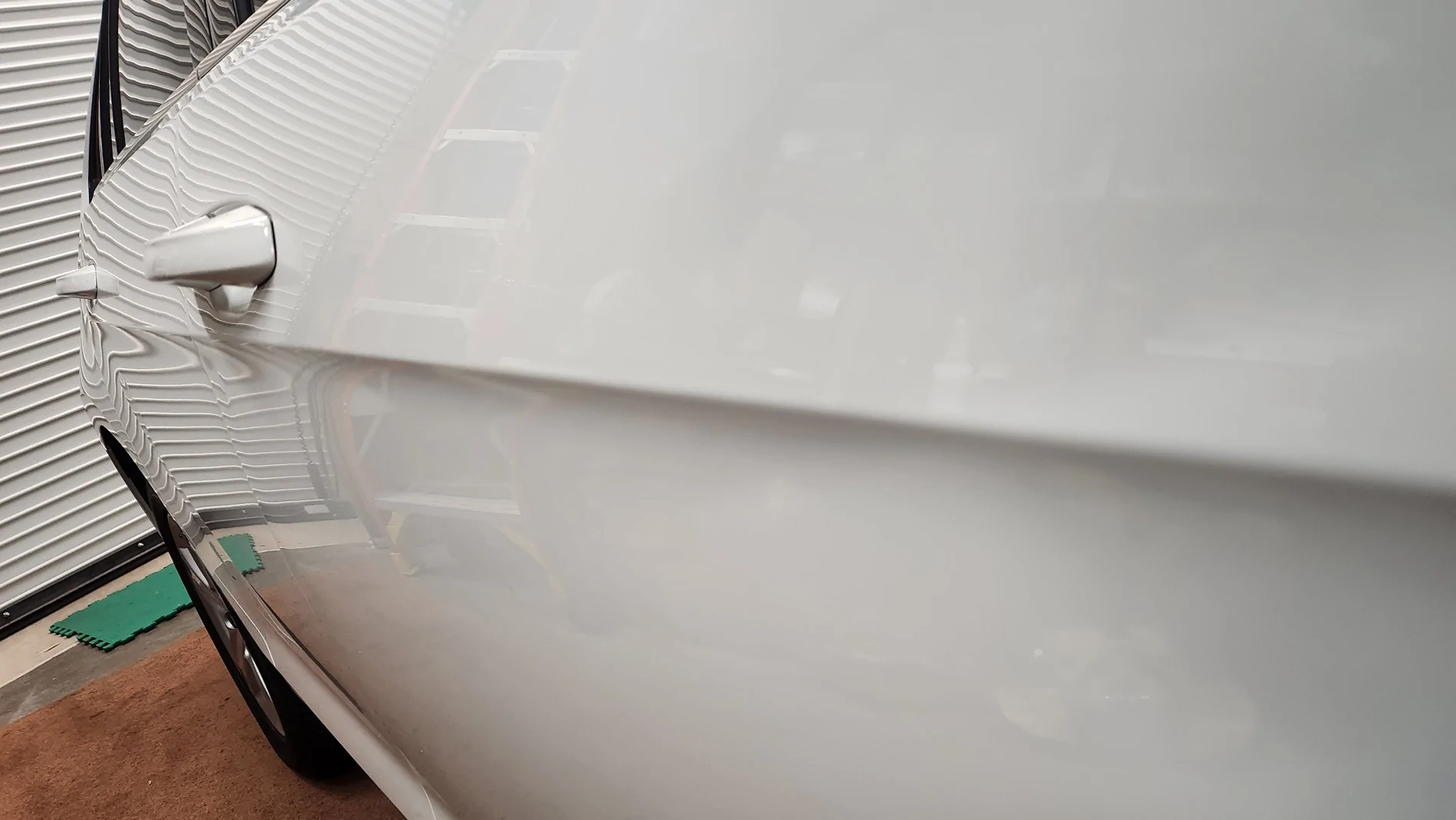

Here are the results of the door dings on the side of my TDI. They were very difficult as not only were they were on a horizontal surface but they were right on a raised crease. I worked on them off and on for 2 days until I was finally satisfied. I had to keep applying paint and shaping it with bits of 2000 and 3000 stuck to my fingertip. I used a super magnifier with a jeweler's eye loupe and a bright headlamp. When it came time to buff the area I applied a piece of pinstripe tape so the buffer wouldn't burn thru on the crease, then at the end I removed the tape and carefully and briefly buffed over the crease. They are not perfect but you cannot find them unless you know exactly where they are, they are nearly invisible without magnification.
I'd say they were about 6 times harder than the hood chips.

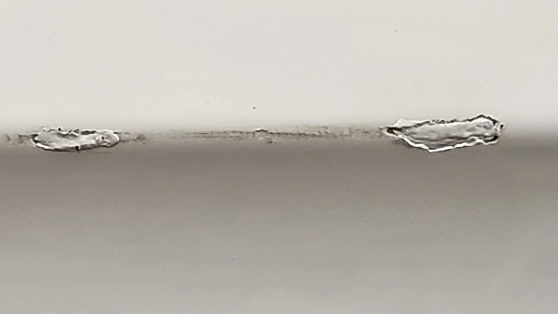

Here they are before I started, zoomed in and zoomed out. You can see there was a pitiful attempt at fixing them at an earlier date. There is also paint damage between them which I was able to completely sand out.

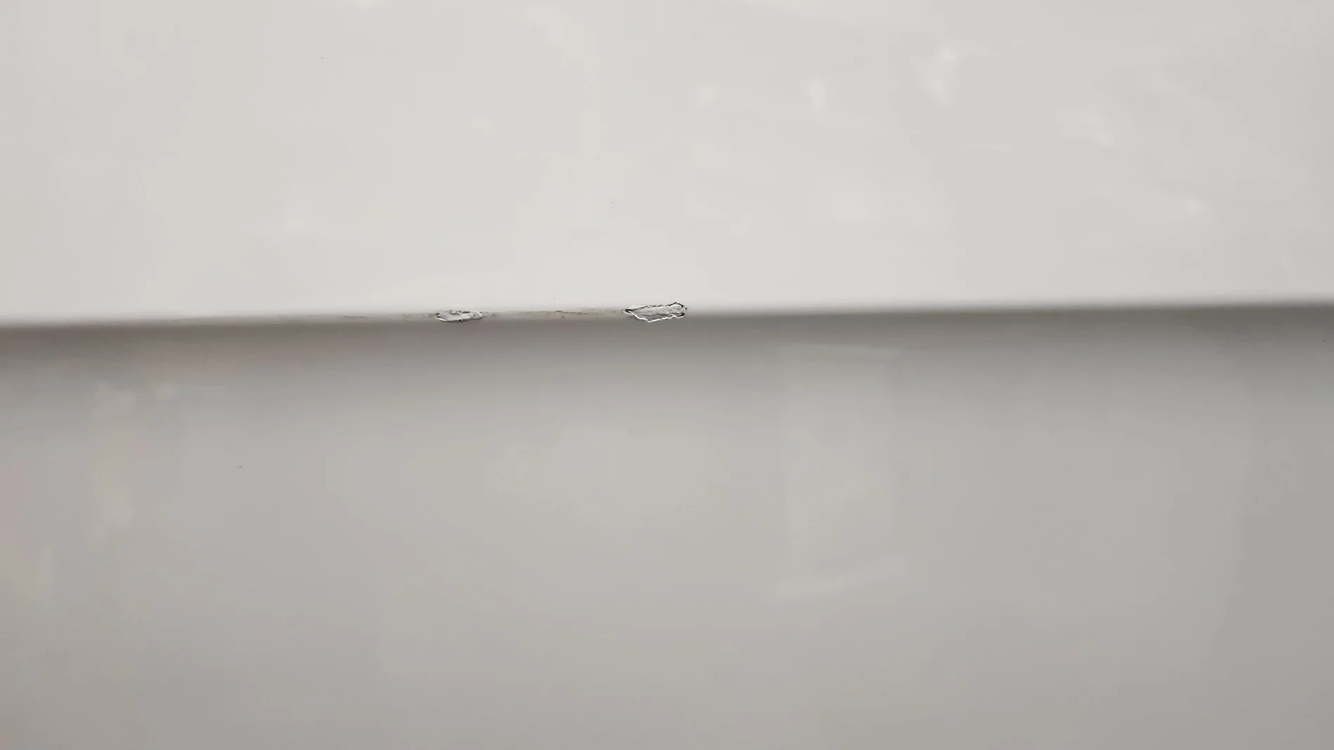

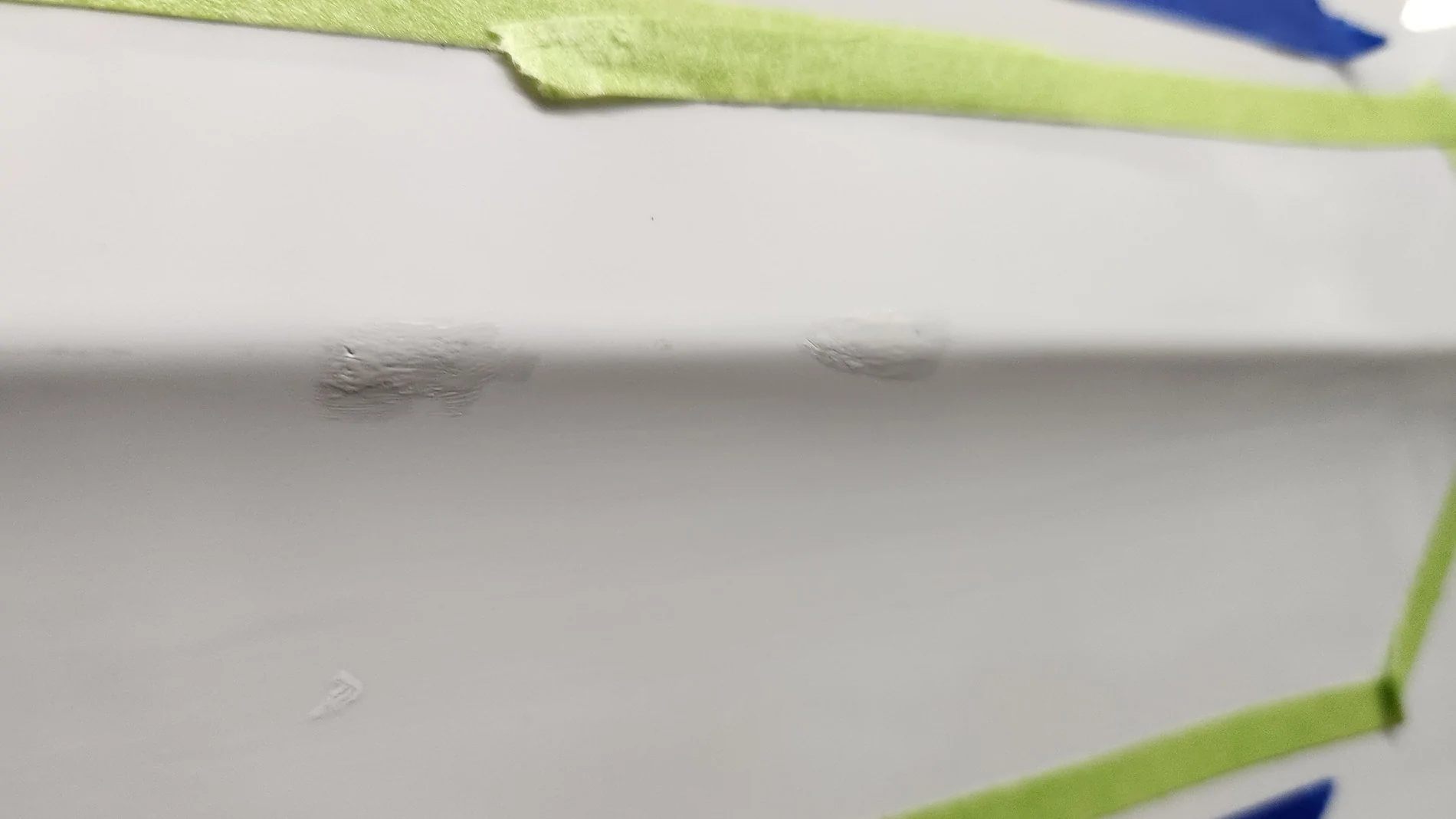

After cleaning, sanding and cleaning again I did several buildups, sanding each one.
Ford Ranger Go to touch up paint brand/kit? built u
Making progress
Ford Ranger Go to touch up paint brand/kit? progress

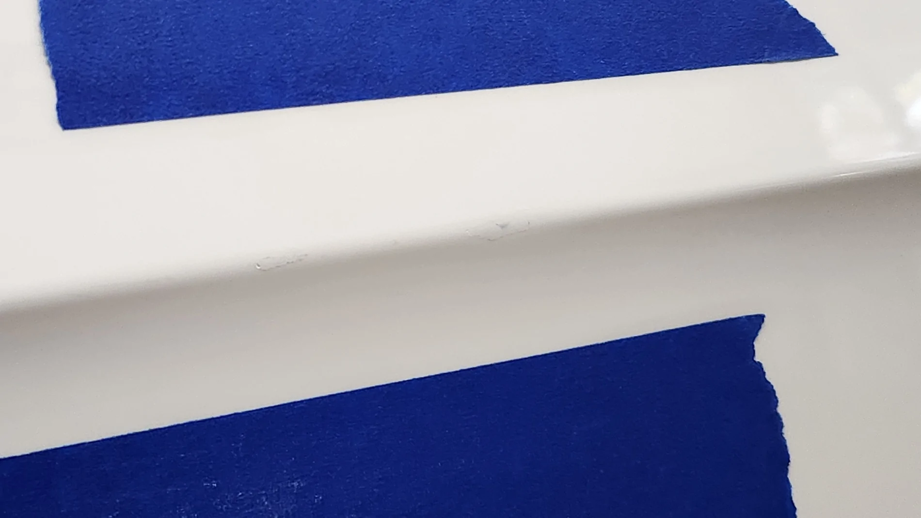

This is where I decided it was good enough. This is magnified 3X. You can still see the edges outlined, maybe I could have sanded further out initially.
Ford Ranger Go to touch up paint brand/kit? repair magnafied

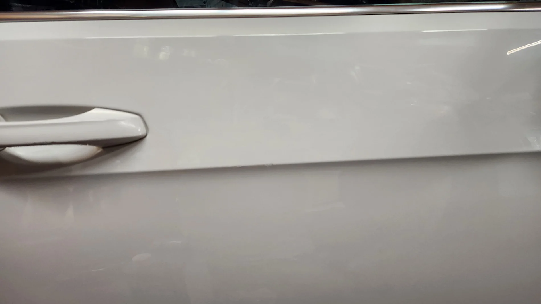

You can't really see them at normal magnification unless you bend down and look real close
Ford Ranger Go to touch up paint brand/kit? finished

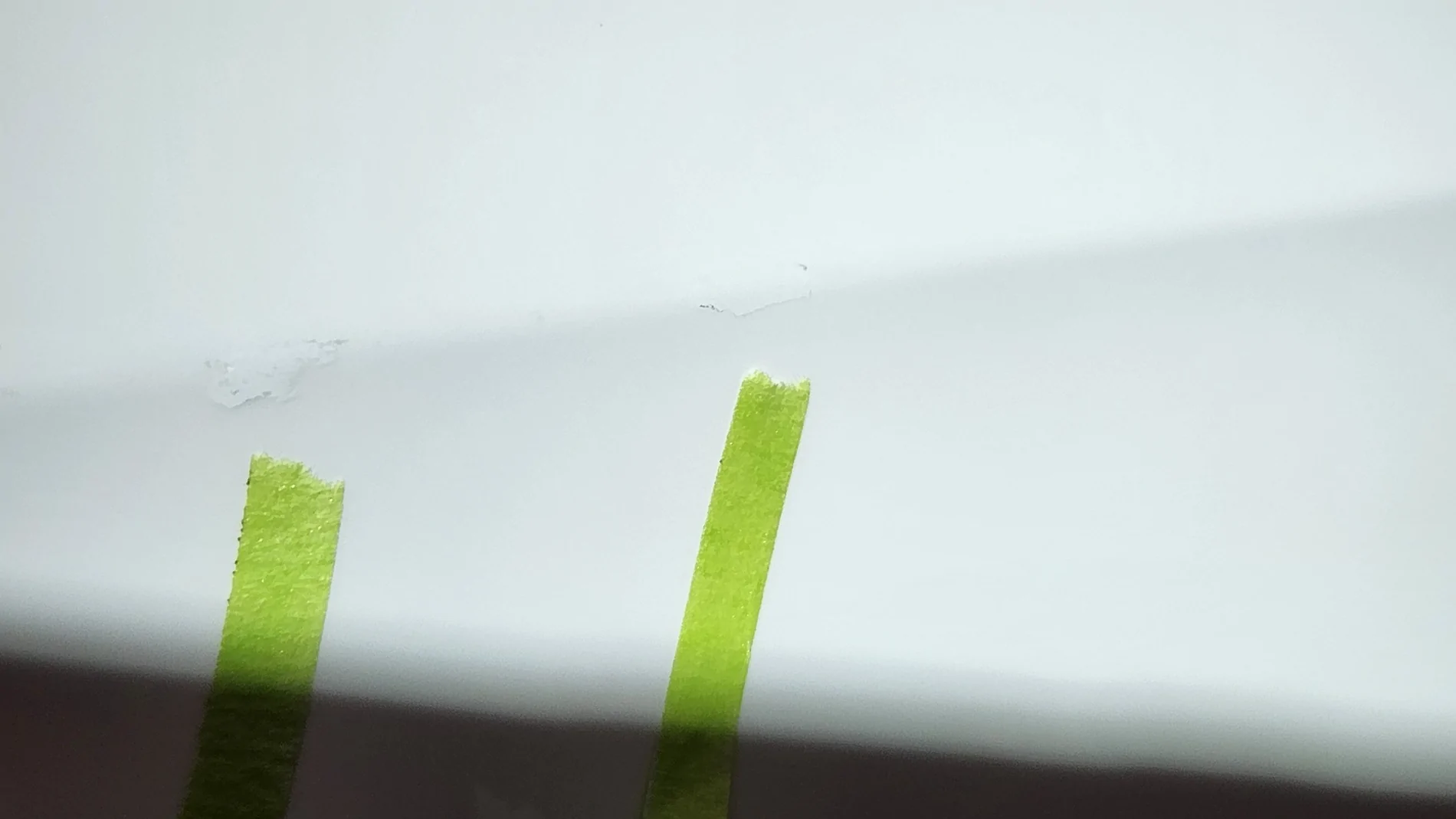

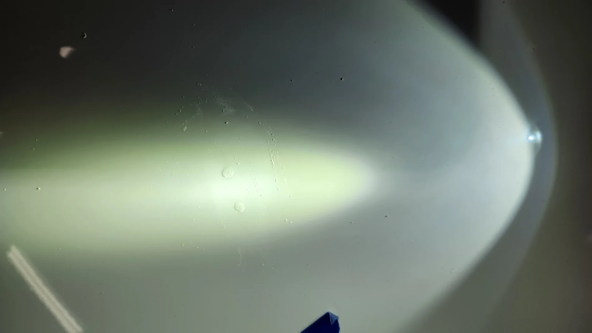

First is 2 small rock chips on the hood. This is what it looks like when you haven't sanded enough. I laid a flashlight on the hood to make it easier to see the raised bumps, which will be highly visible if you don't keep sanding. The bumps are clear coat, the color is below.

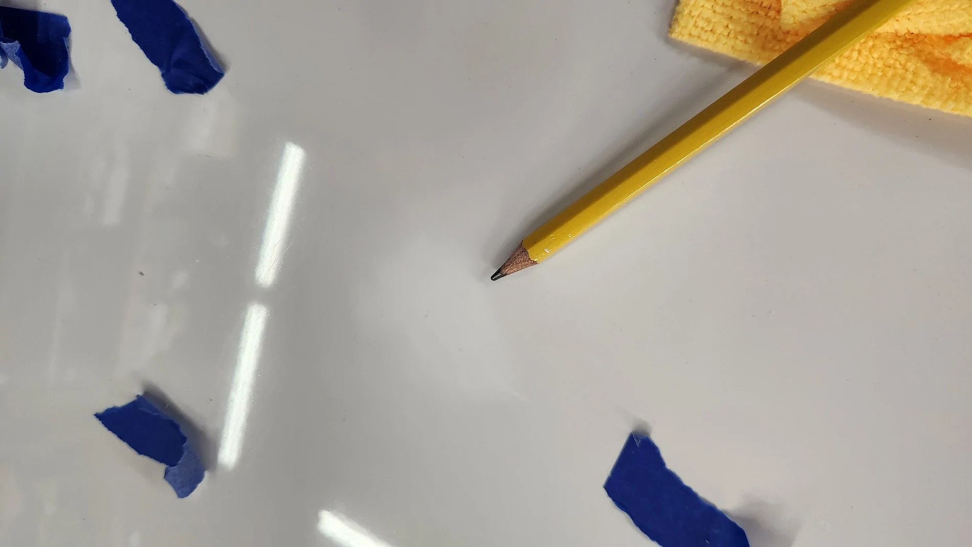

Below is after the raised bumps were sanded completely flat and all that is left are 3000 grit sand scratches where the pencil is pointing. The repair has disappeared. The sanding was all in the clear coat which protected the color from being sanded out.

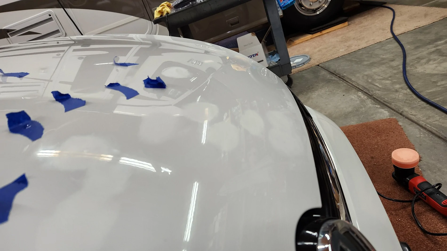

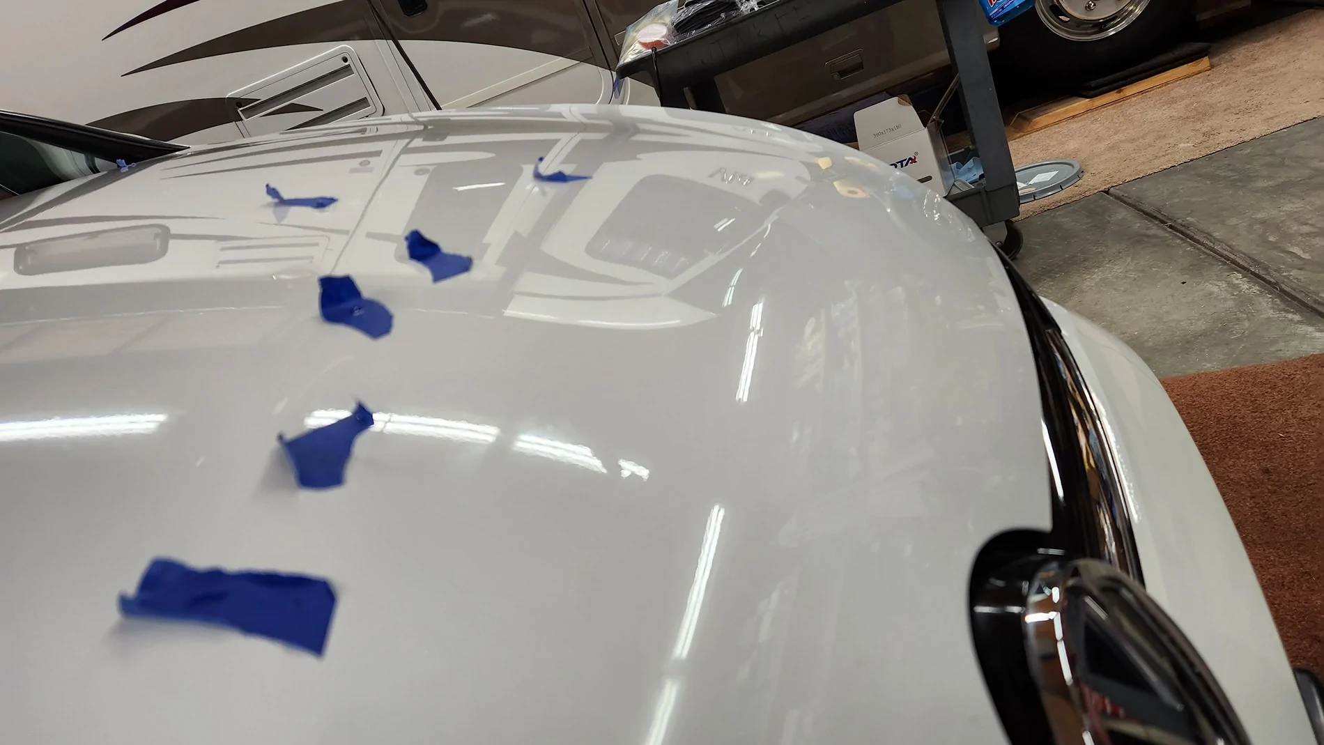

Below are all the rock chips I fixed, before I buffed out the 3000 marks. The tape helps keep track of where you are working especially as the chips begin to disappear.
Below is after compounding and polishing, the repairs are invisible. Keep in mind, with white it is easier to make repairs disappear. White also lasts longer in the sun and is cooler here in the desert which is why I always buy white cars.
