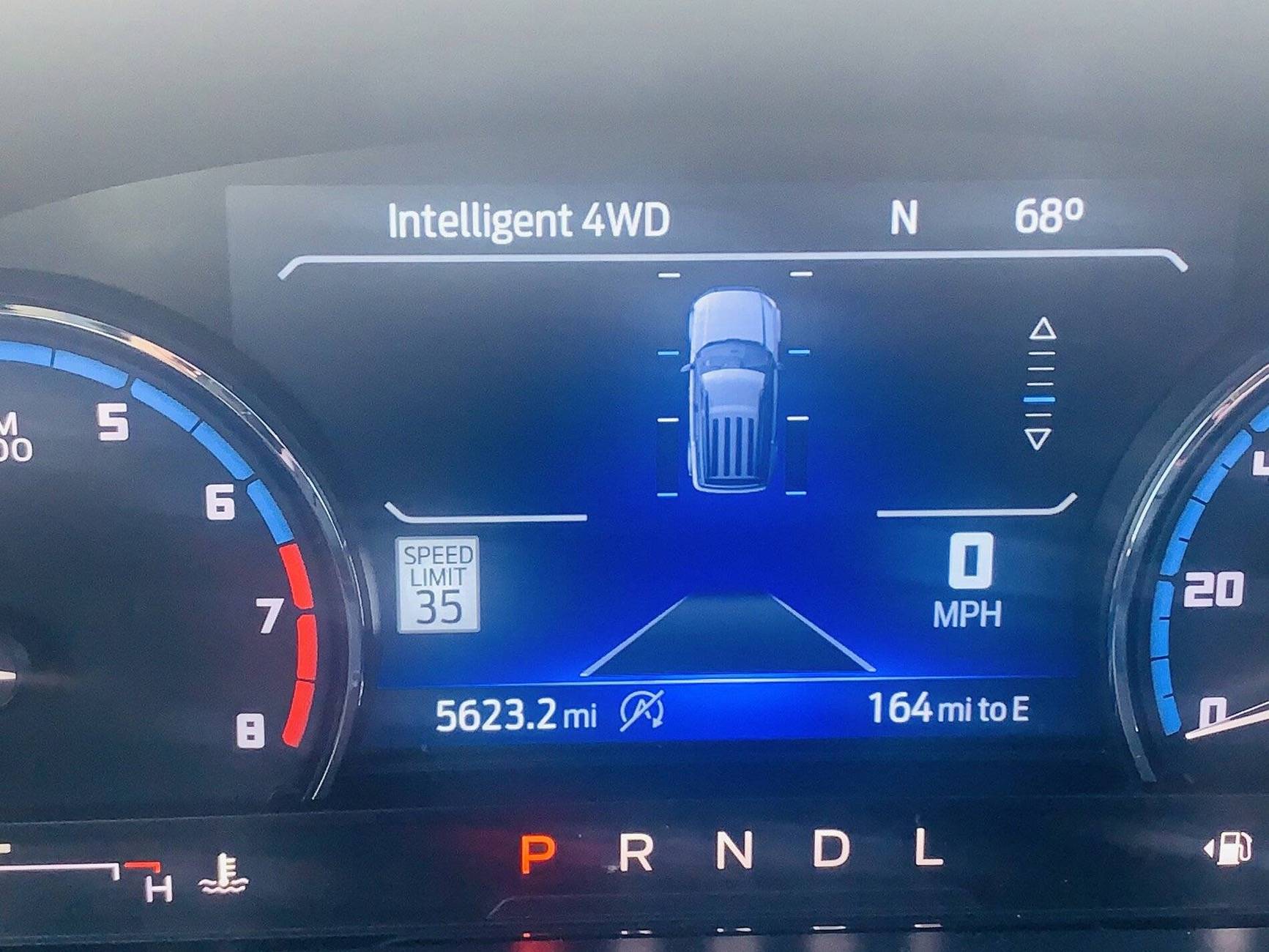

I’ve noticed in Australia reviews of Ford Ranger that they have an Intelligent 4wd view in cluster that visualizes which wheel power is being sent to. I have this exact gauge in my Bronco Sport and it’s an interesting view to see when that car switches between fwd and awd depending on conditions and rate of acceleration.
I would love to have this view in my US spec RR but don’t see it as an option. Anyone see this as something one could add with Forescan?

That gauge is slightly different (at least to my understanding). When you are in 4A, it shows (always) power distributed to front. However, it doesn’t actually show specifically when front wheels are activated/driving, usually in acceleration, coming out of corners, etc. otherwise 4A is just using 2wd, but that gauge doesn’t show that nuance.
the other gauge has a bar chart showing specifically how hard wheel is being used in realtime.

Any Global RR owners on here that could confirm or deny having this gauge in your vehicle? The '25 Ranger Tremor in Aus has 4A, the exact same one has RR, and has this gauge based on screenshot. It would be odd that Ford decided it worked for one market with this system and not another.

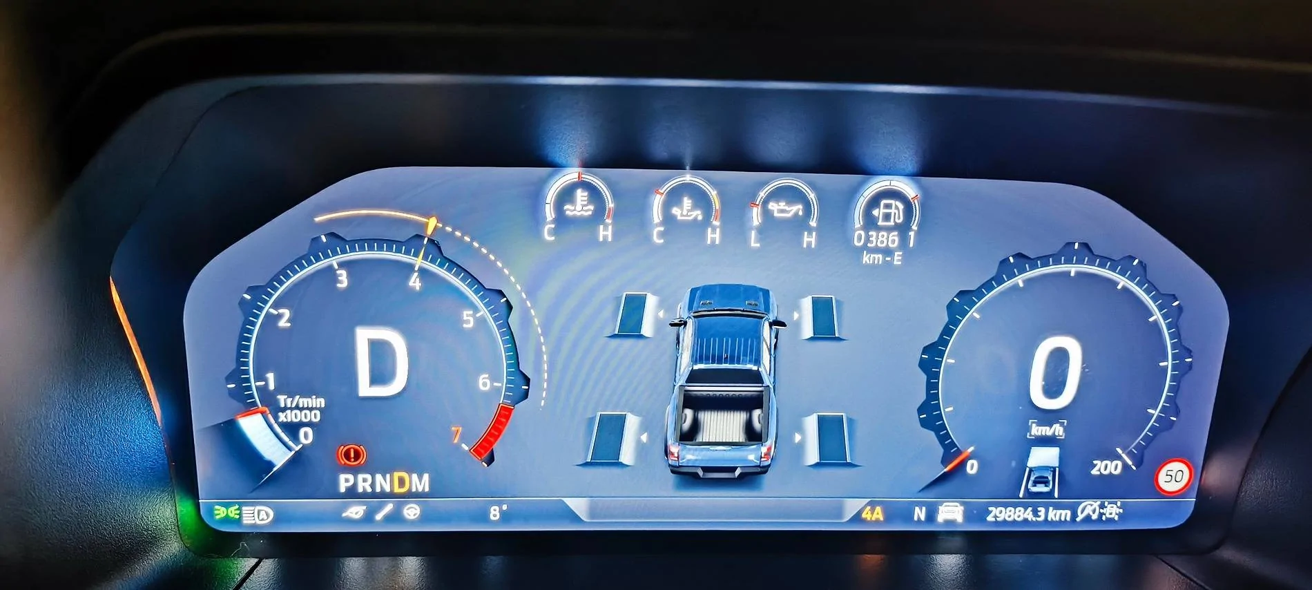

That’s not how it works on mine. It shows in 4A the variations between rear wheel drive and four wheel drive. And it is never only front, it is only rear on highway and such but anytime you press hard on accelerator it goes to front too showing how 4A really works
Agreed. I have a Ranger Raptor and had to turn on Power Delivery Gauge in Cluster (under IPC) using FORScan. Once I did that, I essentially got the same view as in your second post @Ranger43931 (the one from CarExpert) and while in 4A it shows when power is delivered to both the front and rear wheels (using and increasing/decreasing bar chart representation for each wheel) as well as when it's only the rear wheels with power.
Typically, when taking off or accelerating, the gauge shows 4A using all four wheels, and under highway speeds the gauge shows only the rear wheels in use, unless you're accelerating hard, in which case all four wheels have power to them.
FORScan will be the answer to your question.

My ranger is EU wildtrak V6 is a first release (2023), and the gauge works like that since it got delivered, I did not touch forescan. Interesting!

This is how it is on my European raptor.
I had to activate it in the IPC with forscan.
In 4A it lights up for the rear wheels and just after front + rear.
