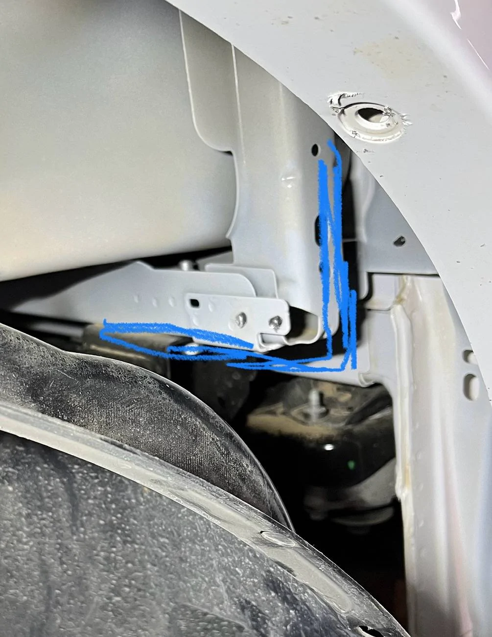

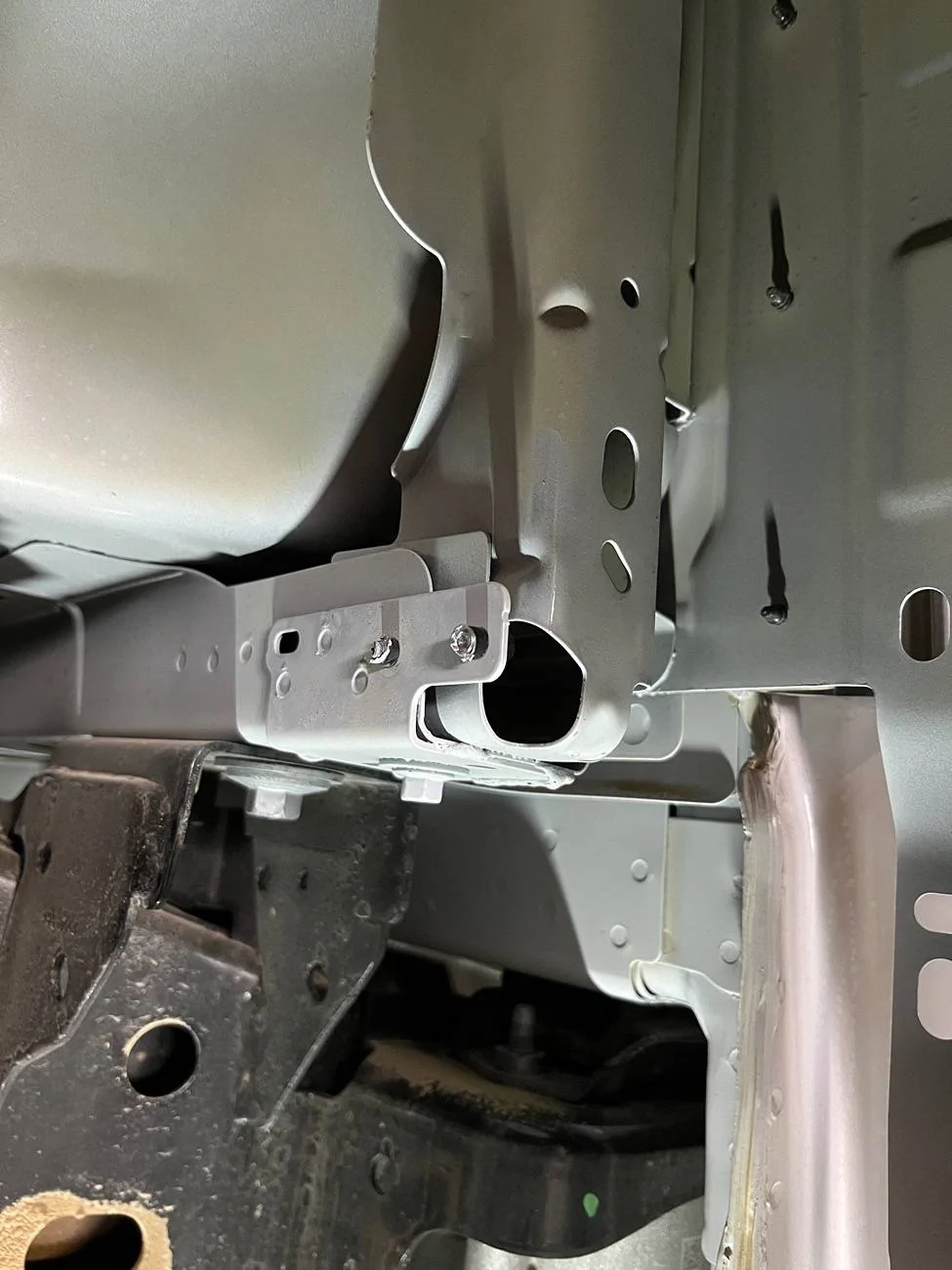

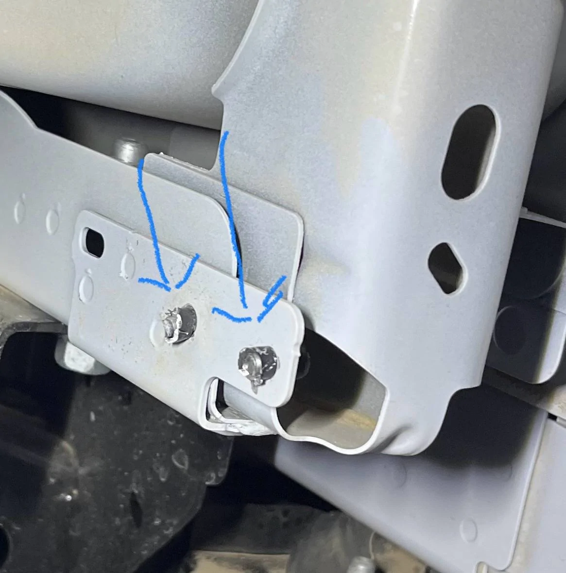

I started installing the J-Braces on the passenger side and have gotten to the point where I can see where they bolt on. I can say that this is no job that can be done easily, it will make you cuss. The instructions call for drilling out the two pop rivets but as you can see in the pictures I failed on that step so now have to find a way to remove what remains of the pop rivets and suspect a saber saw may be the solution. Cutting the metal at the corner to allow sliding of the backing plate up inside the vertical channel and bolting the J-Brace in place I can handle but getting to this point wasn’t fun.
Ford Ranger J-Brace Installation, Yikes IMG_6694
Ford Ranger J-Brace Installation, Yikes IMG_6692
Ford Ranger J-Brace Installation, Yikes IMG_6688

I would hold off using any kind of saw as that tends to open things up to corrosion.
When you're done, spray it with silver Rust-Oleum. The light color makes it easier to see any problems.
Places you get rust, use a paint brush and lightly cover it with OSPHO. Let it sit over night then rinse it off, dry it, and apply paint.
OSPHO kills surface rust.
I've used OSPHO on fishing boats, and keep a bottle in my garage. Keep it out if reach of children and pets.
