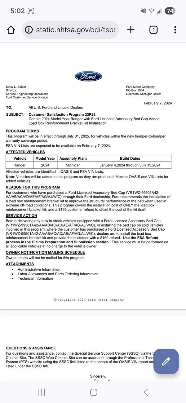

When my service was finished yesterday, the Service Tech told me the support failed and they would order the parts and repair my truck which would be covered by the recall. When I post the copy of my service order you will see that it is covered under a recall.

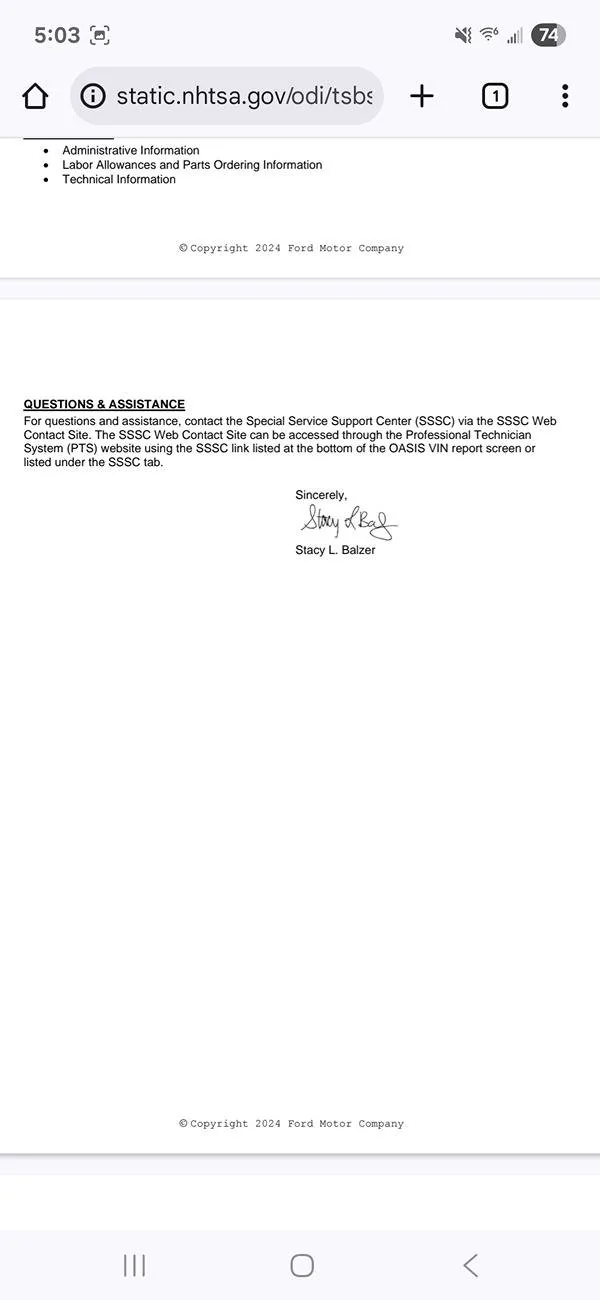

It looks like this was a customer satisfaction program 23P22. It says it ends 7/31/25. It says it covers installation for trucks that purchased ford accessory bed cap. I don't know if trucks without that will be covered, I guess they won't. I'm going to call my dealer Monday. Look up the CSP and read it.

It wasn't a recall. It was only a CSP. Look up CSP 23P22. It even says customers won't be notified by mail.

Just spoke to service rep from my dealer. He said the free j-brace install is only for people who purchased a Ford accessory bed cap. Since I don't have one I don't qualify for the brace install.
This only applies to people who purchased " a Ford Licensed Accessory Bed Cap (VR1WZ-99501A42AA/AB/AC/AD/AE/AF/AG/AJ/W/C) through their Ford dealership"
this does not apply to everyone

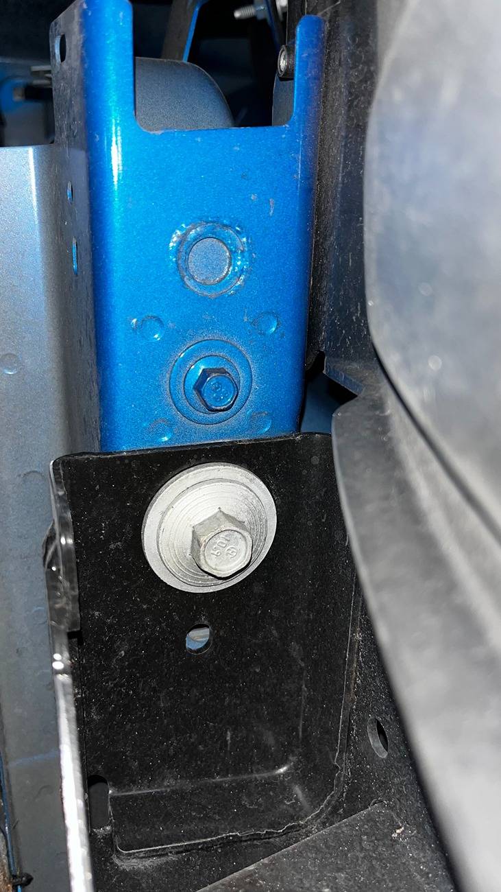

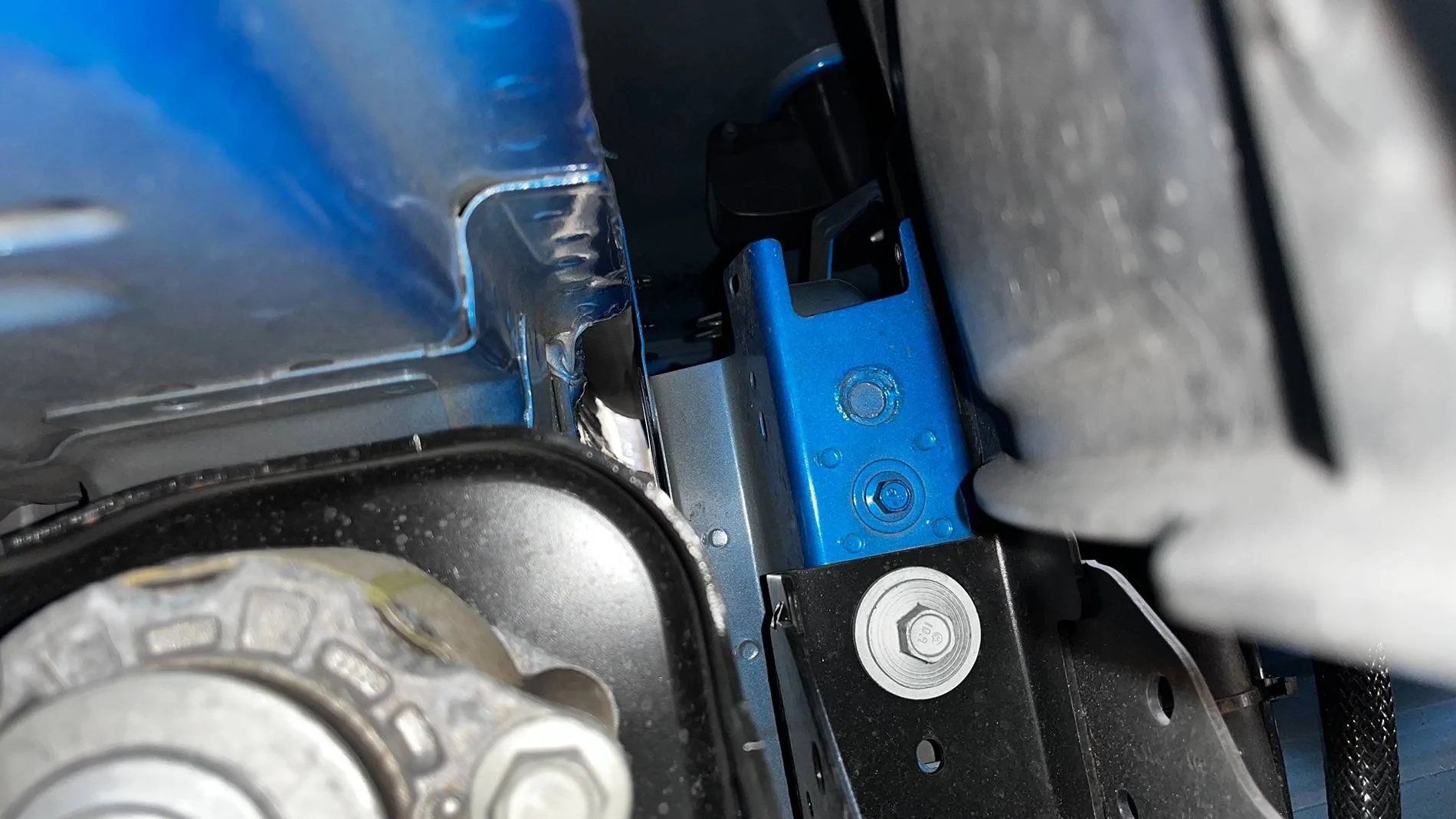

What do they look like? I'd like to check to see if mine has them already. Recall site says I have no recalls available.

Goober71, Ranger43931 posted pictures of the old support vs the updated support so you can do a visual check.
Thanks Massman. I checked that post and the diagram attached. I think I have the newer structure (rounded corners) so I'm good. Actually crawled underneath the truck and took pics (attached).
