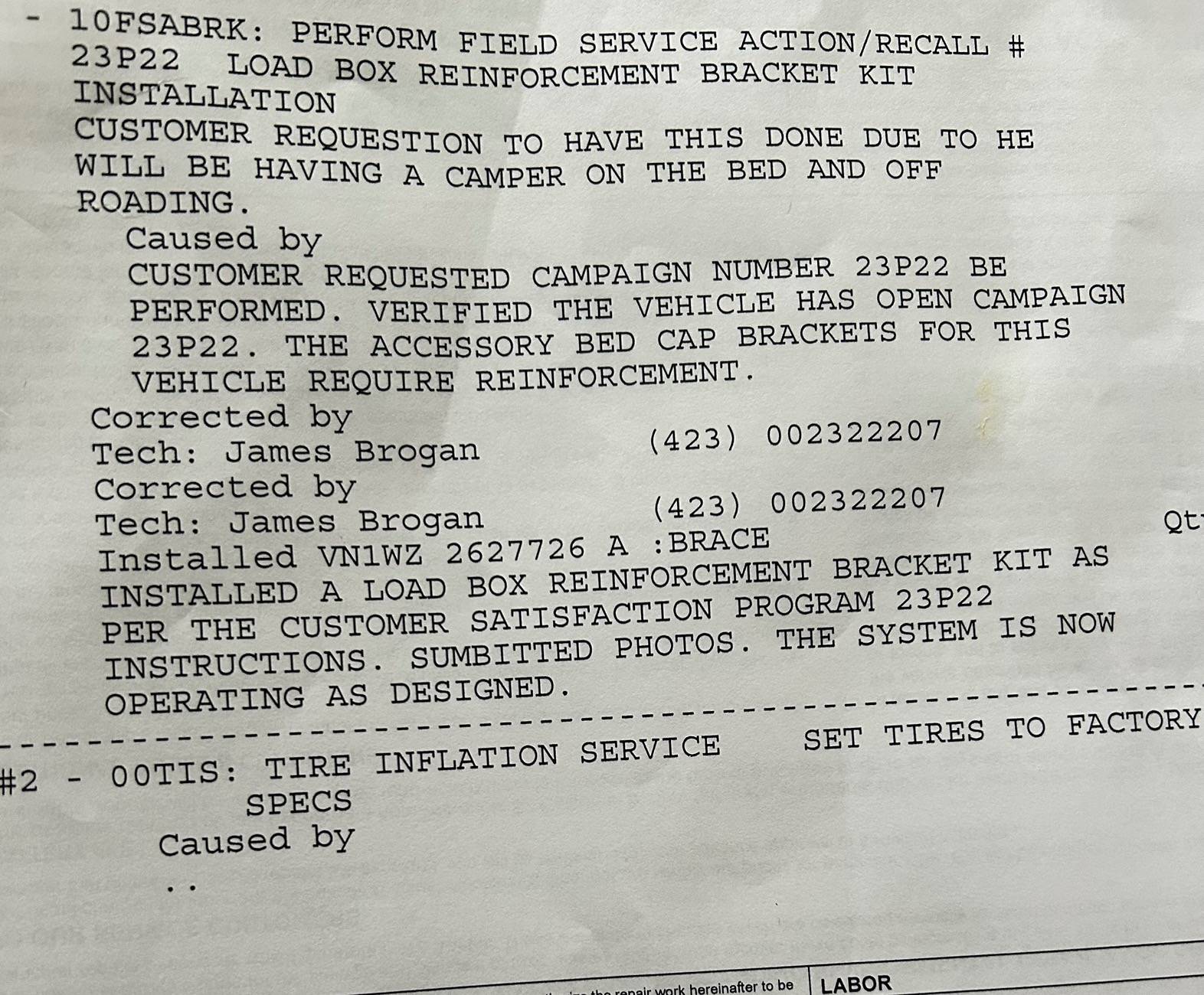

Ford classified mine as "field service action/recall. See below.
Ford Ranger J-Braces IMG_1817

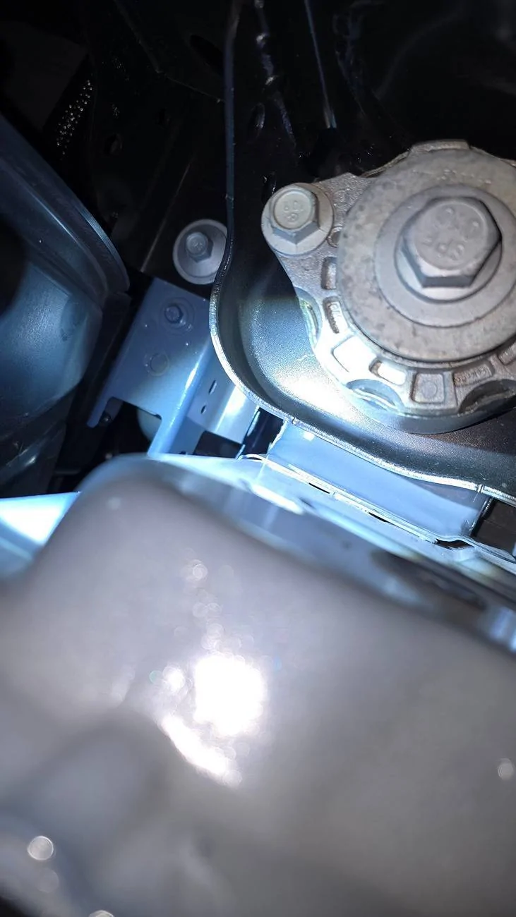

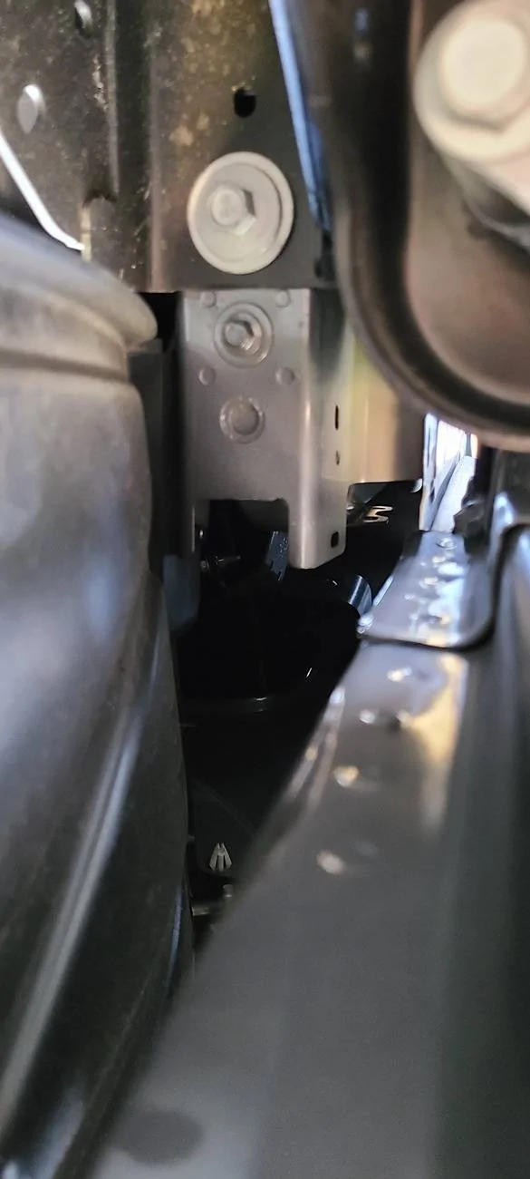

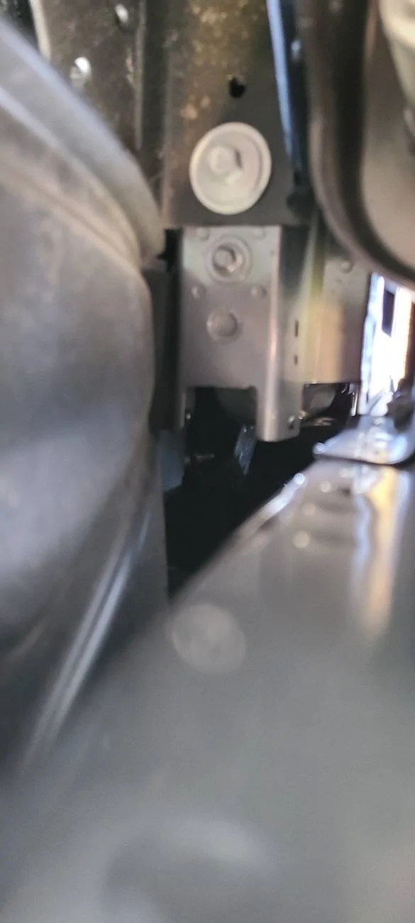

The guys say mine has the updated bed
Ford Ranger J-Braces 20250217_133630
Ford Ranger J-Braces 20250217_133621
Thats laying in front of the wheels and looking up

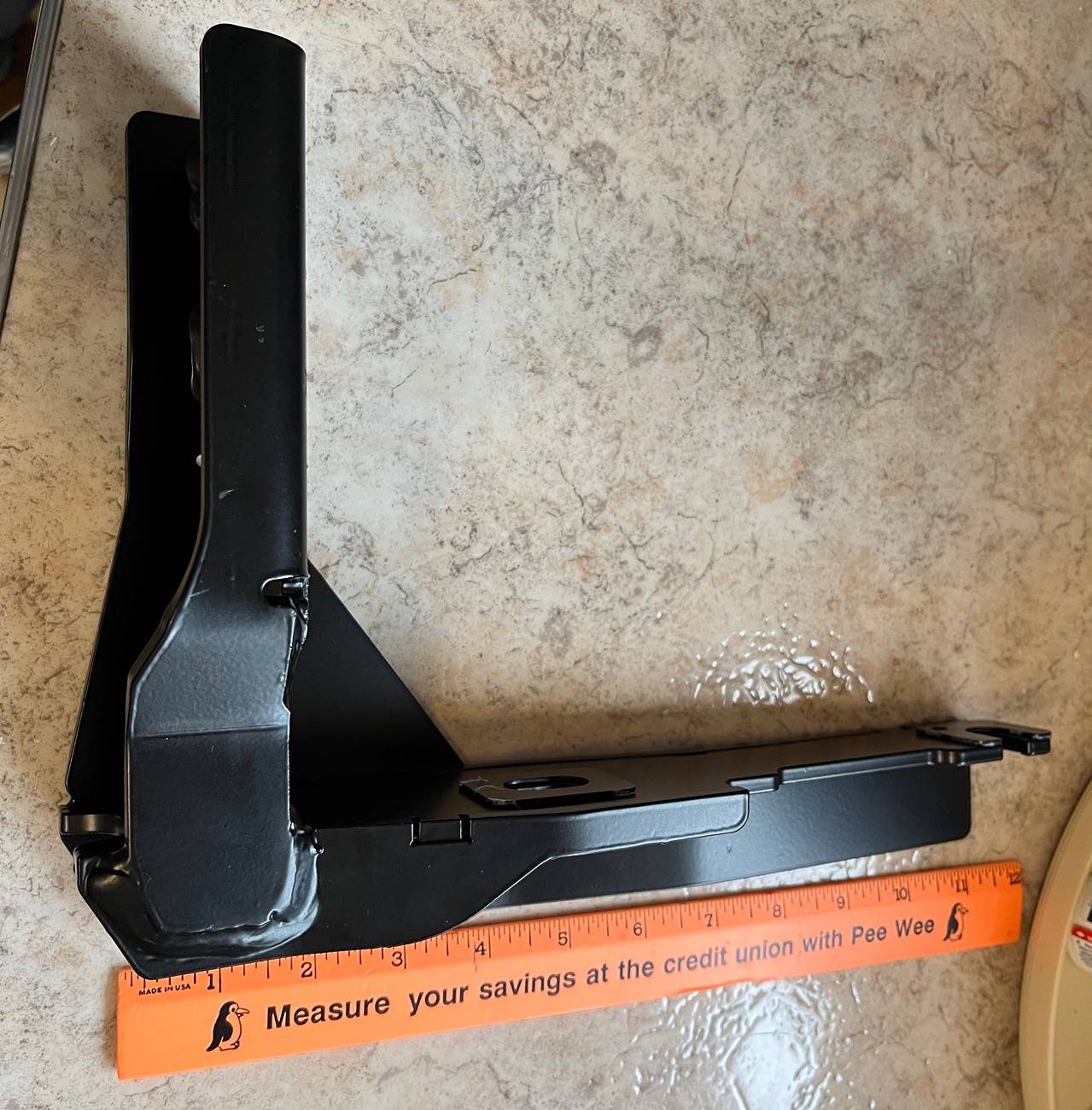

The J-Braces to stiffen the front corners of the box are some pretty substantial pieces of iron, am guessing they weigh 3 to 4 lbs each. After reading the instructions it looks like this is not going to be an easy project. Installing the J-Braces themselves shouldn't be hard but removing the wheel well liners and reinstalling looks to be the hardest part as it requires a rivetnut tool and drilling out rivets. Am going to do it but not looking forward to it. The Lariat has not arrived yet, it's on the rail somewhere.
I attached this earlier. Maybe in another thread. I addressed this issue with my new xlt fx4 purchased two weeks ago. My Ford dealer inspected the vehicle and acknowledged it needed J braces. (Not all 2024 models need them). The installed at no cost.

You Do have the updated bed.
I’m new to the forum and new to Ranger ownership (picked up my Lariat 2.7 last week which door jam says was manufactured 10/24). I was aware of potential carry issue, asked at time of sale and my dealer said they knew nothing and there were no open recalls on my truck. I just crawled under, looked up at spot indicated in photo preceding and see the same bed bolts so believe I’m good. Thanks for posting information. I’ve learned a lot about my truck before and after purchase reading everyone’s contributions. I was on the fence about trading my ‘21 Tundra but convinced myself the new Ranger, especially with the 2.7 could handle my TT and would be a much better daily driver. Love it so far, especially fun in sport mode but mostly drive eco as live in VT so are top speed limited to 50 mph when we occasionally find macadam
