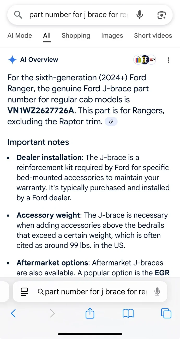

does anybody know the part number for the j braces for a regular ranger, not the raptor. Thanks.

Thank you. Couldnt find them in the accessory store, hoping I can find them under parts.

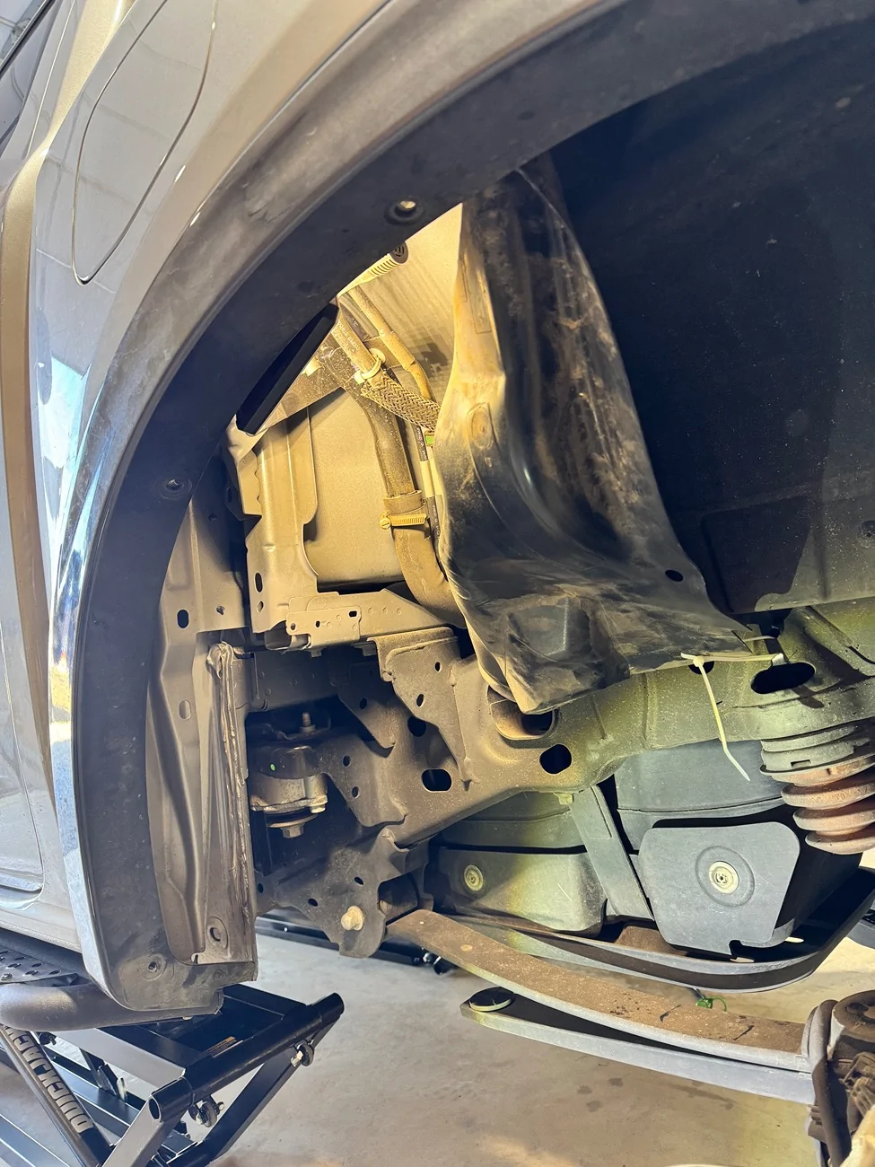

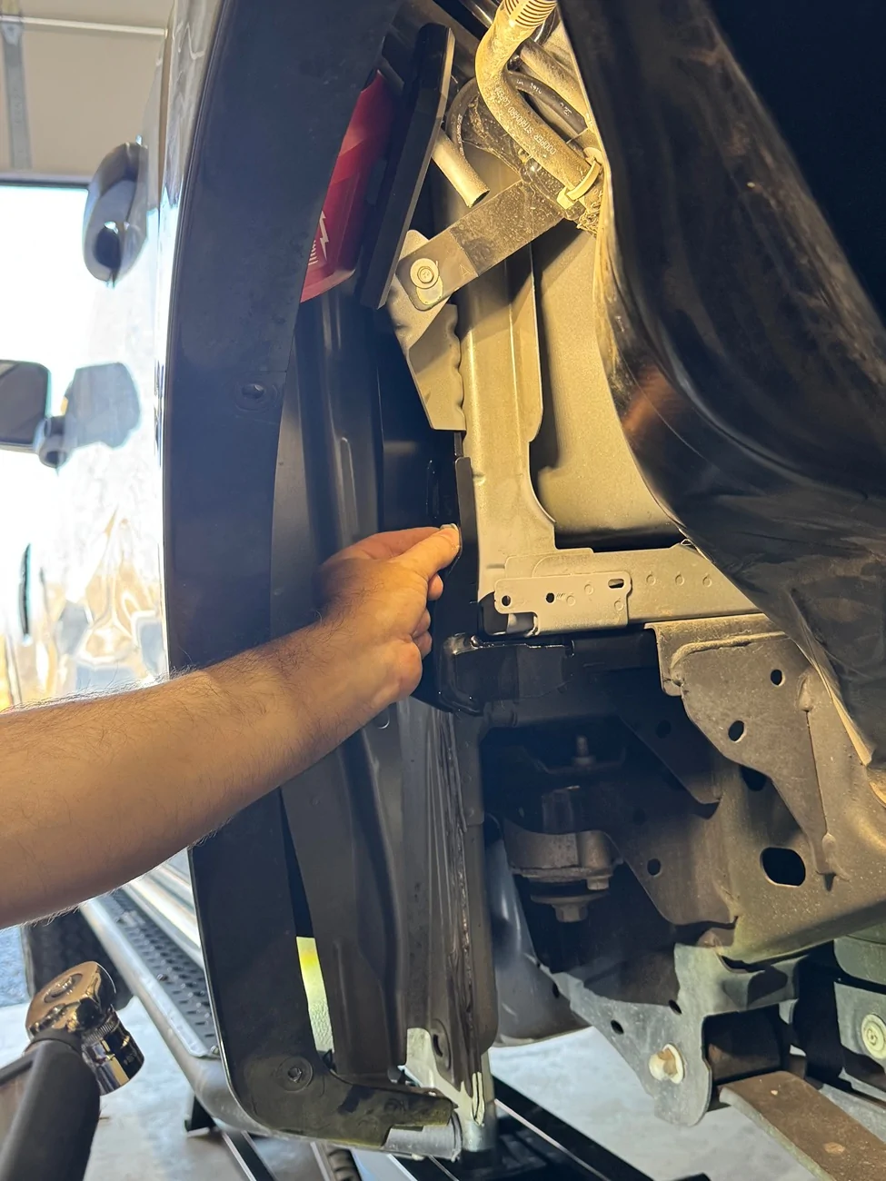

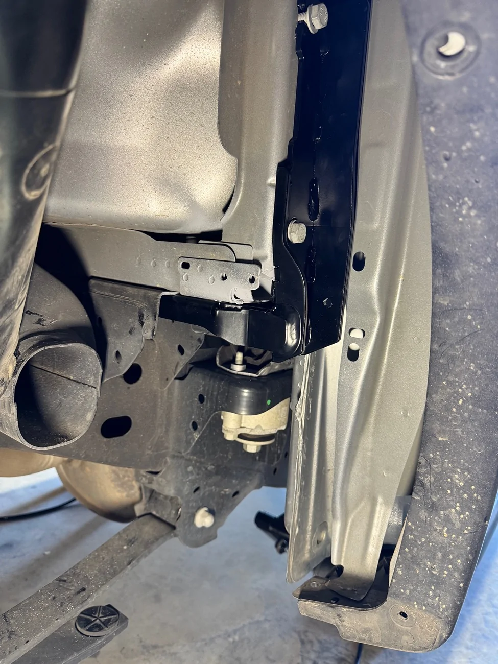

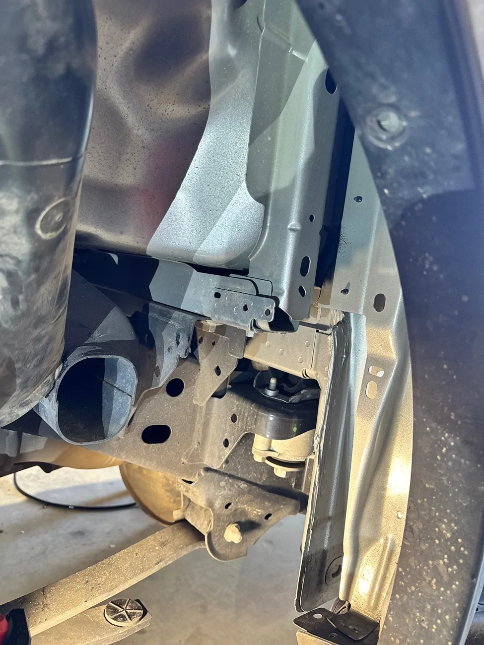

Got the braces installed, finally. The actual brace installation is straightforward. The biggest pain in the ass is the four rivets holding the front fender liner. They have to be removed and takes a lot of swear words and the right tools. The entire fender liner is installed with scrivets (plastic clips), but some brilliant engineer decided they need to add rivets to the front part.
The next pain is all the plastic clips that break if not careful. I did break one of the clip mounts from the fender, it’s tough to reach behind the lower front cover with the 8mm.
So I had to break pieces off my truck to install a part to keep my truck from breaking when it shouldn’t break in the first place. Cool.
$139 for kit. 3.5 hours.
Tips: save yourself frustration and remove the tires & get a Dremel to remove the rivets.
