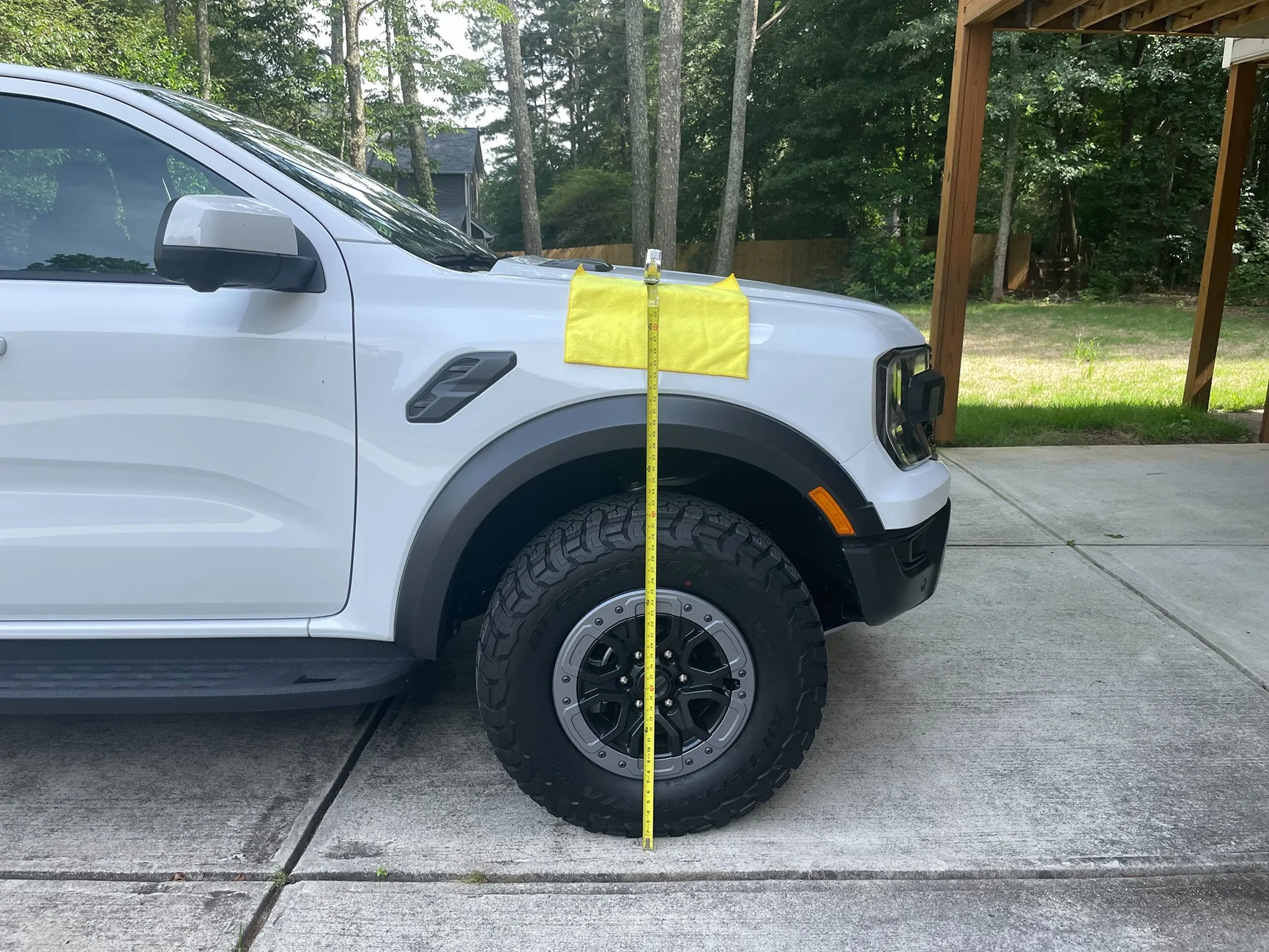

My last three Ford's that I leveled, I had to re-aim the headlights, so I didn't blind on-coming drivers.
I placed the vehicle 25' away from a garage door, marked the top of each projected headlight beam.
The truck went from this:
Ford Ranger Leveled the 2026 Raptor & didn't need to re-aim headlights... NICE. IMG_6676
To this:
Ford Ranger Leveled the 2026 Raptor & didn't need to re-aim headlights... NICE. IMG_6698
I placed the vehicle back in the same location, and the top of the projected beam matched perfectly with the tape I had place prior to the level springs installed.

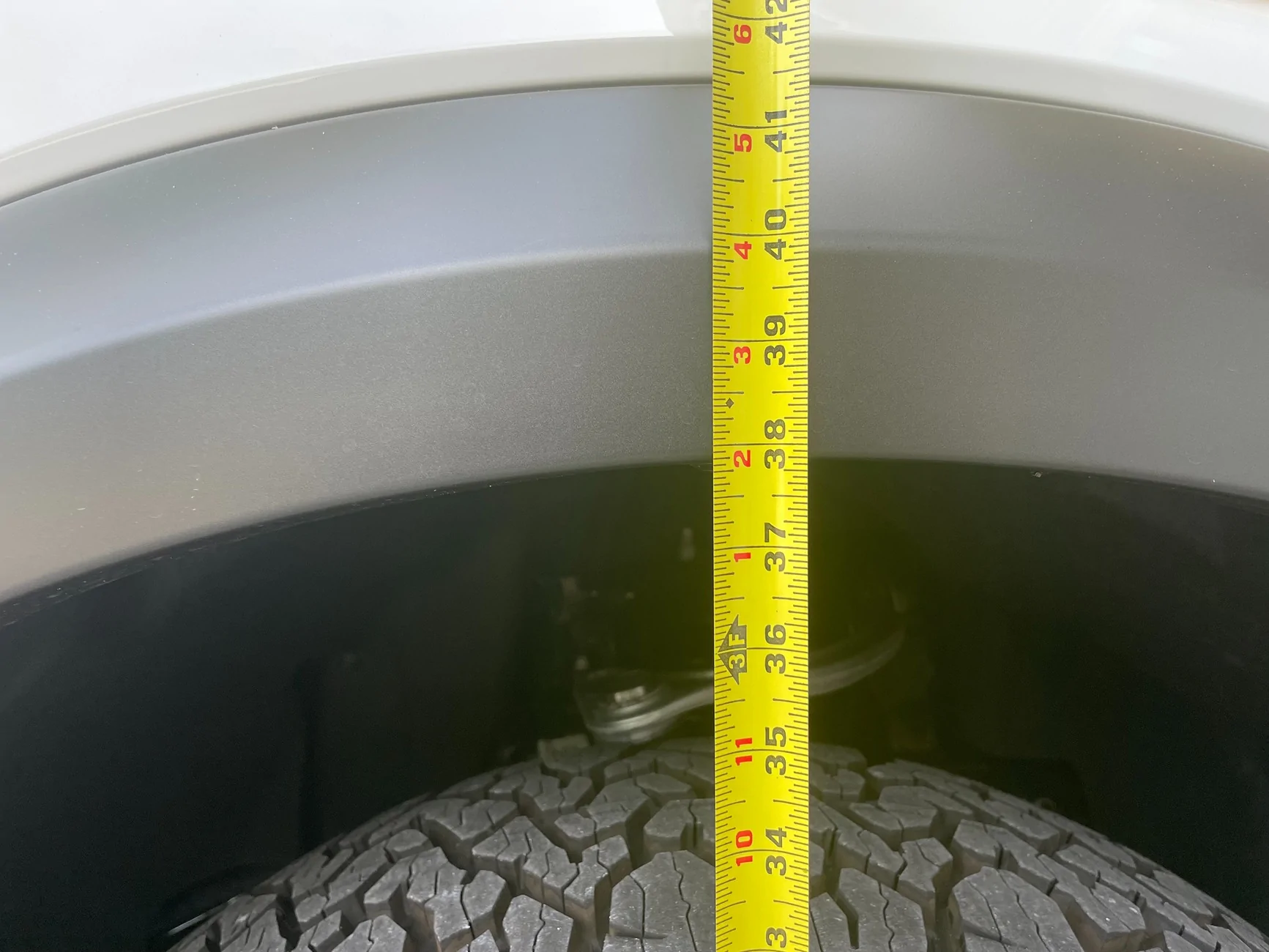

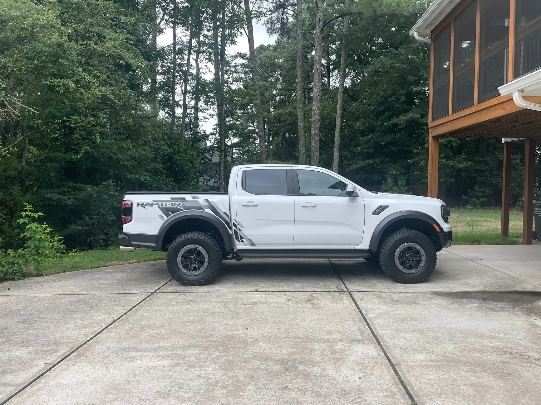

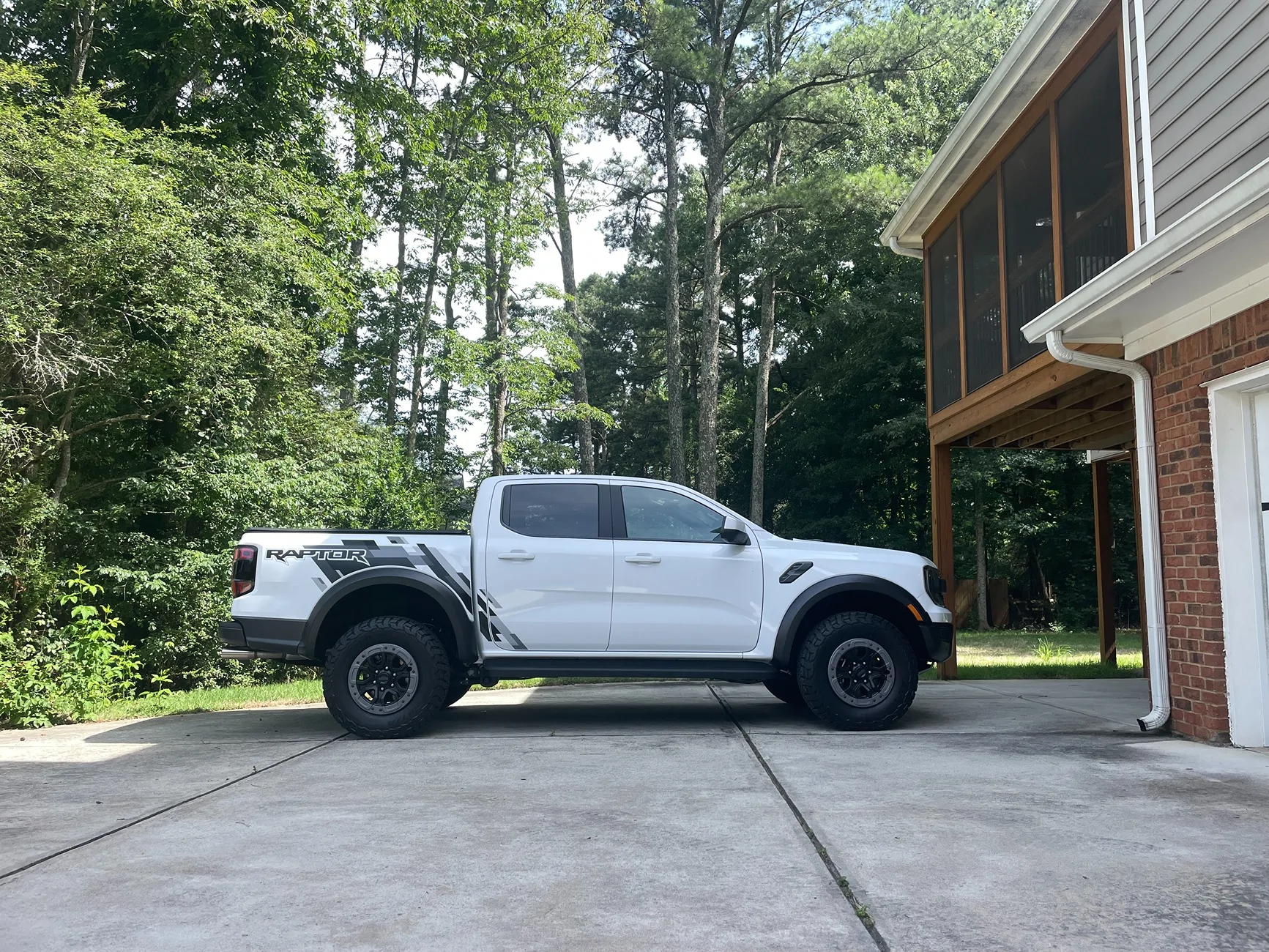

I used Eibach "Pro-Lift Kit" which raised the front 1-1/2".
It now has a 1" rake as opposed to a 2-1/2" rake.

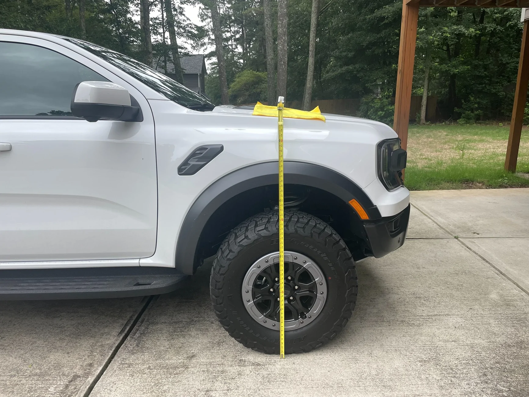

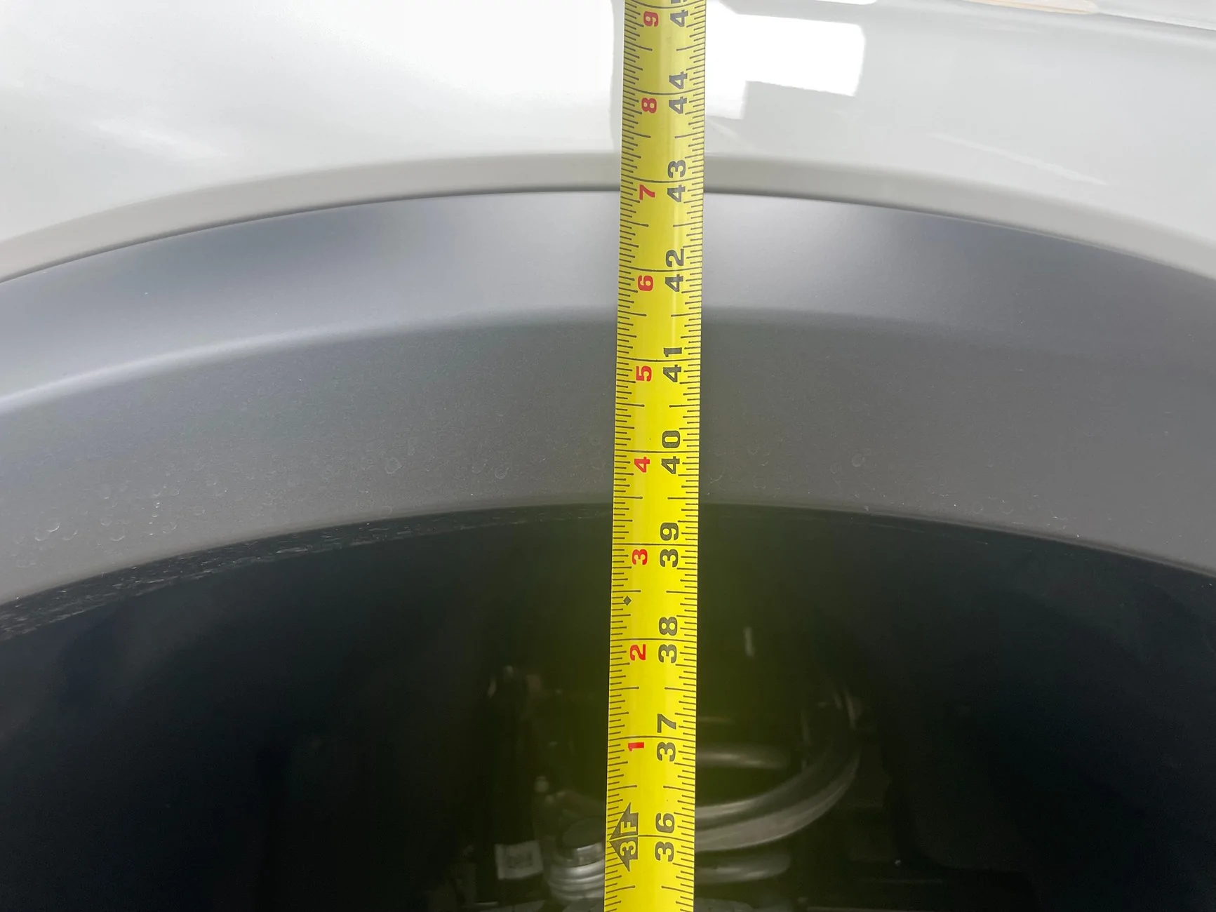

Before:
Ford Ranger Leveled the 2026 Raptor & didn't need to re-aim headlights... NICE. IMG_6683
Ford Ranger Leveled the 2026 Raptor & didn't need to re-aim headlights... NICE. IMG_6684
After:
Ford Ranger Leveled the 2026 Raptor & didn't need to re-aim headlights... NICE. IMG_6701
Ford Ranger Leveled the 2026 Raptor & didn't need to re-aim headlights... NICE. IMG_6702

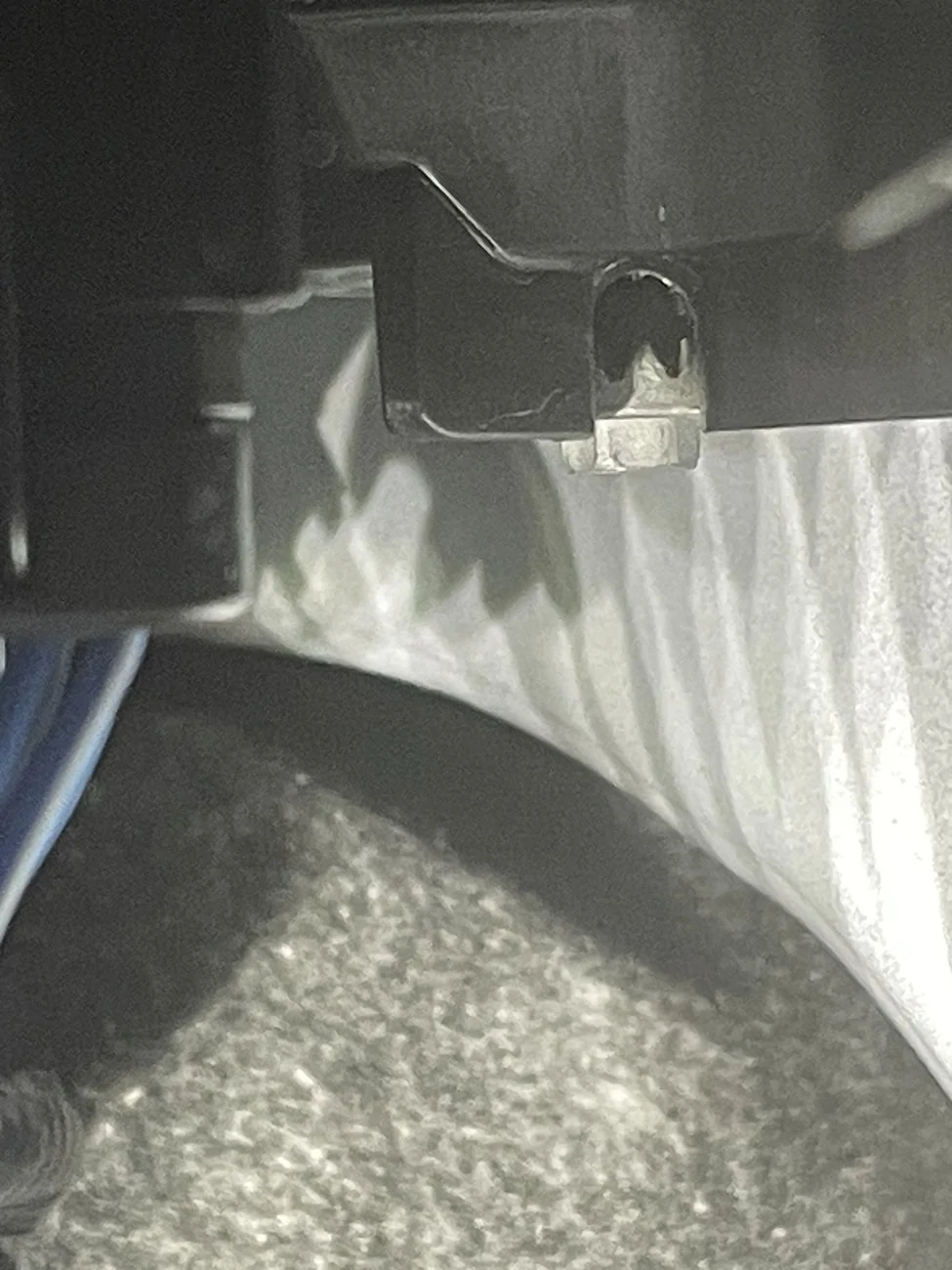

I also got home and popped the hood to discover there are no adjustment screws for aiming the headlights.

Look closer... there ARE adjustment screws. They are a bit buried.

Ahhh.... RTFM.
Page 433.
Ford Ranger Leveled the 2026 Raptor & didn't need to re-aim headlights... NICE. IMG_6708
Ford Ranger Leveled the 2026 Raptor & didn't need to re-aim headlights... NICE. IMG_6709
I guess a 1-1/2" lift did not raise it enough to make a vertical height difference needing adjustment.
I didn't find anything in the manual about recalibrating the height sensors.

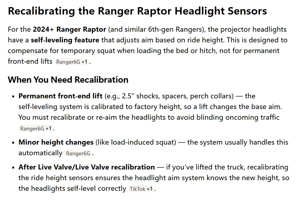

This is what the AI Google machine spit out:
Ford Ranger Leveled the 2026 Raptor & didn't need to re-aim headlights... NICE. Screenshot_16-6-2026_182020_www.bing.com

The manual isn't going to say anything about calibration because Ford doesn't want the truck leveled. You need to calibrate VDM. Maybe HCM, if the Raptor has that. Then you'll need to adjust headlights.
Gravy Jones
Mar 21, 2025
65
GTI
If you didn’t recalibrate the ride height, the lights probably did adjust themselves down to the original level as the truck thinks the front suspension is extended. Once you recalibrate ride height (which you should), the lights will re-adjust to the factory setting. Which will how be high. You’ll need to manually adjust them back down using the screws.
