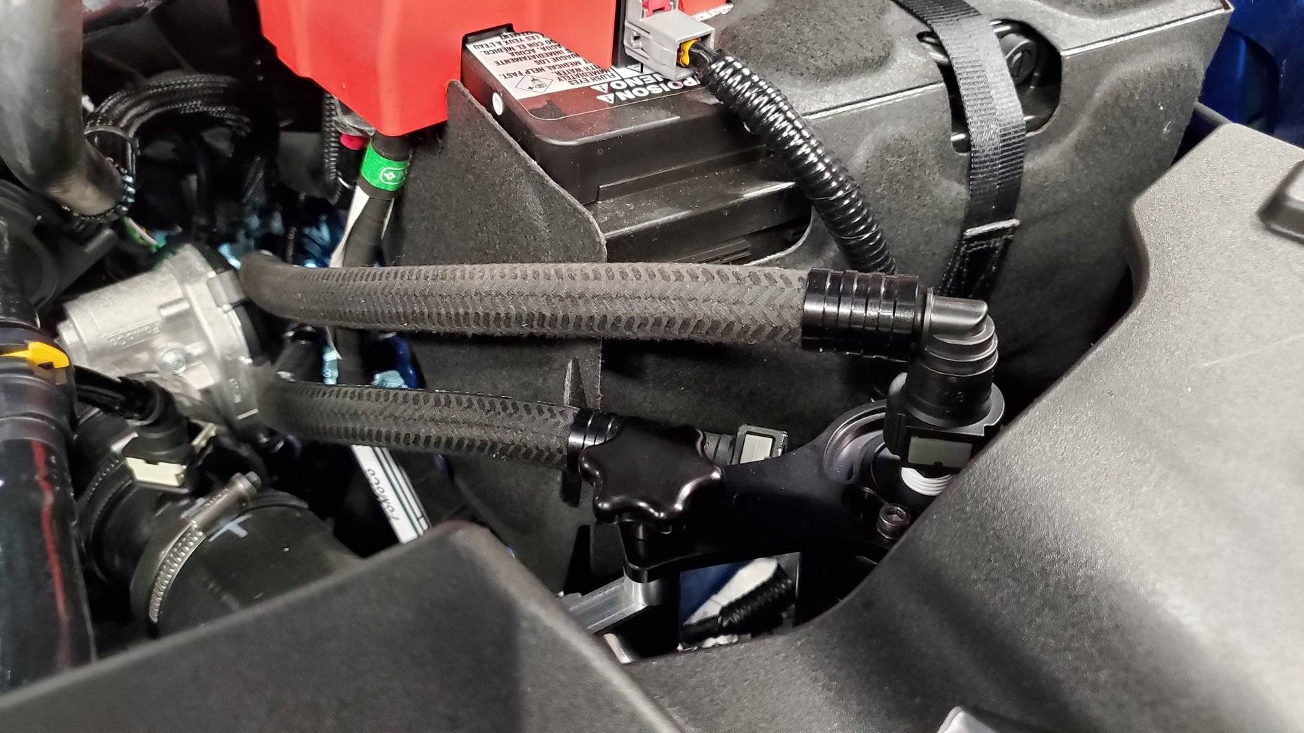

Are people holding out for a bolt-on catch can design, or would offerings like mishimoto’s universal one be sufficient?
Because Who knows when a company is going to offer a direct bolt-on catch can..

Watch the videos on how to install one, basically you can reuse the two hose barbs, and a few lengths of 3/8" fuel rated hose. If you can find a place to mount it, any quality catch can would work (in my opinion).
Something like the Mishimoto, or a Provent 200 would be fine. I'd find one that can have the drain routed underneath just for simplicity.
The reason I'm not going to install one is I don't want to tear a bunch of parts off a brand new truck, and I will be under warranty until 150K miles.

Just finished up fitment on the UPR 5030 can with check valve! We should have them ready soon.
Can’t wait, I’ll be ordering one as soon as it’s available
