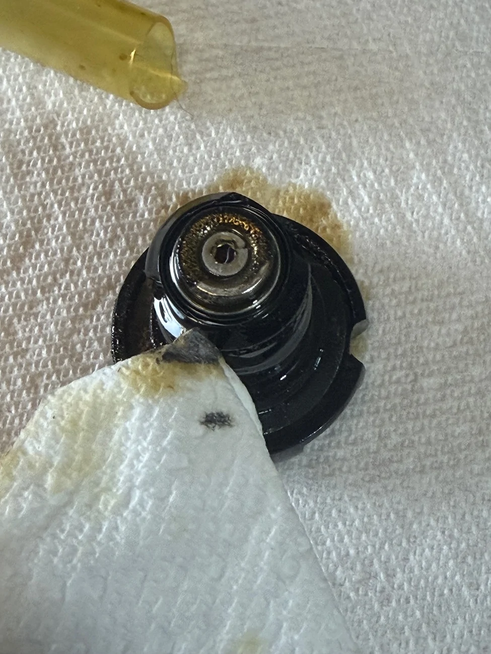

The screws backed out, and I had just reinstalled it after taking it to the dealership so I know they were tight before the TRR event. I put some red loctite on them when I got back. But damage is already done, noticed some metallic particles stuck to my ronin plug when I changed my oil yesterday. I kinda hope it’s from turbo erosion instead of something internal.

I just went out and locktited mine too. It does look like a weak point of the setup. I'll have to keep an eye on it.
