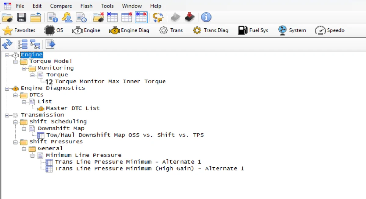

Ok,
i got around to updating my Procal since August of last year. The calibrations are a little different. I think that is why you have to download the performance cal again with your Ford Performance account.
Ford Ranger Procal update for RR Calibrations

Space Engineer
What software is that? Seems... manufacture-y
