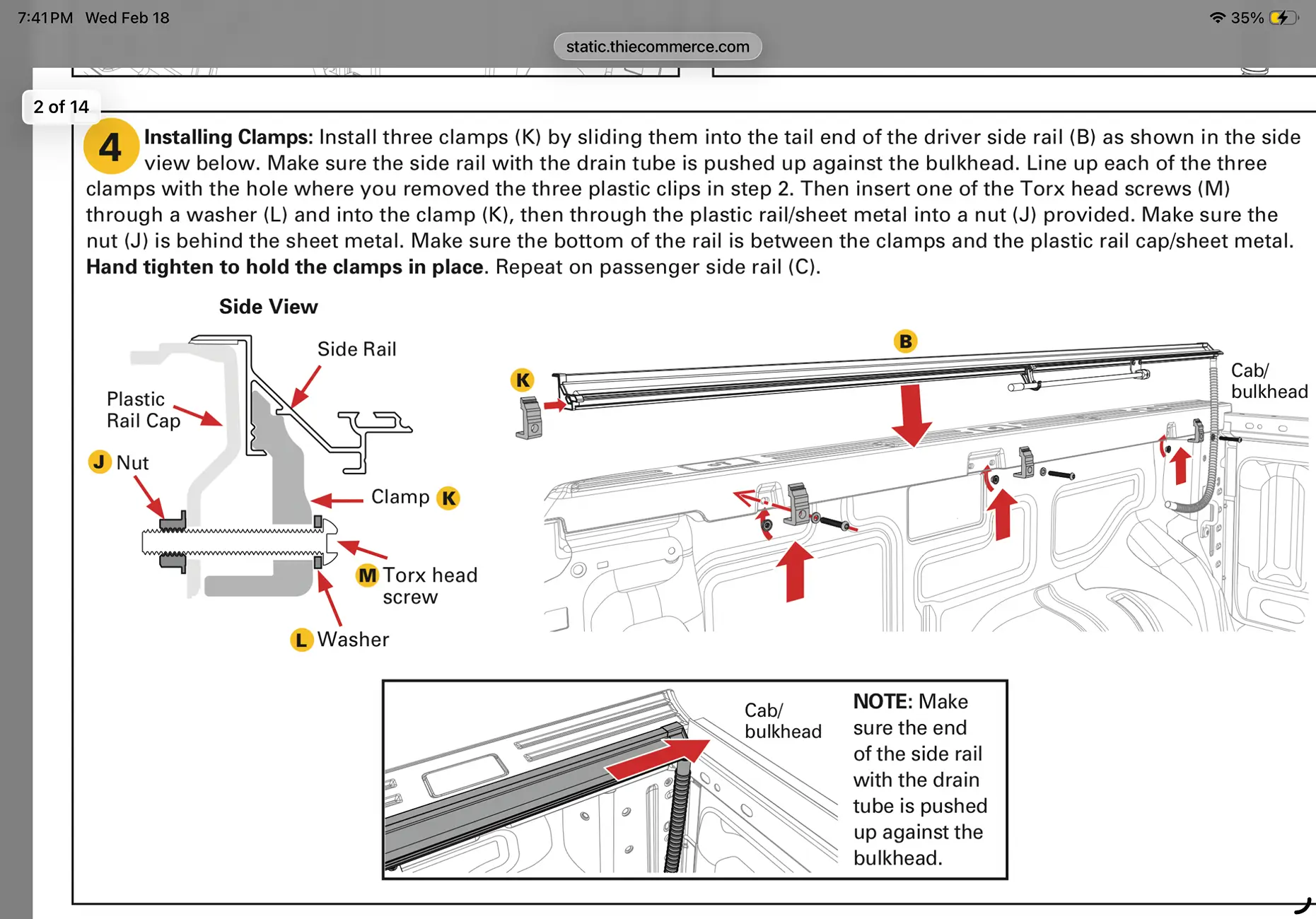

Depends on how they are bolted or clamped down. I ordered the EGR rolltrac and it bolts to the inside 4 bolts on the plastic bed cap and has brackets and rails that have some slotted holes. I don’t know if there is enough slop for them to go lower or if they need a new bracket. They also hook on the front of the bed which could be a problem besides the front rubber seal that will probably be too thick now.

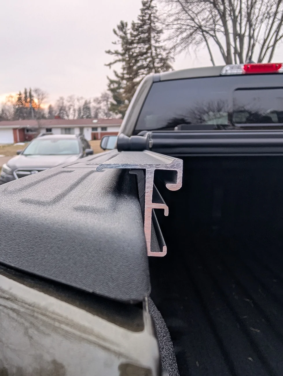

Most tonneau covers bolt into the holes in the side of the bed here (for the 6G Ranger.) The rail then extends over the plastic bed cap and rests on it. That's a fixed height. So it will extend into mid-air over the thinner bed caps on 2026. None of my 3 covers (Bak or Truxedo) have enough adjustment in the fasteners to compensate for the height difference.

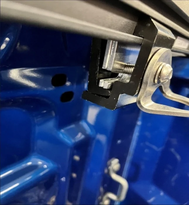

I think I may be okay with the Leer hf650m, should be delivered today. But bad weather here for next 5 days at least in the NE.
The clamps seem to just clamp rail to bed side, no existing holes required.

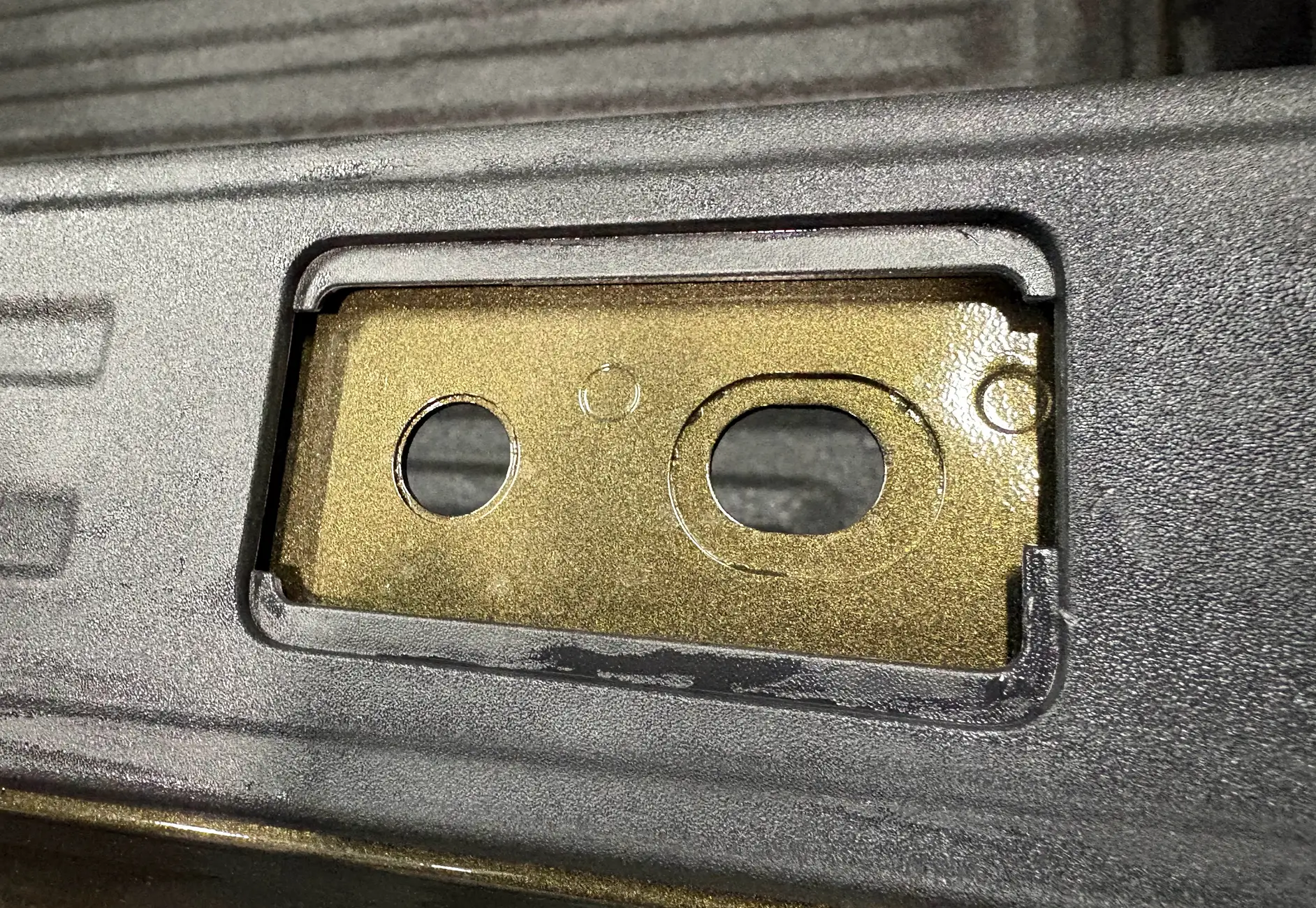

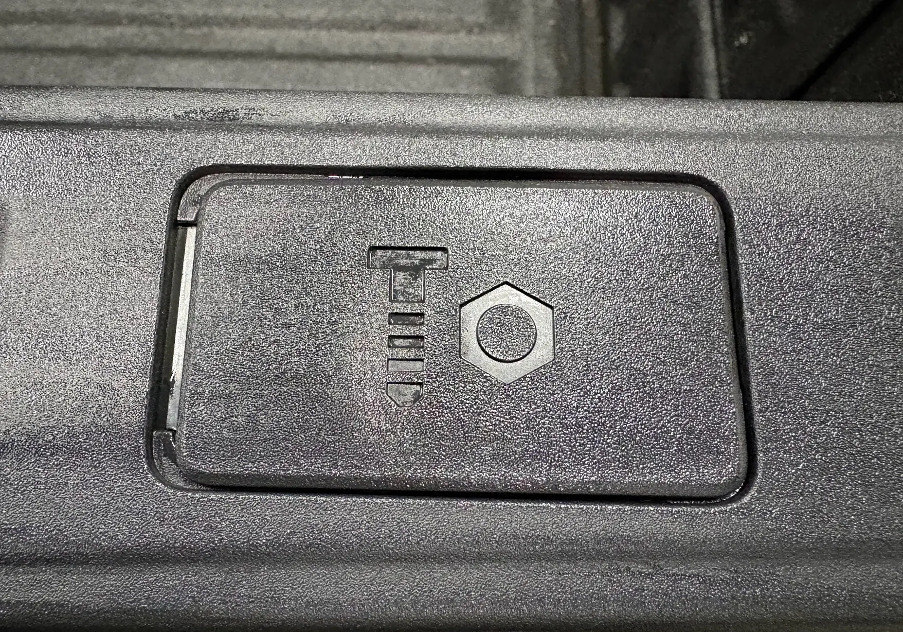

Air gap is definitely smaller. There's still 1/4" or so. It would probably hold a fair bit more weight than the old design. Nothing mentioned in the '26 owners manual, though.
Looks better but will still leak. Wish they made them solid but with an ident in where you can cut. Not actually make them so easy to removed .

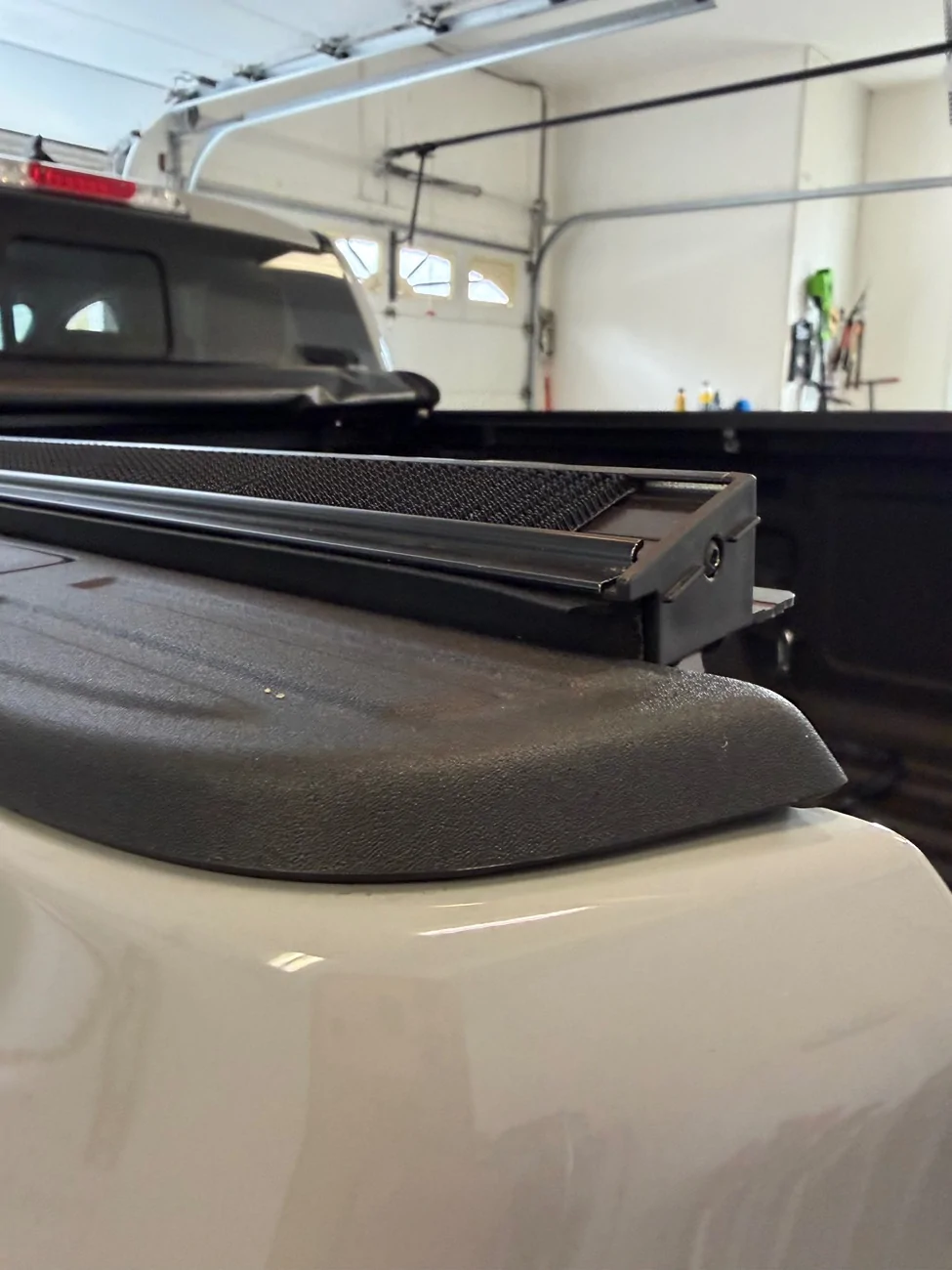

I got a 2026 RR and assumed Ford wouldn't change the rails/sides in the middle of a cycle, so I bought a Leer HM650 that now sits half an inch above the rails. Anyone knows if Leer has an actual contact number? I'm really hoping this can be an easy clamp/rail update...otherwise I'm out $1200 and still need a tonneau cover.

the new one is lower with respect to the holes and bottom of the rail.
so depending on how it clamps that can be an issue.

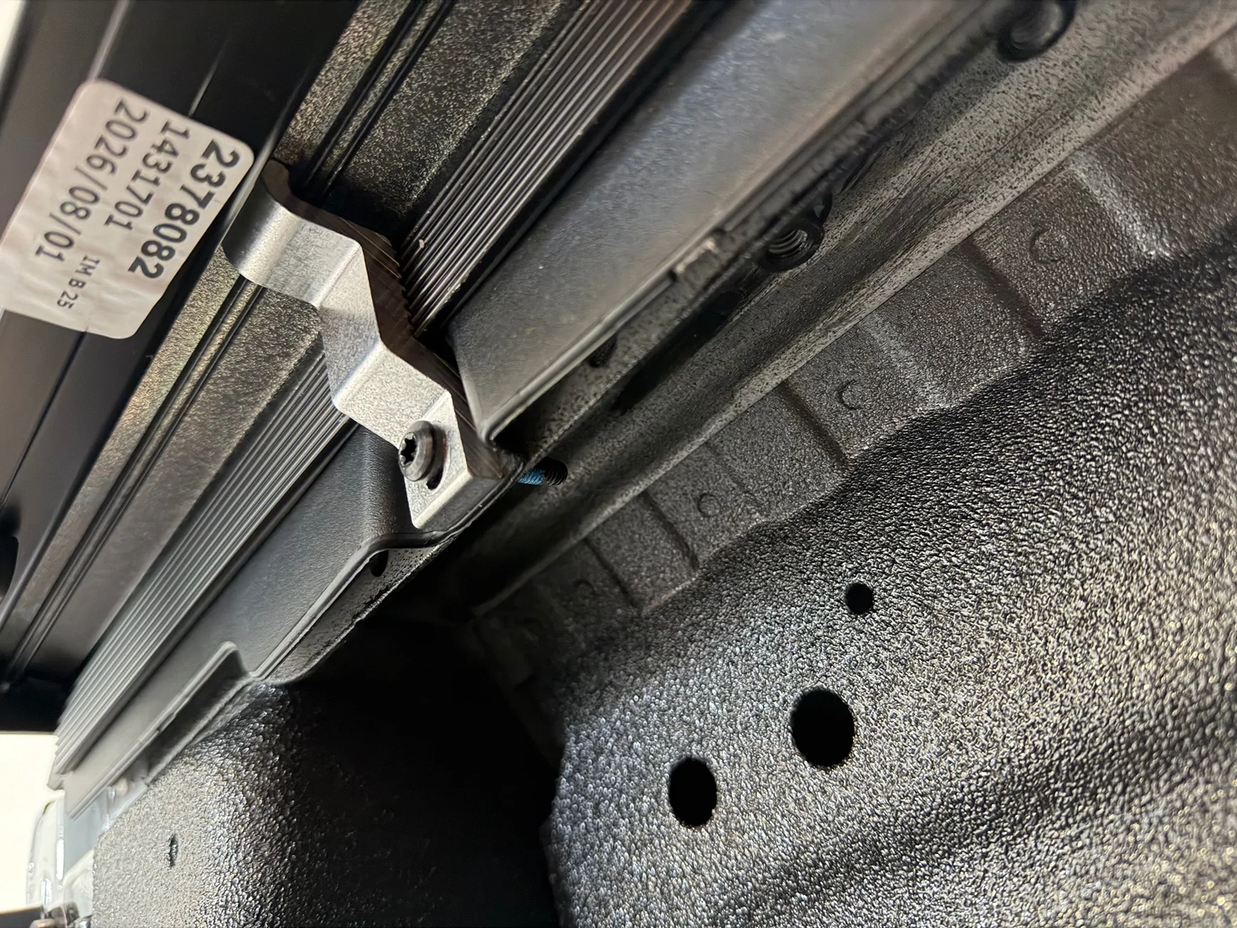

Mine is raised 1/2 inch. It’s bc the clamp is a fixed height, although there is some wiggle room it is not enough. It will be easy to fix once Truxedo’s engineers respec the clamps. I’ve got the Pro X15.

The clamps index to pre-existing holes, so the rail lip sits half an inch above the rails.

The Leer hf650m doesn't appear to use any existing holes, more of clamp rail to bed hence my ask.
Posted a pic up above.
