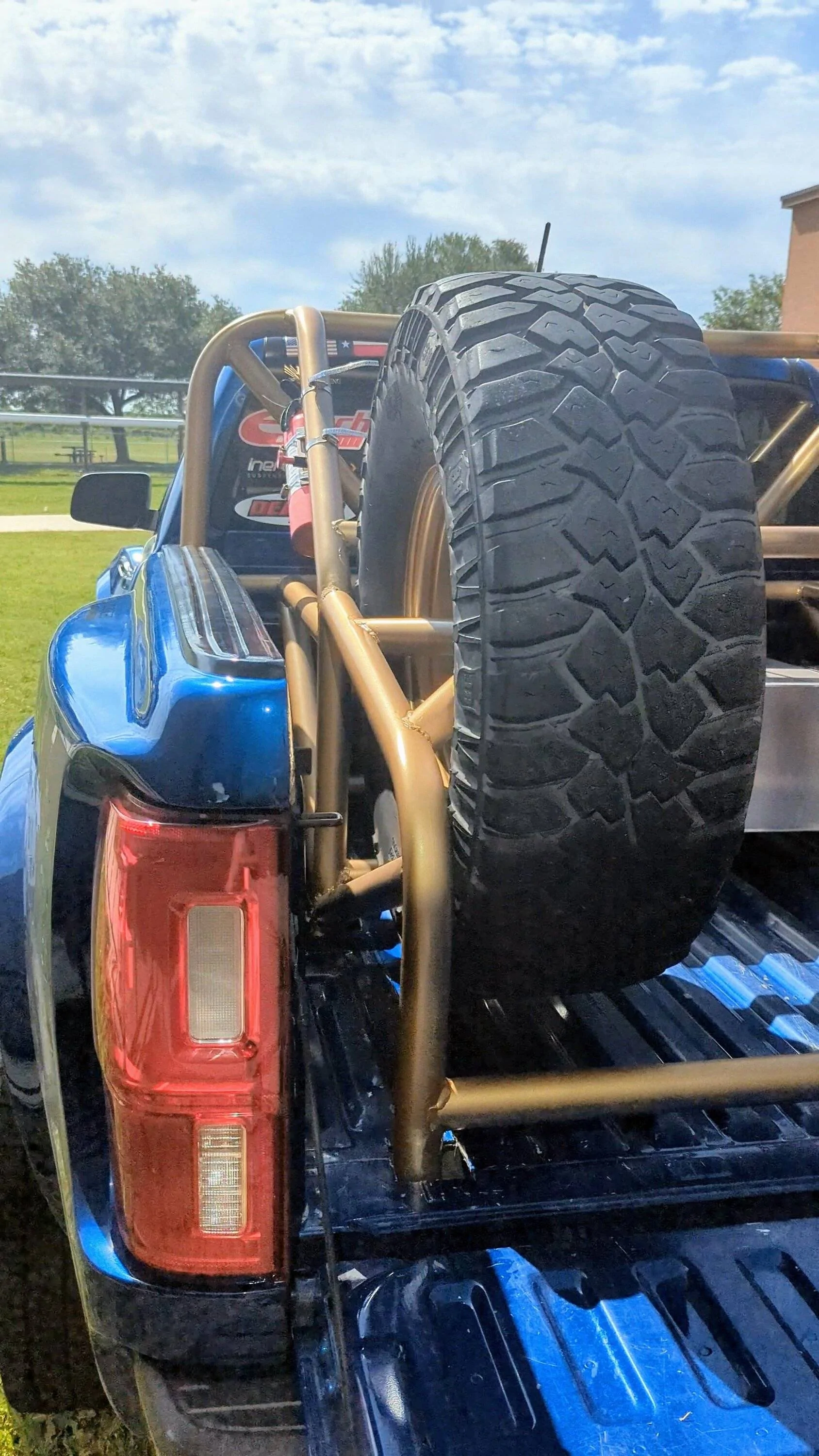

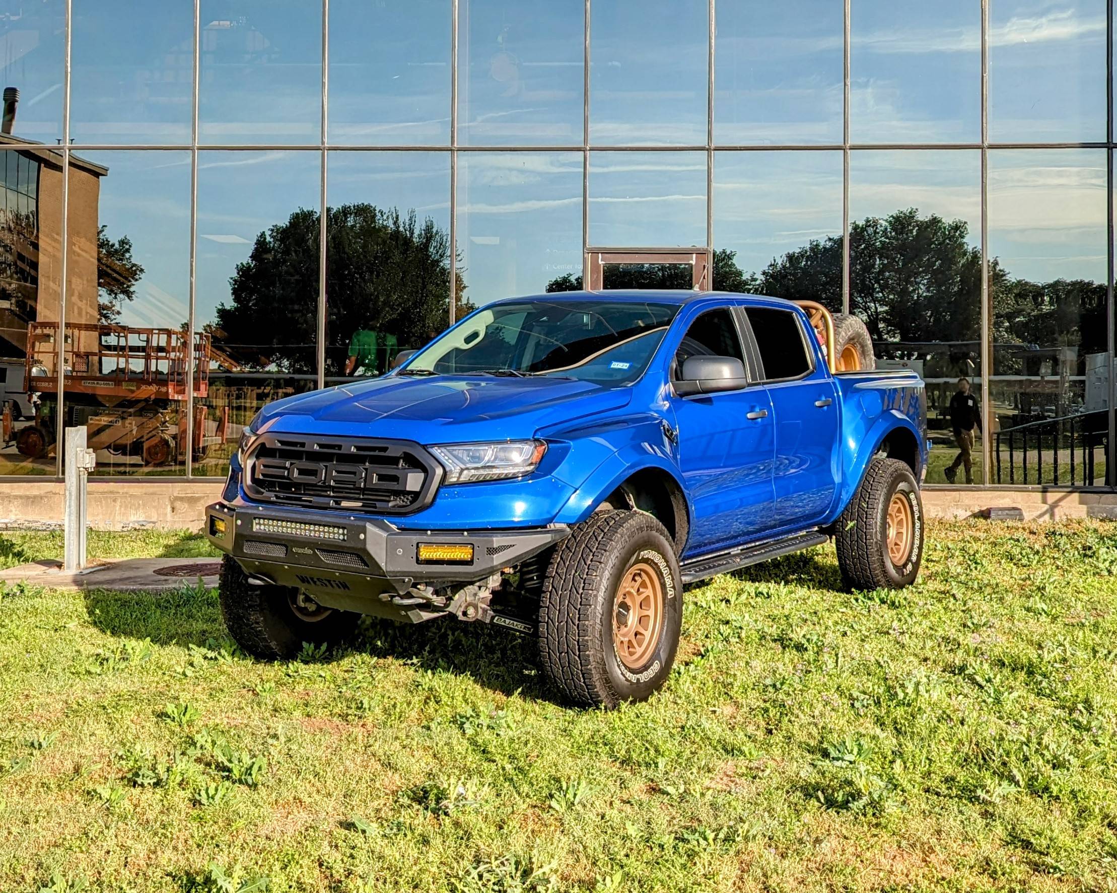

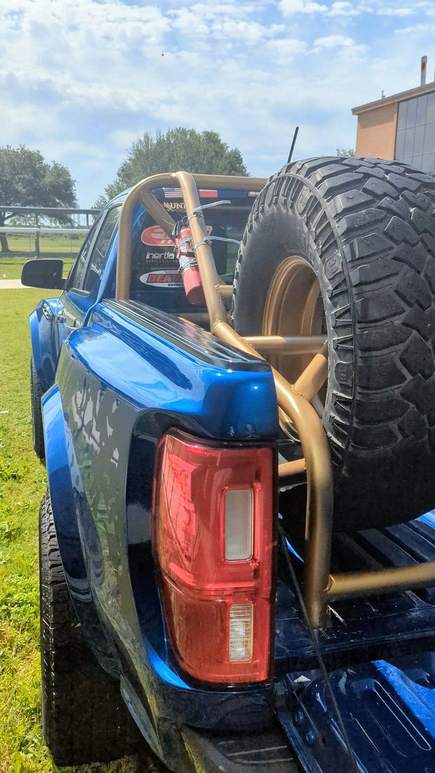

Here's some pics of my 5g with wide body and 35's, and I can't help but look at the Ranger Raptor as more skinny now although I know it is a beast.
Love these pics of your Ranger! Thank you for sharing these with everyone.
