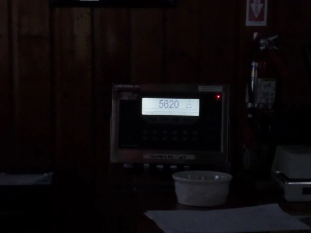

I had a 2020 F150 Raptor SCAB that weighed 5620 with a full tank of gas. Of course they stopped making Raptor SCABs after 2020.
MY RR has a full tank at the moment so Maybe I can get that to the scales later today?

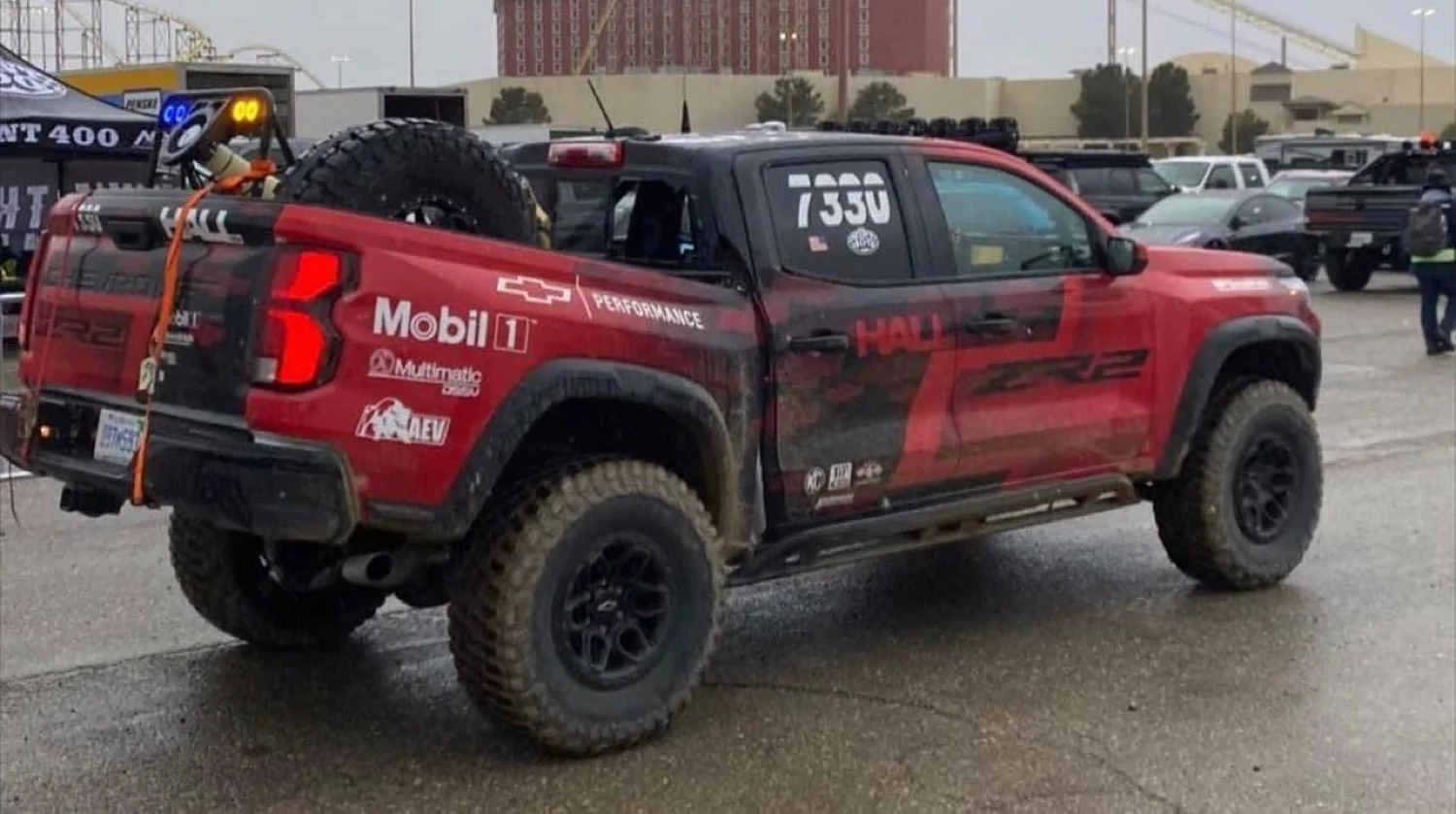

The RR is the only mid-sized truck with a heavily reinforced axle and frame. There are some reinforcements on the other mid-size trucks, but most of them run production axles, not a race spec axle. The suspension setups in the rear basically include shock upgrades and in the front slightly longer control arms.
The RR has a completely custom purpose built 4-linl + Watts. The Taco uses production 4 link + panhard with some coil over shock upgrades on their standard axle. The Colorado literally uses production leafsprings with some DDS spool valve dampers and hydro joince bumpers on a production axle and zero frame reinforcements which is why their race truck folded in half on the mint 400 coming off a jump.
None of the other trucks have CGI engine blocks either or oil cooling galleys in the pistons or steel ring inserts etc. (well not sure about the 2.7L Max in the Chevy, but Taco dowsnt). Thats all turbo diesel tech from the 6.7 Power Stroke thats built into the 3.0L, even the 2.7L is lacking some of it (no oil cooling galleys in its pistons, much thinner skirts and wrist pin areas vs. 3 0L).

Funny thing is according to a post above the Chevy actually weighs a bit more than the RR.
