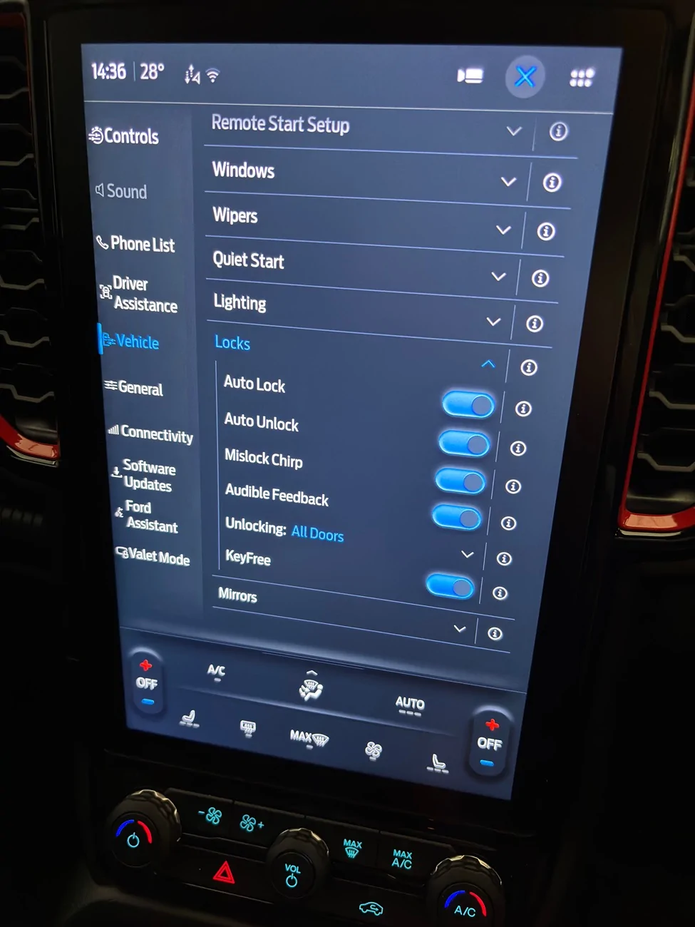

Here’s the settings in my RR, weird how you don’t have them? My software is on version 6.16.0
Ford Ranger Raptor horn honking on Lock/Unlock IMG_8587

Mislock chirp and Audible feedback were the first things I tried. They are both off in my truck and it still honks when it is locked and unlocked. Mislock chirp will "Chirp if a door is not properly closed when the vehicle is locked". Audible feedback " Allows vehicle to Chirp or beep twice if you lock the vehicle remotely TWICE within 3 seconds". When off, neither of these settings stop the horn from honking when I normally lock the truck either with the remote or door handle.
