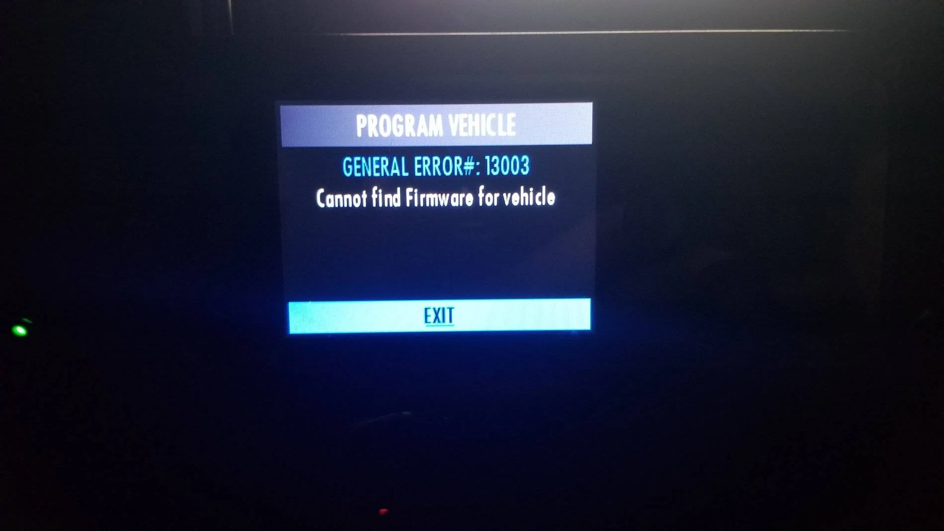

Unleashed finally emailed and said to download and try this initial tune and the BDX gives me this..... now I have to email SCT/BDX to see why.

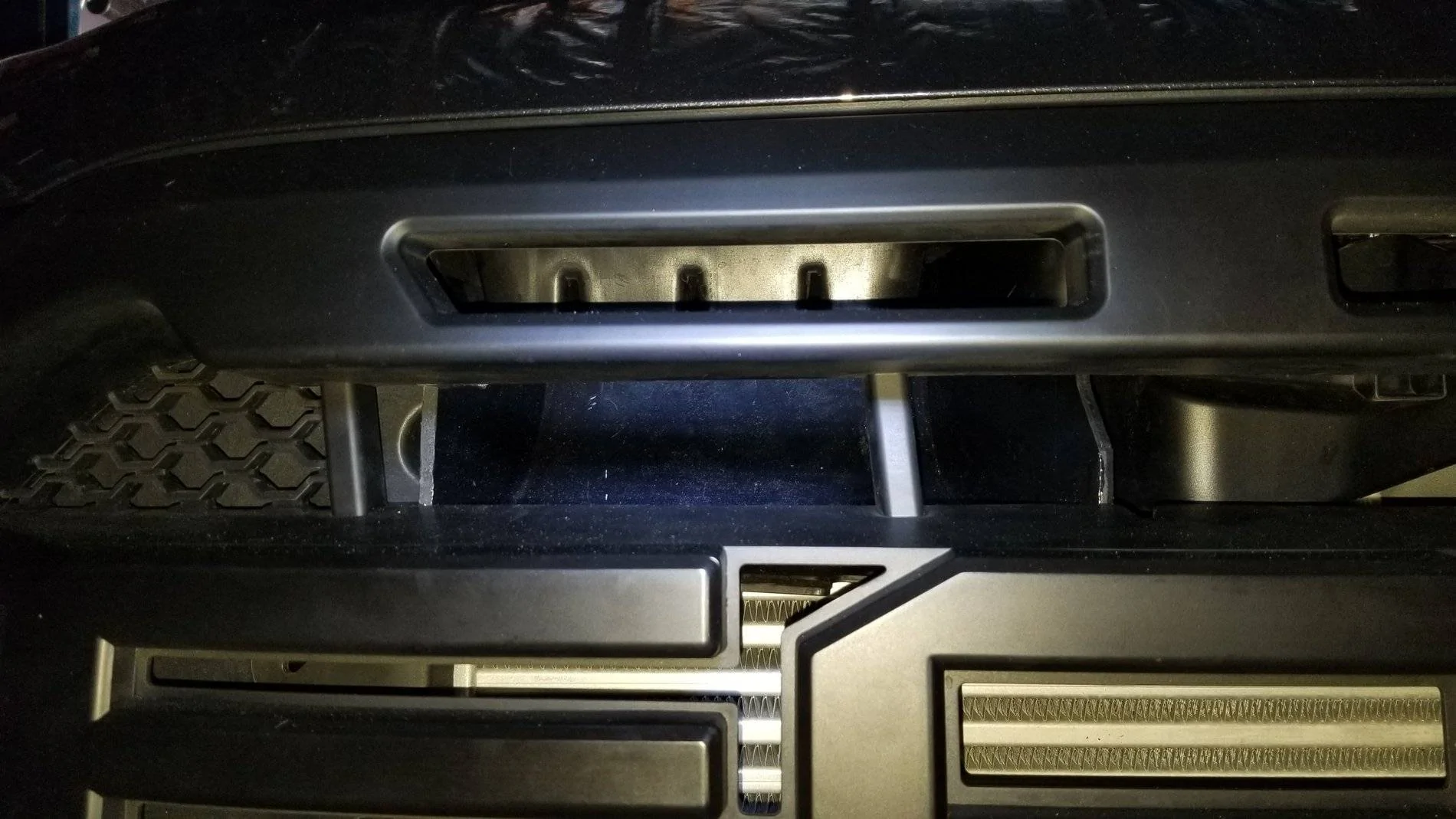

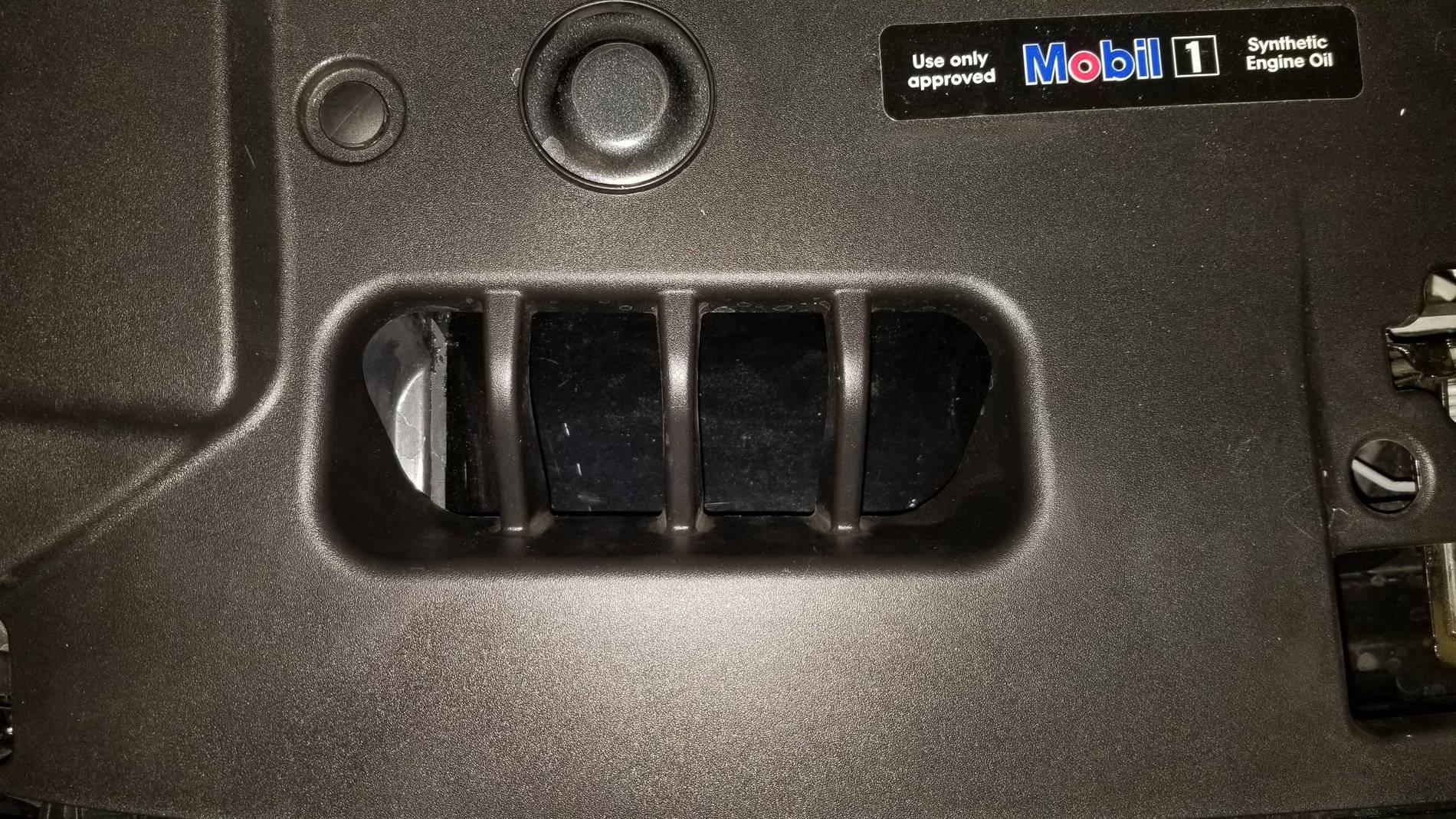

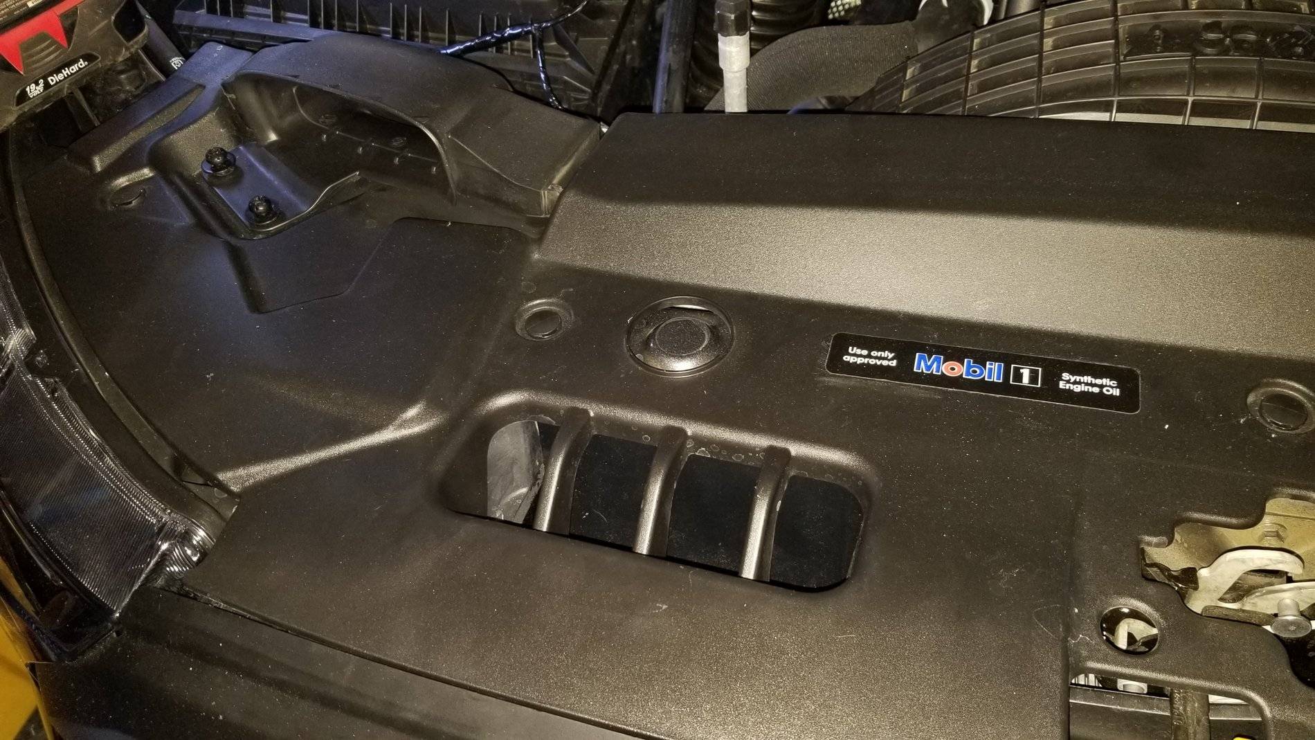

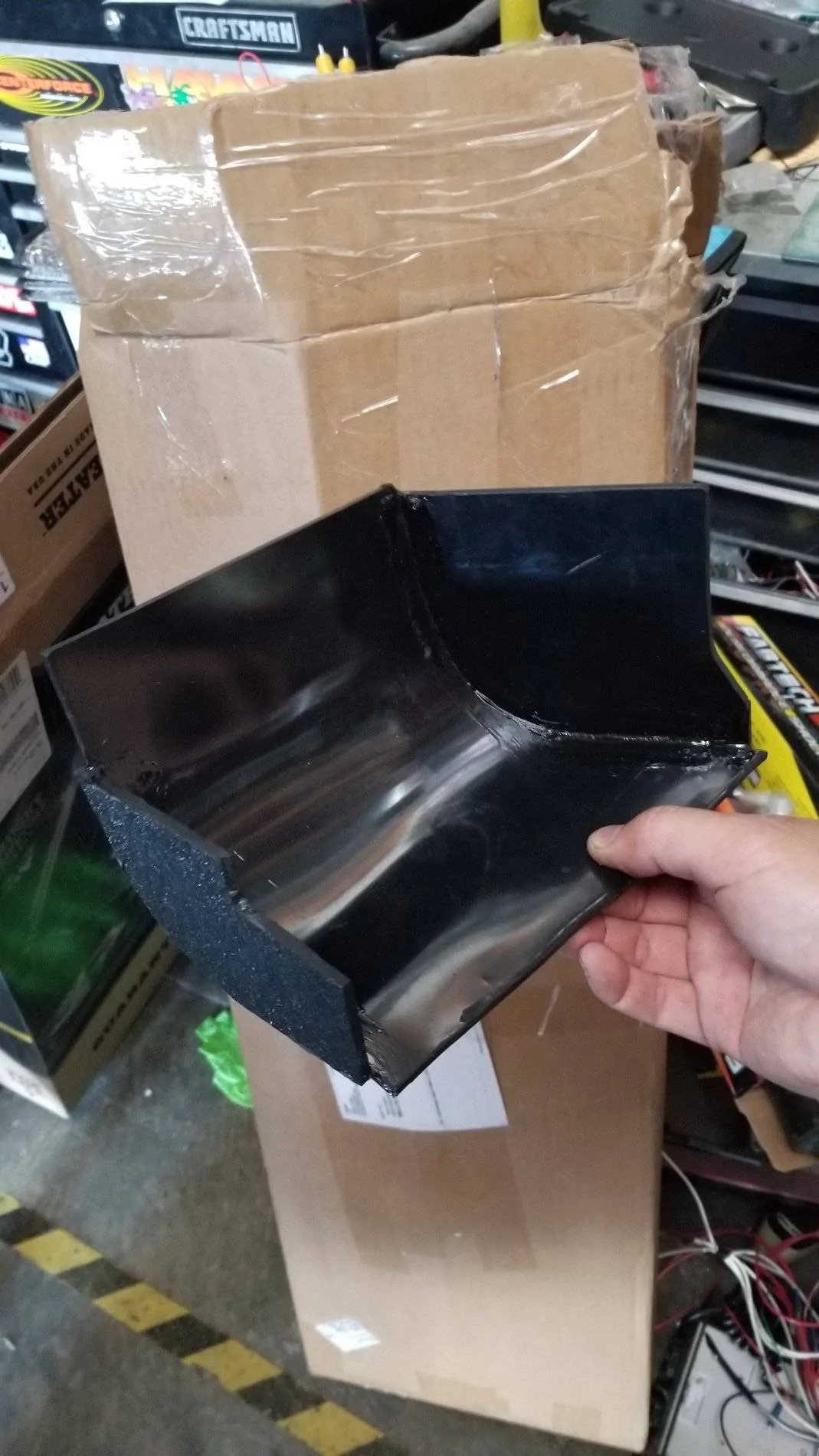

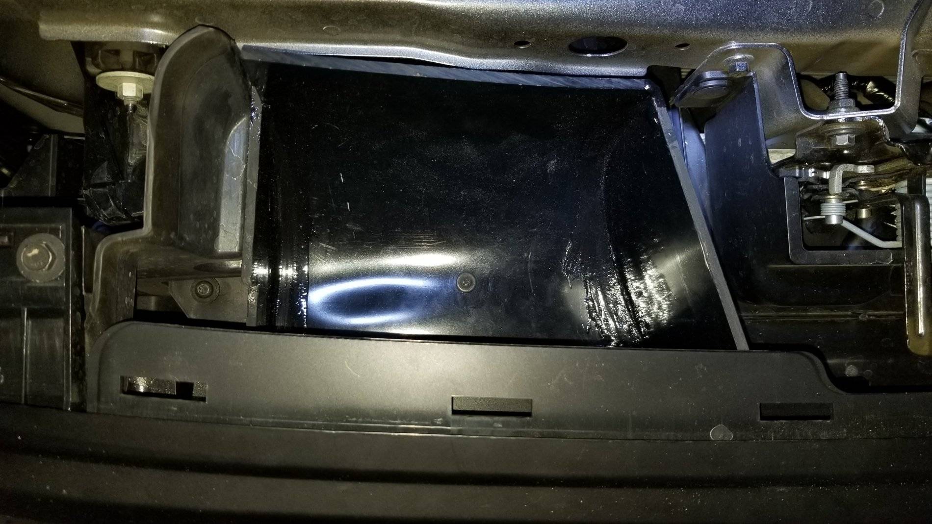

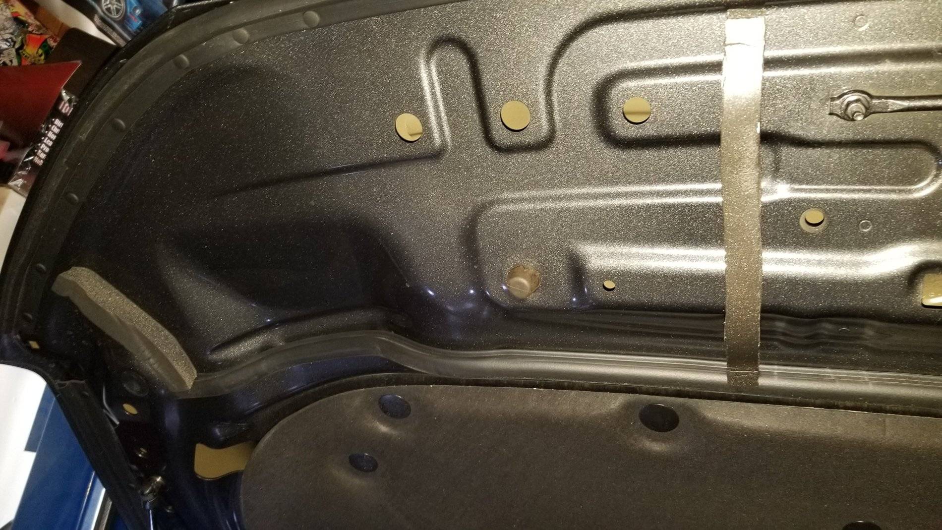

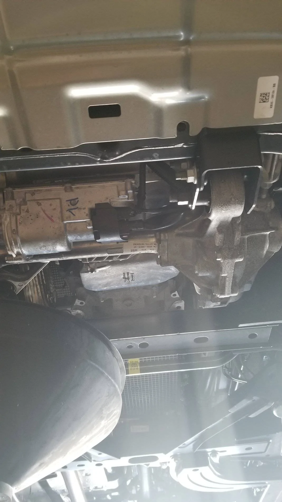

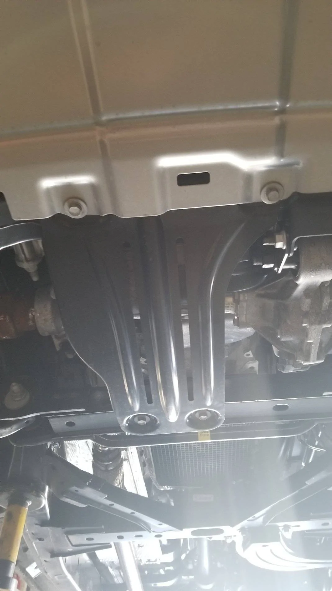

Noticed there's an air inlet that sort of helps feed the stock intake scoop. There's foam that I assume is too help get the air between the hood and radiator cover over towards the scoop. I decided to make a scoop and add more foam to help get more air to the stock scoop while moving.

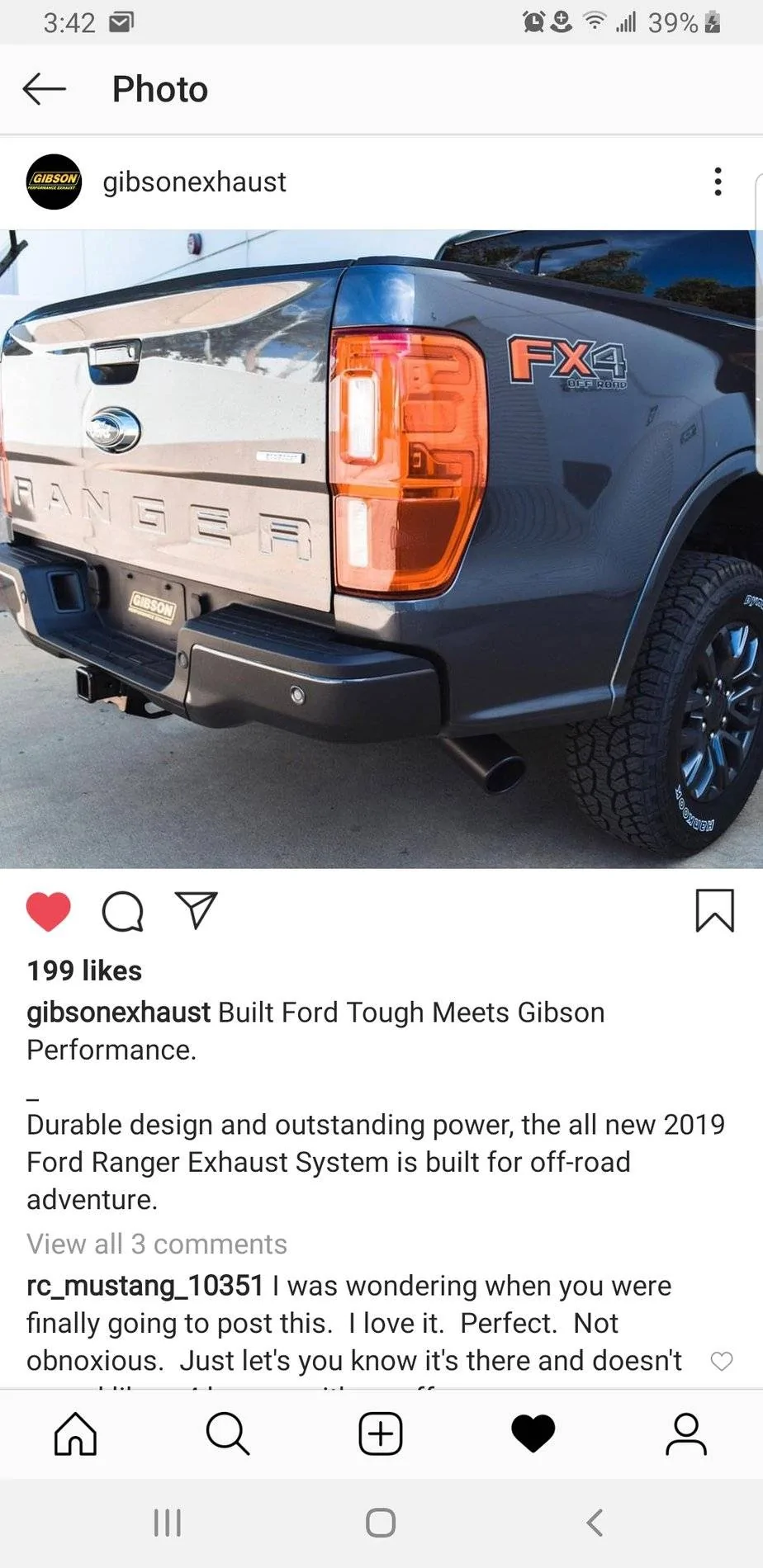

Gibson finally promoting on IG.

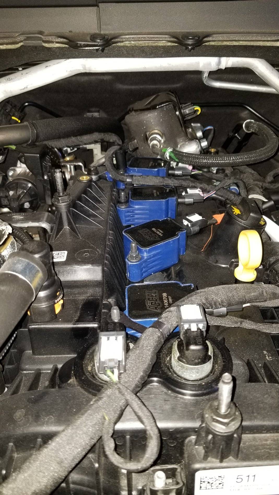

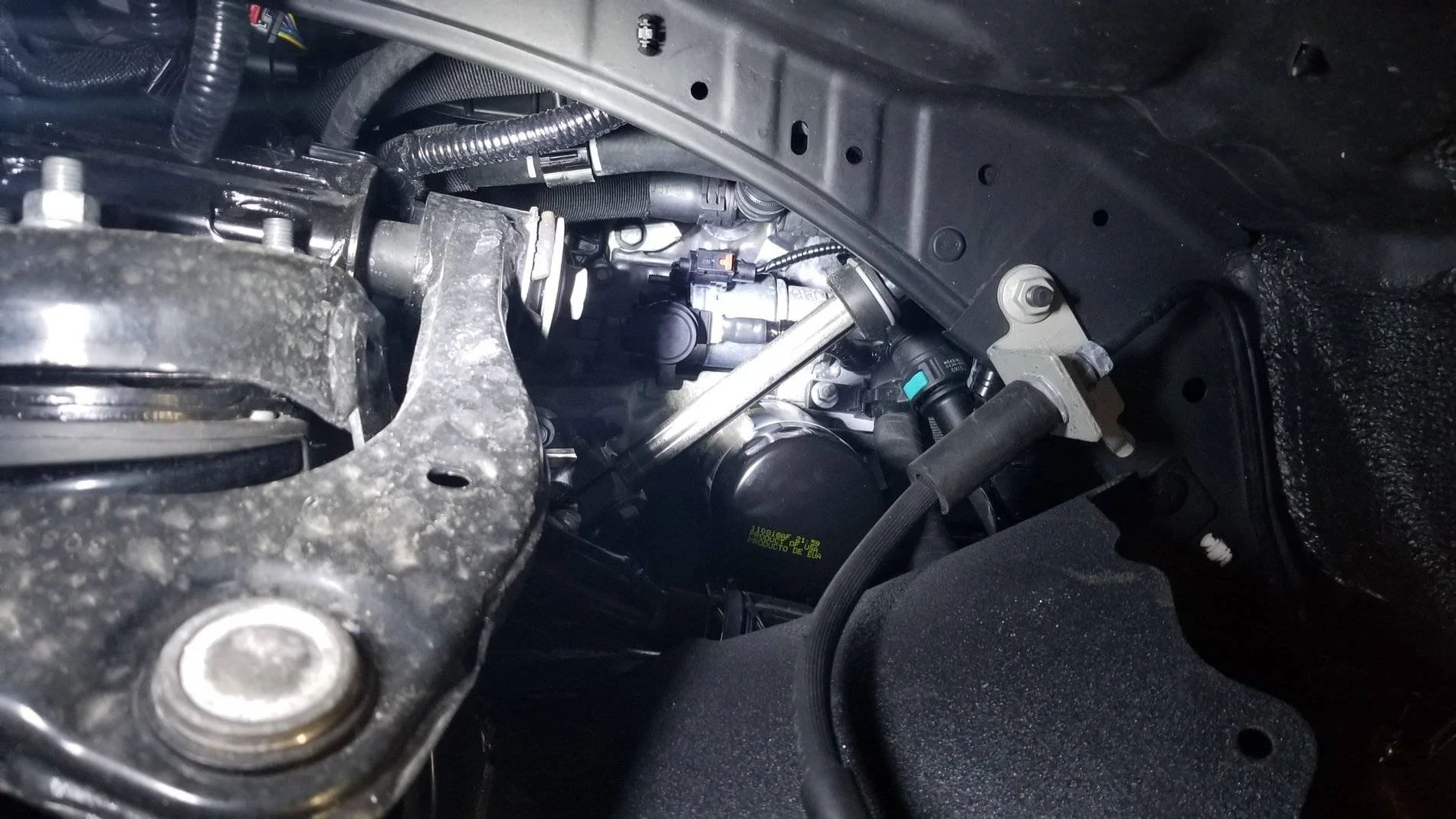

Got a set of Accel coil packs for a pretty good price. Swapped them out and the little miss/stumble is gone at idle and low rpm. I'll see how it performs on the drive to work tomorrow.
Ford Ranger RCMUSTANG's Magnetic FX4 20190425_183410
RCMUSTANG
RCMUSTANG
Ray
Jan 22, 2019
1,541
575
Los Angeles
1989 Mustang 2017 Fusion
Can't say I noticed anything for regular driving but the cold/low rpm stumble/miss is definitely gone with the Accel coil packs. Worth the $120. resistance measured at 32 compared to 33 stock.

I figured it was a stumble or miss due to 1. Bad gas, 2. incorrect plug gap, or 3. Weak spark. Sounds like you corrected it with 120$ of your own money when that should be coming from Ford really.

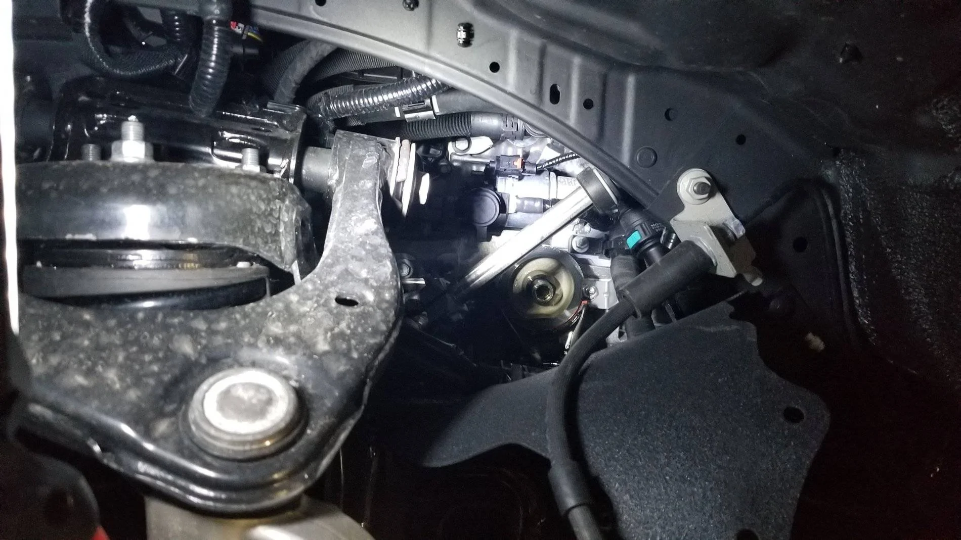

Zero reason to complain about the oil change. Even if I wasn't doing it on my lift it's still easy. The skid plate and flap is a complete non issue. Only thing of note is where to put the pan when you remove the filter. It's further back with the little drain flap. 15mm for the skid plate bolts and the drain plug.
Keeping in mind that if doing this on the lift, you will be able to get both hands into the wheel well (or if you have really long arms). I am 5'9" and have regular length arms, and I could only get one hand on the filter at a time while changing on the ground at full right lock. It took me a long time of putting excessive amounts of one handed torque on the filter for it to start spinning. If you can manage to hit just the gasket mating surface with penetrating oil and leave the filter dry, it would probably spin off with one hand no problem.
Of course if they lubed your oil filter gasket and put it on hand tight it will probably come off without issue as well.
Doesn't matter to me. How much time do you have to have Ford track that down for you? If the coil packs are stronger and fixed it for me I'm fine with that. I'll see over time if it helps with mileage.
Short arms, long arms. I used the oil filter removal tool with an extension. Either way on a lift or jack stands or on the ground. There's a solution. I'll give it one try and if it's too tight out comes the tool. Mine is a 4x4. I can just slide under with a creeper for the rest.

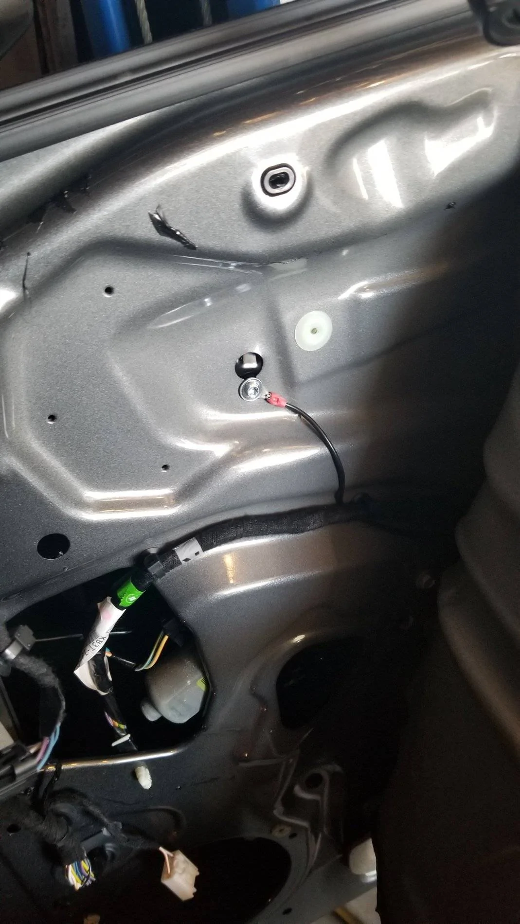

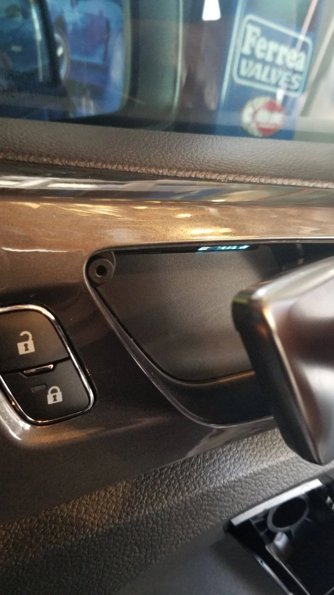

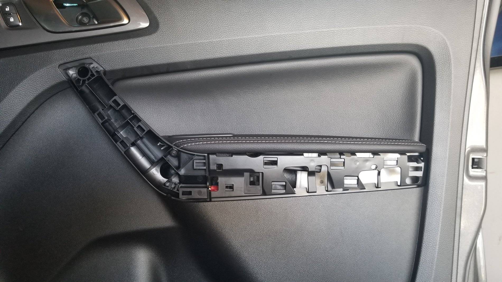

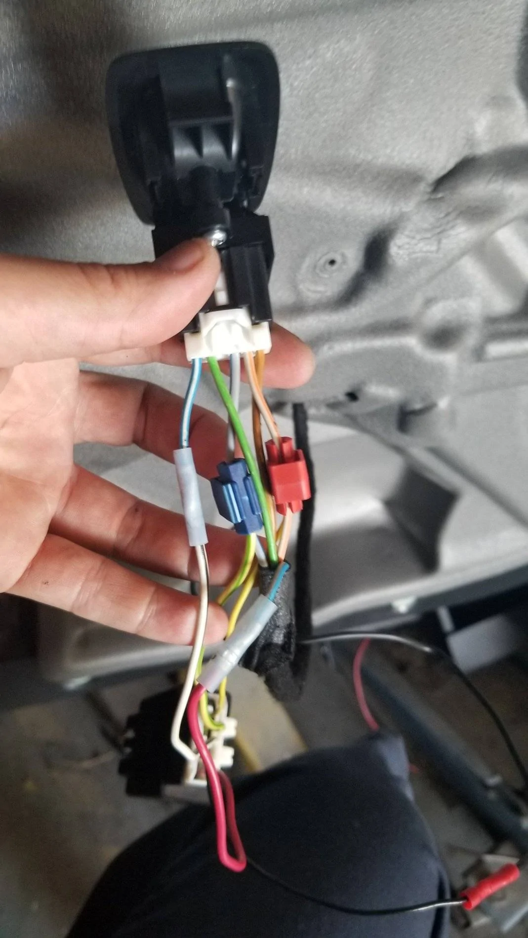

Old school mod. Added one touch down to the passenger side window.
Pop off cover behind the door latch.
Ford Ranger RCMUSTANG's Magnetic FX4 20190419_163032
Remove trim on armrest to access 2 screws.
Ford Ranger RCMUSTANG's Magnetic FX4 20190419_162815
Pop off speaker if equipped.
Remove 2 screws at bottom of door panel.
Remove window switch by lifting freon the rear.
Disconnect window switch.
Pop off door panel from the door held remaining lower clips.
Disconnect the wiring to the lock and ambient lighting.
Connected module and ran ground. Tuck module in door panel under armrest.
Ford Ranger RCMUSTANG's Magnetic FX4 20190419_161246
Ford Ranger RCMUSTANG's Magnetic FX4 20190419_161232
Reinstall.
