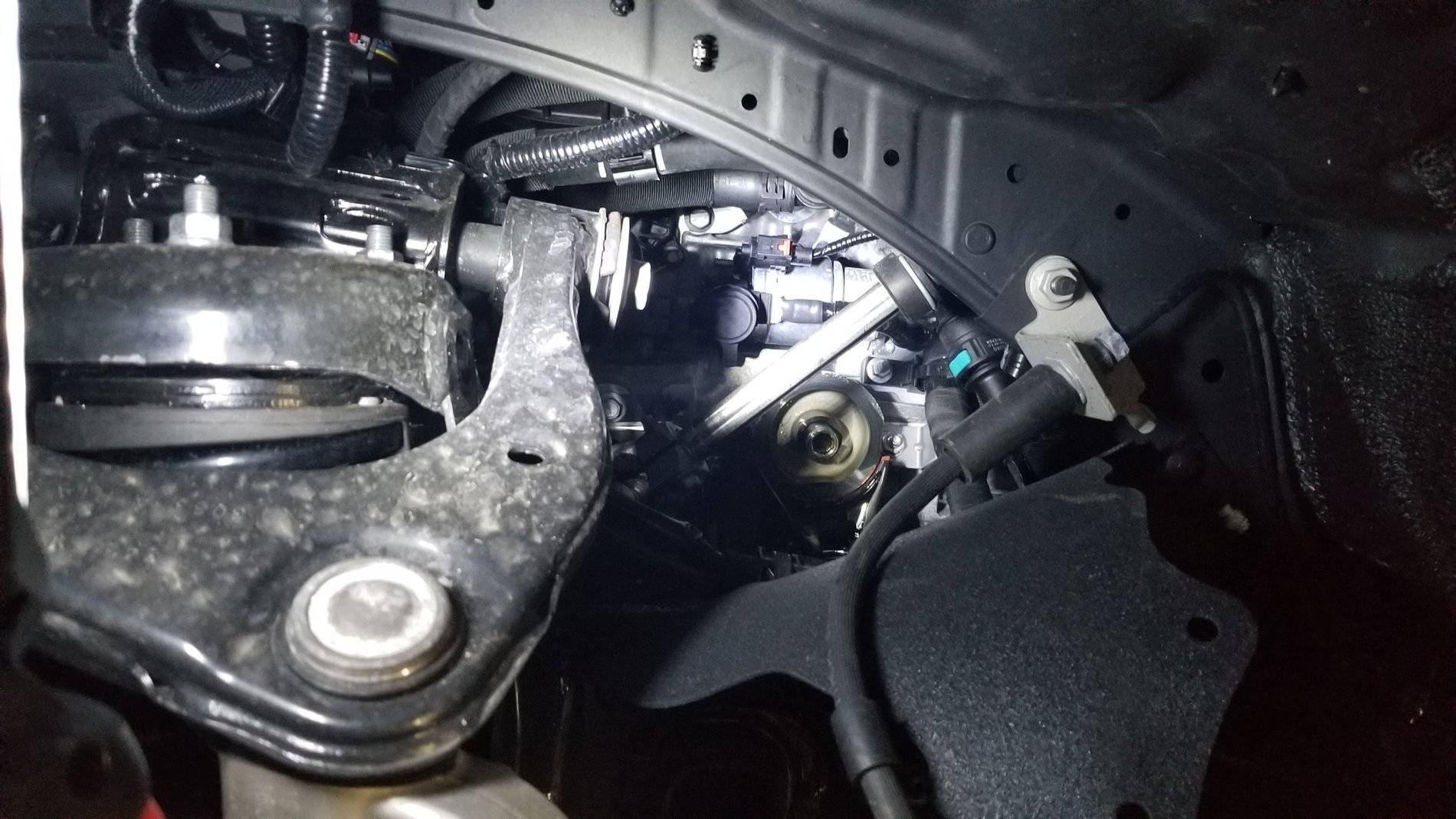

Zero reason to complain about the oil change. Even if I wasn't doing it on my lift it's still easy. The skid plate and flap is a complete non issue. Only thing of note is where to put the pan when you remove the filter. It's further back with the little drain flap. 15mm for the skid plate bolts and the drain plug.

Outstanding! Thanks for the info

Thanks for the pics from the oil change. Hitting the 1500 mile mark next week and I’m going to change oil/filter at the same time I go back through to recheck the torque on everything that was touched during the BDS lift install.

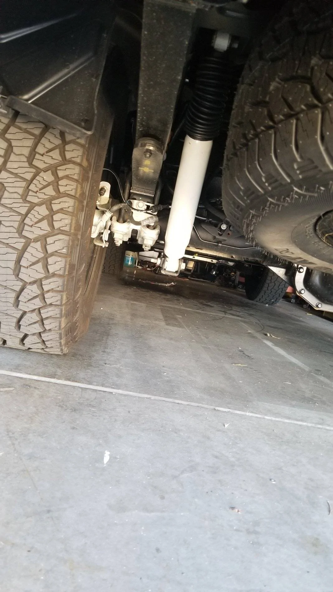

Installed a set of Fabtech rear shocks. Took away some of the stiffness compared to stock. It matches the front more now with the leveling kit. Not as jarring. FTS7265 and picked up a pair of Pro Comp shock boots as they don't come with any. 20 minute job max.
