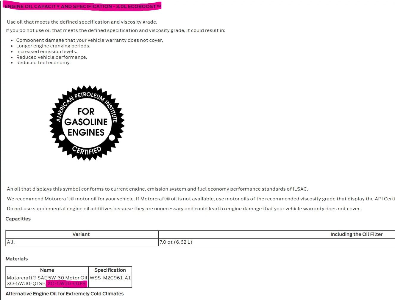

The owners manual also lists FS, so that is an invalid argument. The additive packages between Q1SP and Q1FS are nearly identical, that's now common practice in the industry. Valvoline did an engine test using two Ford 2.3L Ecoboost's from Explorers and ran them for several hundred k miles on their blend and then full synthetic.
Side by side, in parallel, to determine the differences. The cams, bearings etc. all looked good in both, so the anti-wear additive packages worked well in both the blend any full synthetic. BUT the blended oil had CONSIDERABLE sludging and MULTIPLE stuck piston rings, it also suffered more failures during testing that required repair than the Full Synthetic oil.
The chain tensioner was also frozen on the Ecoboost engine using the blend because of sludging. So the base oil purity MATTERS over longer timeframes, especially for engines that see hot environments, towing or hard use (WOT). If you do mostly highway driving at light loads, the blend is probably fine (average use cases), but for everythign else, Full Synthetics are much better under severe conditions and especially as the mileages pile on.
Testing Different Oils Over 4 Years and 1 Million Miles
This test took them 4 years, 500k miles per an engine! They do complete teardowns of each engine side by side. It is what it is, but shows there is a significant difference. On that same token, my buddy has a 2021 Escape ST with the 3.0L, he's used MC Blend since it was new, now at 130k miles, no mechanical issues, no oil consumption, runs it out to 10k mile intervals, but changes it on the dot and always is careful during warm-up (no WOT or heavy throttle til the oil / trans is up to temp).
Most of his driving is highway, not city. He plays around with it frequently but doesn't tow anything and normally only has 1 passenger, so lightly loaded. Blend worked fine, but he recently switched to FS to try and make it to 200k before any rebuilds after seeing the potential for sludging as the miles continue to pile on.

Read the owners manual .under certain conditions you need to change it more often . And guess what change intervals same no matter what you use . Of corse you guys know more about this than ford .
do as you please …..
Well, if you go by Ford's recommendation, you should change oil up to 10K miles or at least once a year. No professional mechanic thinks that's a good idea, no matter what the engineers say.
But since you trust Ford so much, just wait and do oil changes every 10K. Let us know when you engine fails.

Read the owners manual , what you are saying is not completely true . Also there are a number of other manufactures that recommend 10,000 mile oil changes also .
If you think ford is full of crap , them why did you buy one

I think it’s pretty clear we don’t accept “Ford sez so” as a convincing argument. We have offered arguments and examples of why we believe full synthetic and shorter OCIs are a good idea. If you’re just going to keep saying “Ford sez so,” then we have to just agree to disagree.
“Read the owners manual” is not persuasive to many of us because we have reasoned through the options and have reached a different conclusion than what the manual suggests.
