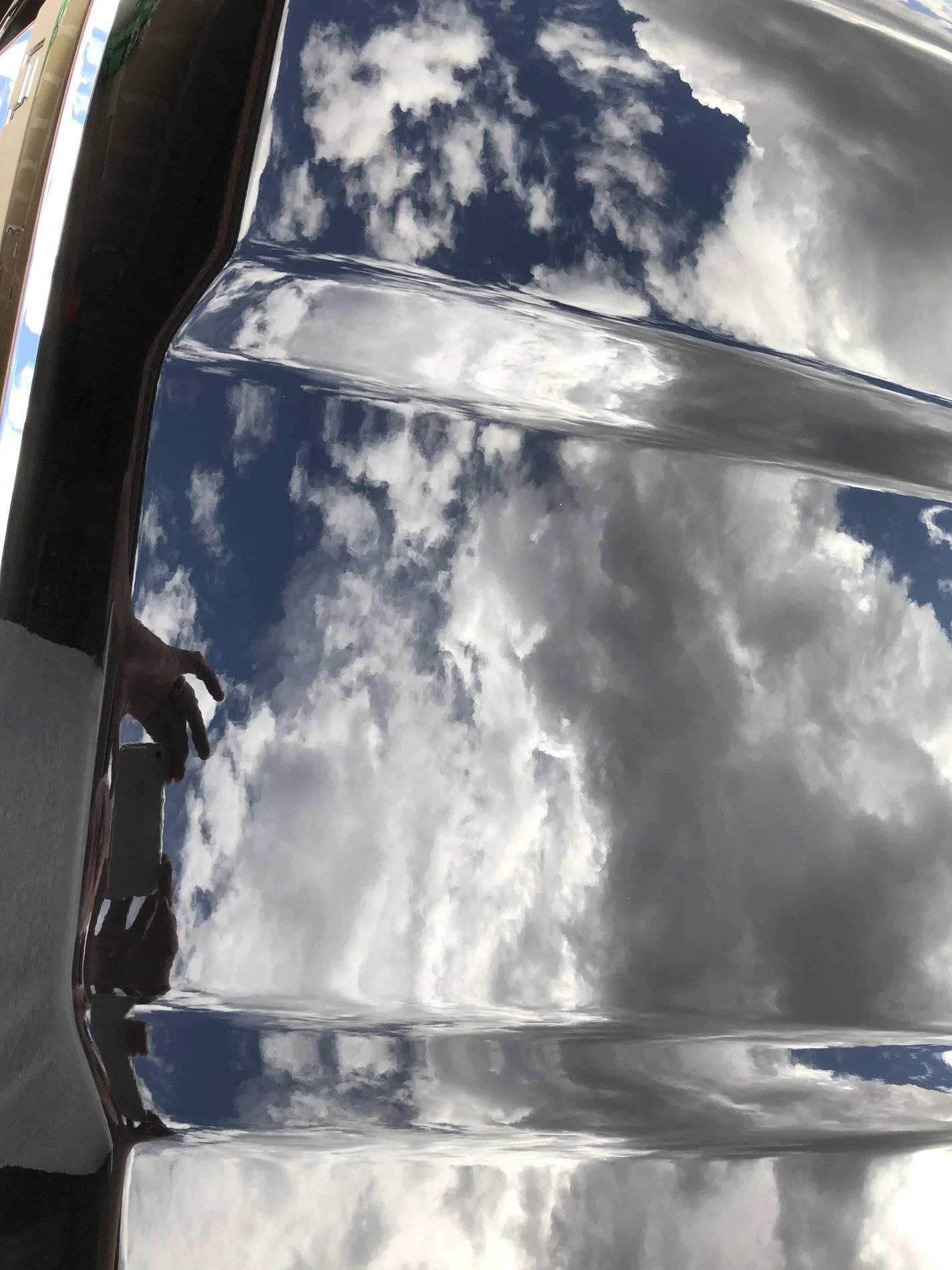

I did CQuartz UK 3.0 on my ranger the week I got it, just washed it really good and paint felt really smooth so didn't feel like introducing scratches by clay baring to stay my worry.
It went on super easy and the car beads water like literal magic, washing it off is as easy as grabbing a hose and a light microfiber.

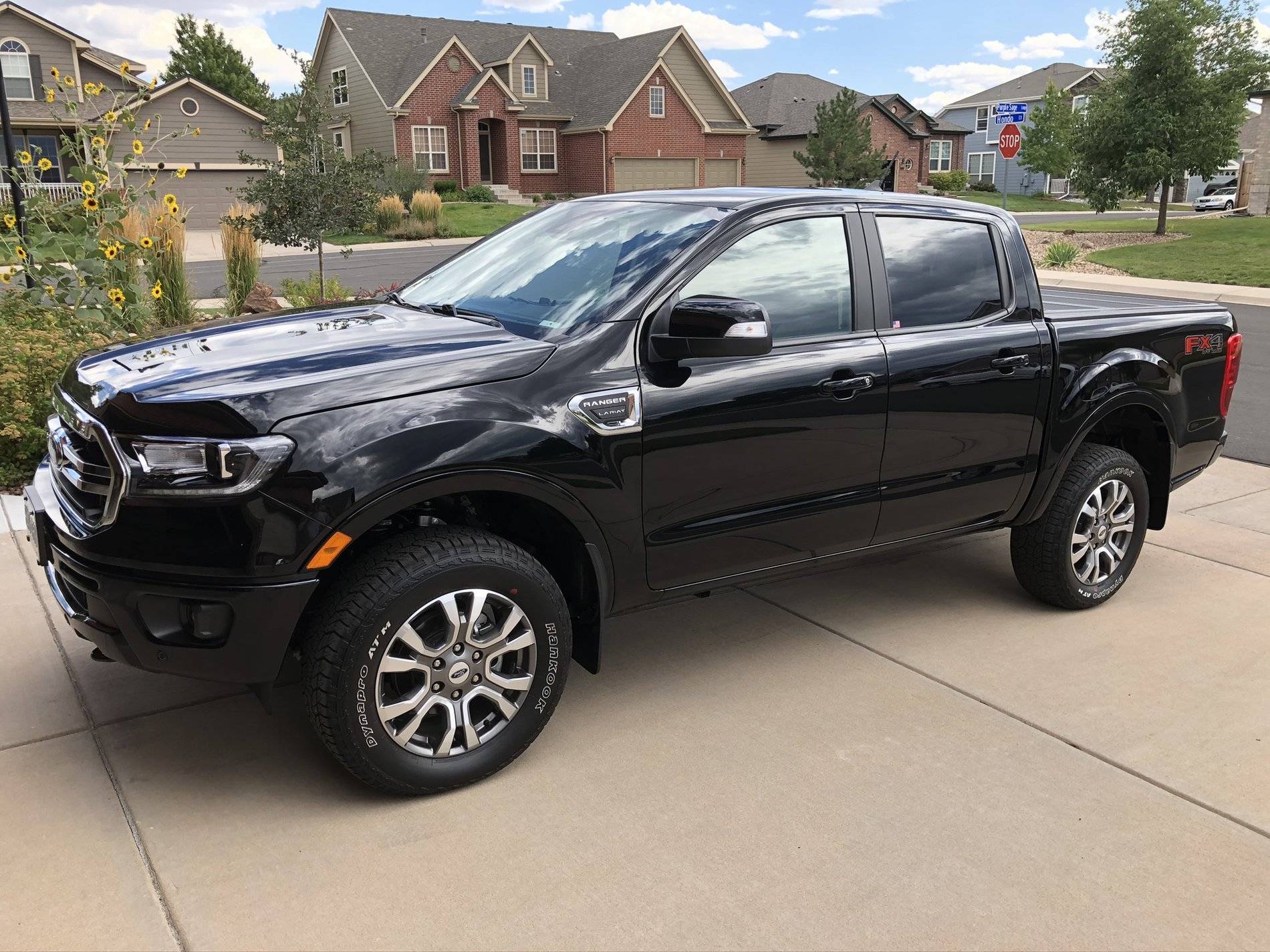

Clay bar followed by Meguiar's D301 finishing polish/wax is a great combination.
Will make the finish look almost too good to be on a truck.
