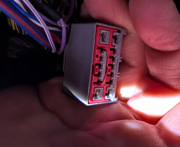

I'm going to be installing the Redarc, and I am near certain this is the trailer brake controller connector, as found on my 2025 XLT with just the basic tow package:
On the far left almost against the firewall. Ordering the Redarc TPH-007 and will report back on my experience.
FWIW that’s kind of where I recall the bare wires for the TBC being on my 2021 5G Ranger.
For those struggling to find the TBC wires in the cab, I’m curious if you’ve checked to see if there are all 7 wires going to the 7-pin connector in the back? If not, then probably a bad sign for finding the harness up front.
Thanks for the picture. Unfortunately, there is no plug for the 2026 without the TBC option. I went to a local trailer shop and they hard wired it into the wiring harness. It works great.

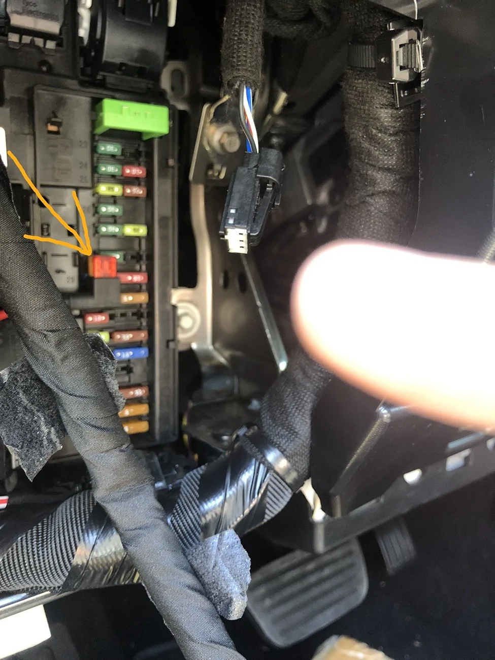

Hey Scotty, going through this discovery process as we speak...did you basically hard-confirm there's no plug then for the '26? That's disappointing if so...
I have the two package but no factory TBC, looking to add one without tapping into wires old school....you have a pic of how they installed yours?
Yep, no plug anywhere (disregard small connector shown). I had the dealer and a local trailer shop look at it thoroughly (pulled instrument panel and kick panels off). The trailer shop tapped into the fuse panel under the knee bolster with a two fuse connector (the original fuse and a added fuse for the TBC). They also ran a dedicated wire all of the way back to the 7 pin connector.
Definitely disappointed! 😔 Seems like the cleanest way to do it though (add a tap)....for the wire they ran back, did they just tap it into the 7 wire's brake wire? (Does that question make sense?) Where did they push it through a grommet to the outside?
