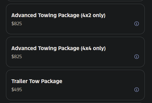

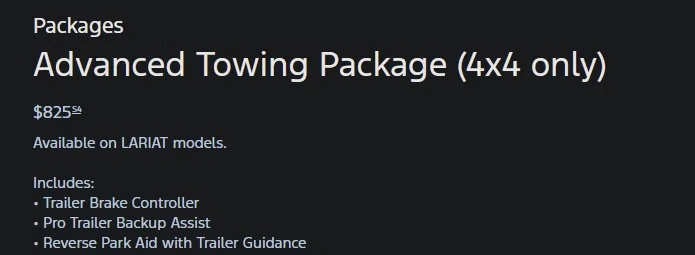

There are two optional towing packages: the Trailer Tow Package and the Advanced Towing Package
The Advanced Package is what comes with the trailer brake. The normal Trailer Tow Package only comes with the 4-pin/7-pin wiring harness and Class IV Trailer Hitch Receiver

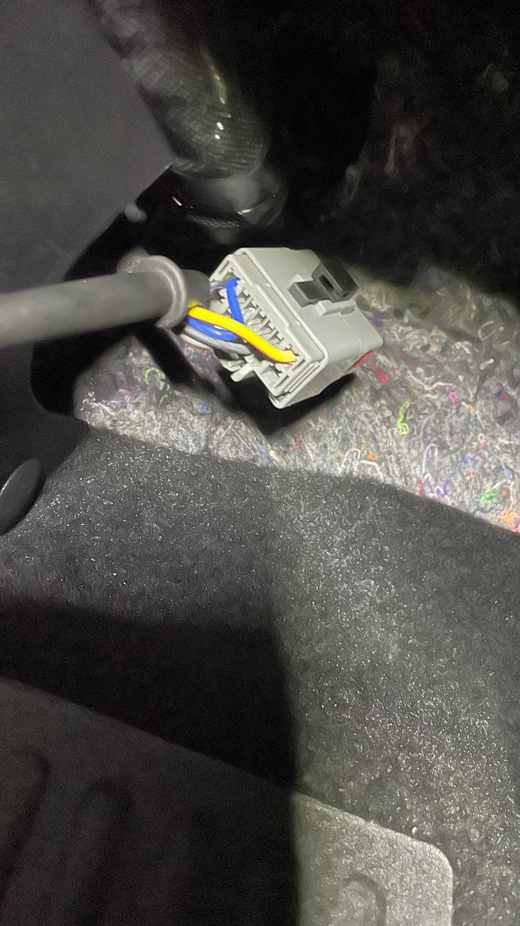

There are 2 levels of 'Tow Package'. The basic one does not come with a Traler Brake Controller from the factory, however we on this forum have discovered that there is a connector to the rear left of the Drivers foot well that will acept any of the aftermarket ones for the current Bronco. For liability reasons, i must tell you not to rely on this info from me as any garuntee that it will work in any way. Any install would be entirly at your own risk. However the 6G Ranger is based on the Bronco.
https://www.ranger6g.com/forum/thre...brake-controller-24-ranger.11415/#post-179966

I agree. With the 7 pin conn back there form the factory, you could be a Mom moving to another state, you'd just plug it in and resonably think your all good. I find it pretty objectionable considering the background it took of us here to delve the facts, and find a solution. A Lawyer, a 30 year electronics tech, and a super electronics guy with access to factory prints!

I mean, I'm ok with it, because i tinker with cars, and crawl under them, and don't mind tracing a wire, and scratching my head sometimes. Alot of peolpe just see these trucks as a device, like a Bigmac! I mean if you didn't know, and you had a Factory connector, your probably assume that all the pins worked, like everything else on the truck does. I can't think of anything else that you order from the factory that's incomplete. Honestly, at this point, it's pretty much been shown that the Redarc and Tekenosha Bronco TBCs will plug in and work. Include it or put a big red sticker some where. I know, i know, we have too many stupid stickers out there, BUT i think this is one instance where it might help. I'd prefer that they just add a Controller, in volume probably be like $75 bucks. raise the cost of the basic package. Valid complaint, I'd say.
