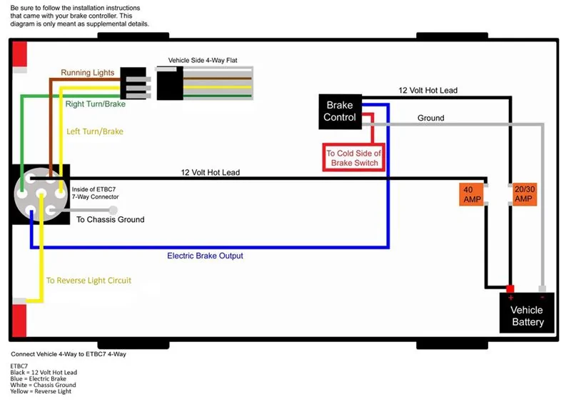

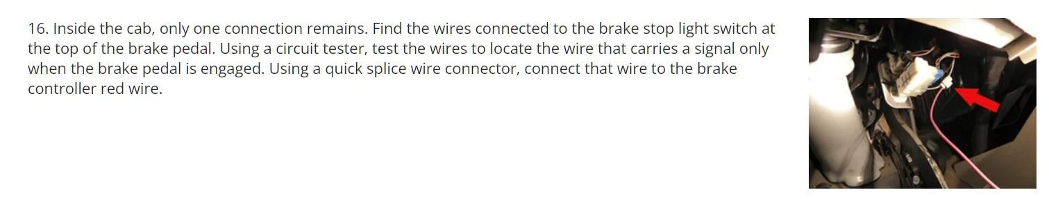

We discussed this before, but according to eTrailer, I need kit ETBC7 to convert 4-pin to 7-pin.
It also says to hook up the red wire from the TBC to the cold side of the brake switch. I think that will work for activating the TBC with the brake pedal, but won't work for the AEB. Remember, though, there was no AEB in the past and people were fine towing.
At this point, I just want to add a hitch receiver and 7 pin. The TBC can come later. If I do, and Ford, eTrailer or Curt haven't found a simple solution, I will get the kit made for 19-23 Rangers (VKB3Z2C006A ) as it has a method to get the signal from the CHMSL to trigger the TBC in AEB situations. I wouldn't hook up the TBC directly to the CHMSL, as that might cause weird stuff to happen.

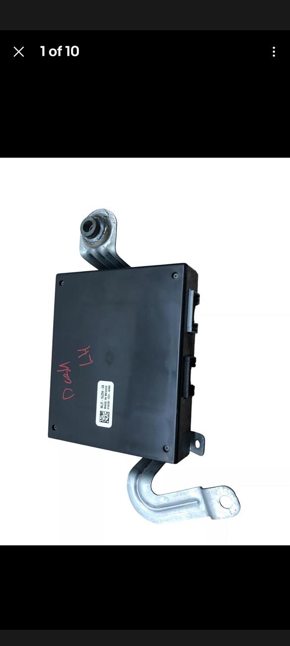

This should be the factory trailer brake module needed. It appearsyou with need 2 small harnesses, the controller and the bezel for the factory look and operation.
what your calling the Trailer brake module, is what my truck is caling the trailer control module when I look at modules in forscan.(screenshot trying to attach) ill have to look in the easy configuration and see if the trailer brake is enabled already.
i've looked, but I havent changed anything yet. ill wait till after ford installs the trailer brake switch and that. but based on your post, and others. all I need is the dash trim, switch, and to hook into that capped off plug under the trm.

So I managed to find part numbers for the tbc dash switch and the trim piece. Im just looking for rhe harness to go from tbc to the capped off plug we got under the trm. maybe we can get the 2 connectors and make our own harness, then use forscan to turn on all the trailer brake stuff? I looked in forscan the other day, and there are a bunch of trailer brake settings in 2 or 3 different modules in the non asbuilt programming on my 25 xlt, including forscan saying the brake control module is present. maybe mine also got the itbc wires behind the dash. ill have to look, but it does have the plug under the trm
if anyone can look up the wiring pin out of the itbc that can tell us if we can make our own harness or not. I think I also found the pigtail harness that comnects to the capped off plug under dash for tbc's.

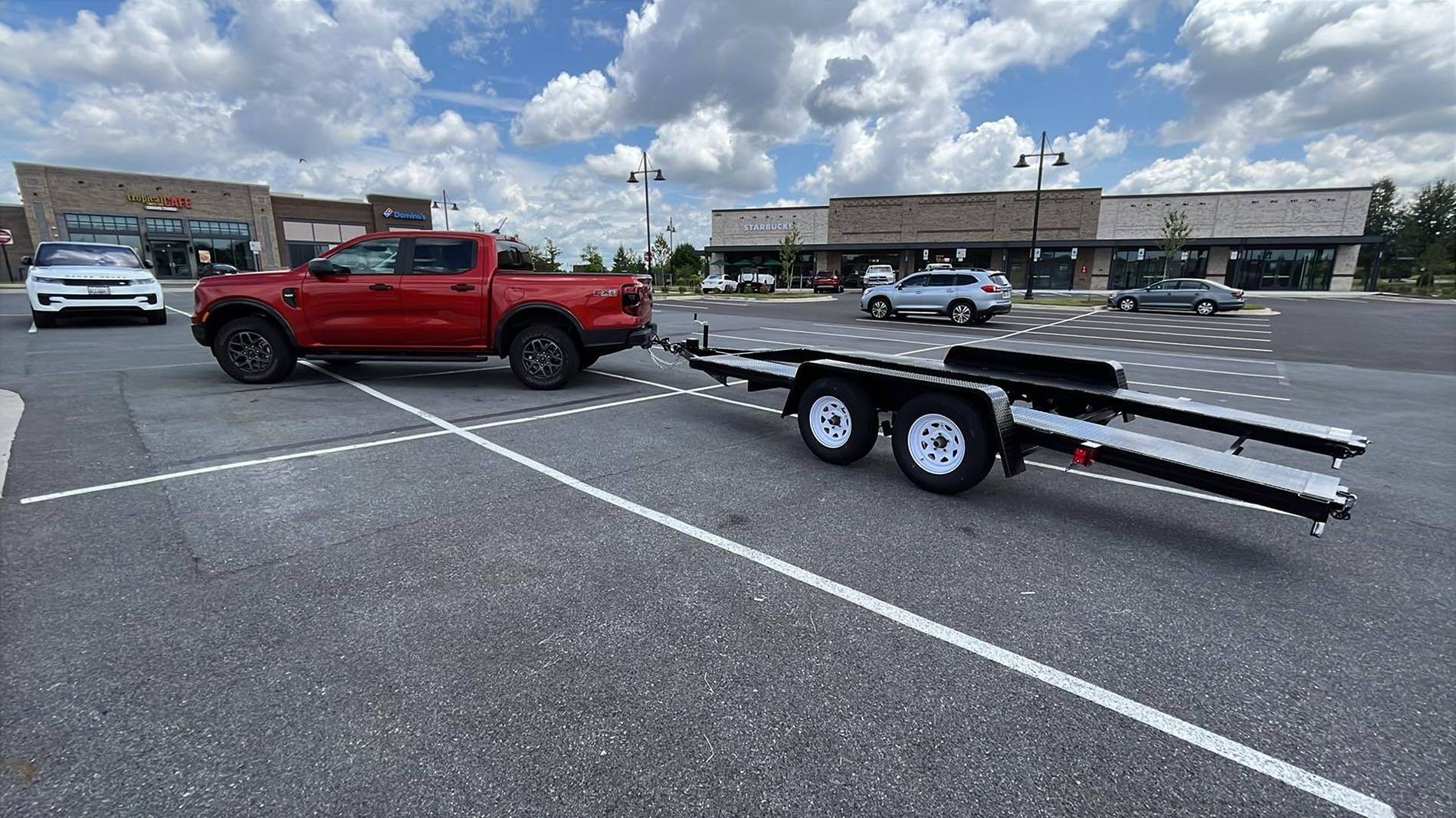

Ford Ranger wires for trailer brake controller '24 Ranger? IMG_1744
Happy to report that the Redarc trailer brake controller I installed back in January works with my new trailer.
