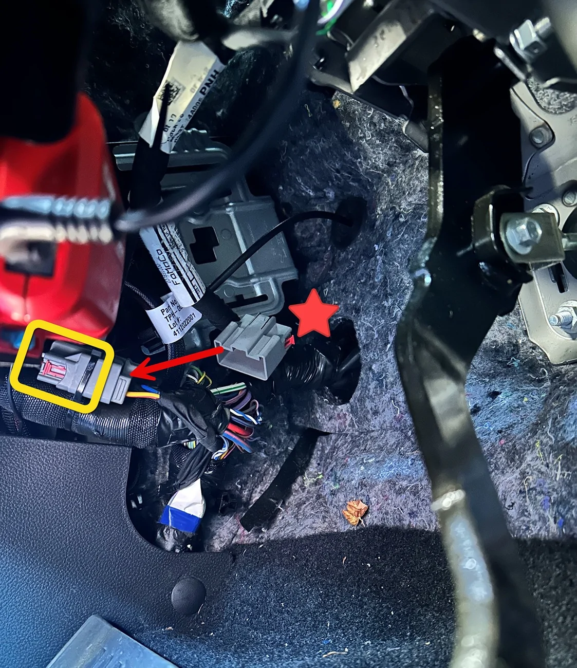

This is interesting.... I definitely have the non-tow package (which I think lacks the TRM) and there is indeed a connector that accepts the RedArc brake controller wire harness. The connector has a "cover" on it and it is tucked up along the left footwell, zip tied to a large wire bundle near the firewall. See the picture below: The RED STAR is the "cover", the RED ARROW points to the connector in question. The YELLOW square shows female end of the RedArc harness.

let me add a little knowledge from earlier in the thread. The basic tow package trucks have a module that feeds everything needed in the seven pin connector. There's also a connector that you can plug into a aftermarket like ared arc made for the bronco which will give you a trailer break signal. A trailer brake controller. for non-tow package trucks, that seven pin module is not there. There is a more basic one for the four pin also, it seemed that the gray connector which would feed the trailer brake controller was there, which has power, ground, break on off and output to the seven pin. Everything was functional except the brake on off signal which comes from the body control Module was not active on the non-tow package equip trucks. The workaround was to tap the high amount of stoplight, which was done on the previous model as well,. That would give you your brake on off, signal under normal conditions and automatic emergency breaking. However, as yet I haven't seen the high mounted stoplight, tested under automatic emergency breaking. It can be done easily. Very slowly backing up towards a soft object like a bush with automatic emergency breaking on while not touching the brake pedal. The truck will automatically break and you can see if that light goes on. Now the 2025 had an option for the stock trailer brake controller without the advanced tow package. I'm not sure how well that would integrate into a 2024 but that also doesn't help the non-tow package equipment trucks. As far as I know, though even the non-tow package equiped trucks had that Connector for the trailer brake controller, even though the BOO signal is not active.
I can confirm this is accurate. I have the non-tow package and needed to tap into the center-high mounted brake light signal to get the BOO. Once this was done, the RedArc works brilliantly.
