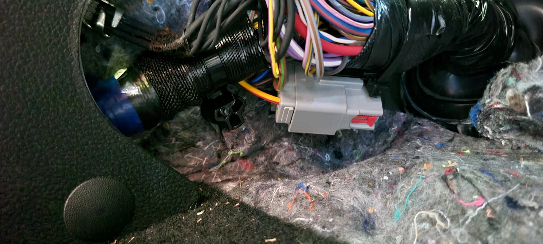

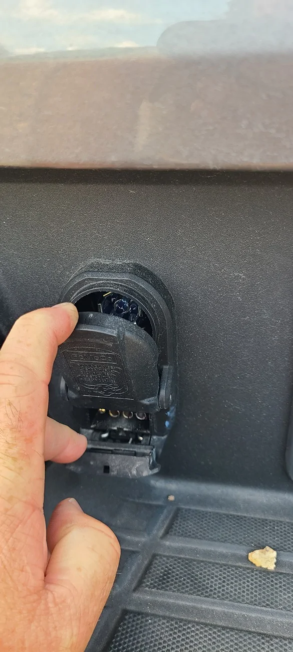

Looking more closely at your photo against what I have, I do not have that grey plug. This is incredibly discouraging. I have some poor reference photos from kickplate region and rear bumper wiring as well, wondering if I am essentially bricked to 3000lbs with my STX.
Even though you can't see it well in the 3rd and 4th photos, there are 8 wires coming into that rear harness and theres a blue and violet back there so I THINK that could carry a 7 pin.. but the front is less encouraging.

This is interesting.... I definitely have the non-tow package (which I think lacks the TRM) and there is indeed a connector that accepts the RedArc brake controller wire harness. The connector has a "cover" on it and it is tucked up along the left footwell, zip tied to a large wire bundle near the firewall. See the picture below: The RED STAR is the "cover", the RED ARROW points to the connector in question. The YELLOW square shows female end of the RedArc harness.
First, the disclaimer: Consult with Ford before making any modifications. I DO NOT recommend you use this information to modify your vehicle in any way. You've been warned.
I don't think you are "bricked at 3000-lbs" but it might take a little more "effort" to make the connections to the trailer brake controller, meaning, wires will need to be spliced. But, proceed with caution; don't void warranties! I'd recommend chatting with your Ford service department (hopefully they are nicer than the ones by me) then maybe a visit to a reputable trailer sales and service center for a consultation.
In its simplest form, adding a brake controller is 4 wires (power, ground, vehicle brake signal input and trailer brake signal output). Cars are rolling computers these days.... sensors are everywhere, CAN buses control fancy LEDs... messing with "simple" trailer wiring gets more complicated and the risk of shorting out other equipment is real!

And so it was for 2019 Ranger XL. They didn't have the wiring up front to add a TBC or 7-pin. Only 2019 XLT and higher had it. IIRC, they changed it in 2020 or 2021 so that all Rangers had the wiring.
Your options are this Brake Controller 7- and 4-Way Installation Kit (ETBC7) | etrailer.com
or this 2024 Ford Ranger Curt T-Connector Vehicle Wiring Harness with 7-Way Trailer Connector
along with one of these 2024 Ford Ranger Brake Controller | etrailer.com

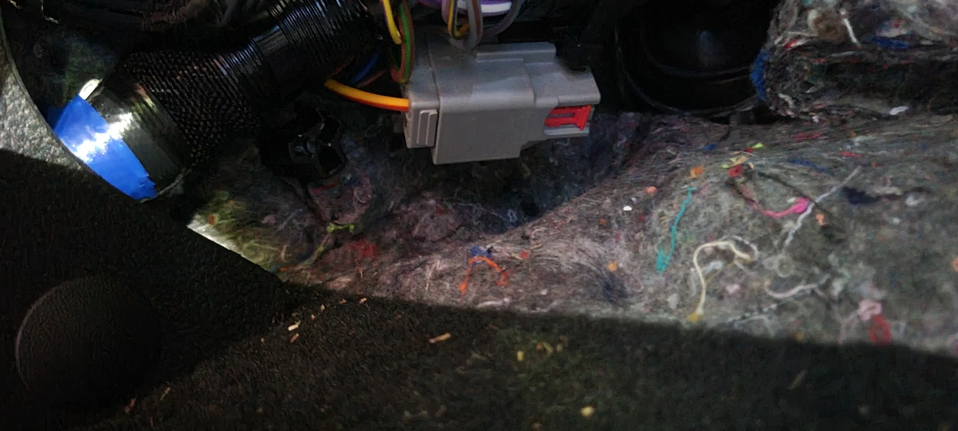

Does your STX have the gray plug by the firewall in the cab?

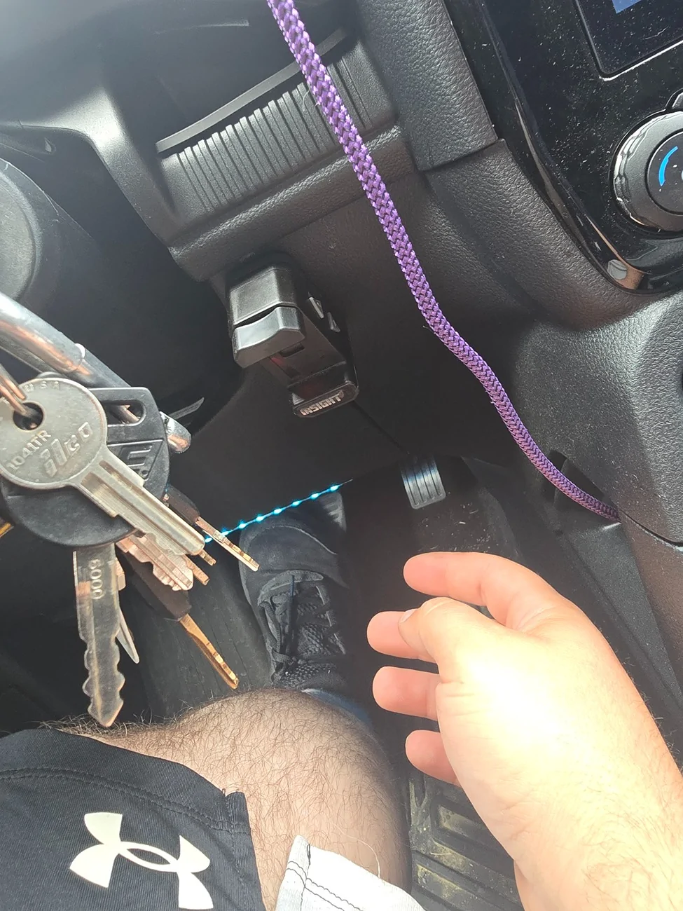

I looked under my the left side of the driver foot well and this is the only grey plug i can see easily.

Looks like you got it. I am the lone star here with an STX no tow package and no gray plug. Literally the worst combo.
