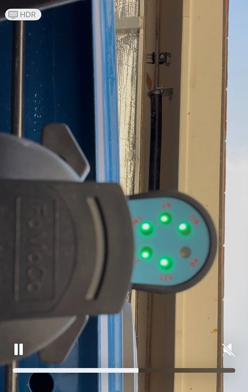

Ok, more advice needed.
I ordered a tester to test and confirm that the installation is working as expected. However, I do not see the brake controller light go on with the tester. All other lights (12v, ignition, LT/Brk, RT/Brk, backup) function as expected. When I first connect the tester, before I insert the key in the ignition, the BK controller light flickers on/off weakly. Once I insert the key, it stops flickering.
I see the blue light on the controller knob when I push the button on it. So it is getting power for sure.
Any ideas? Have any of you tested to confirm you are getting the brake controller signal at the 7 pin plug?
Please let me know.
Thanks.

Someone said that those testers don't work well on our vehicles. There's not enough load on the circuits so that the ECU detects that a trailer is connected, thus doesn't activate the trailer functions properly. But you can verify if that's correct. Did the vehicle indicate 'Trailer Connected" when you inserted the tester?
Thanks for this. I drove around with the tester connected to the 7 pin plug, but the truck still says “no trailer detected”. So what you’re saying makes sense.

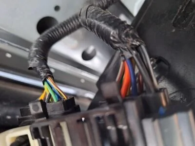

I peeked under the bumper yesterday. There is a connector with all wires for the 7-pin. Currently, the output connector has only the wires for the 4-pin coming out of it, white, brown. green, and yellow. Those 4 wires are wrapped up in the harness that feeds the plate lights and reverse sensors in the bumper. Probably no luck from Ford to provide just the trailer wire harness, as it's part of another assembly.

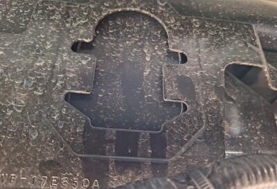

There is also a cutout in the bumper bracket that looks like it would hold a 7-pin.

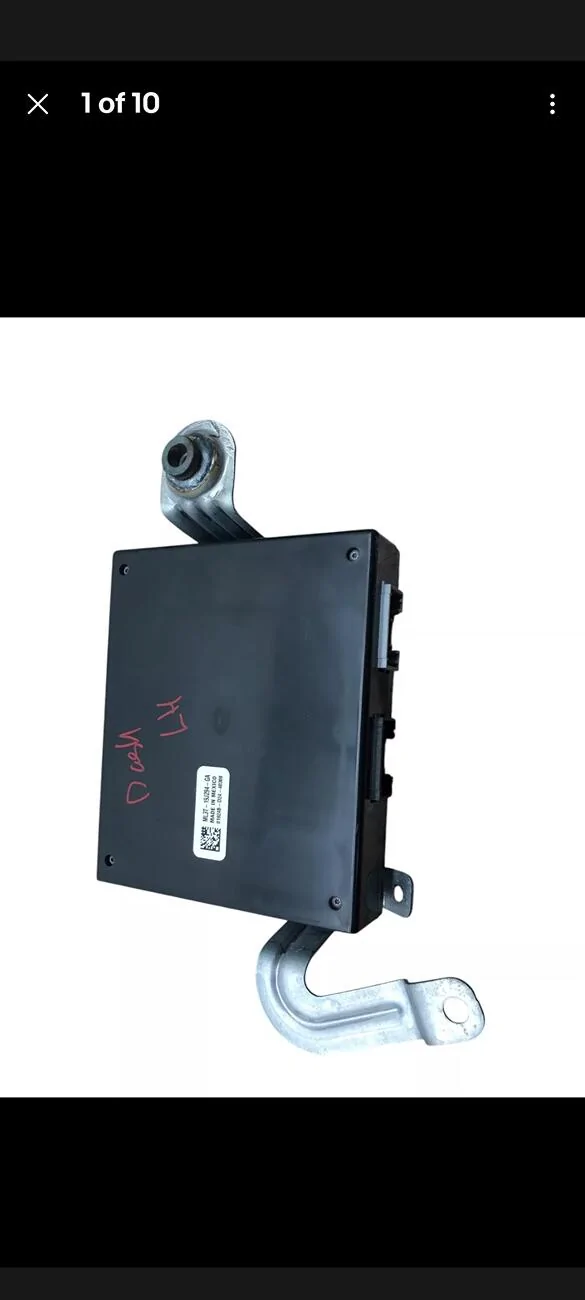

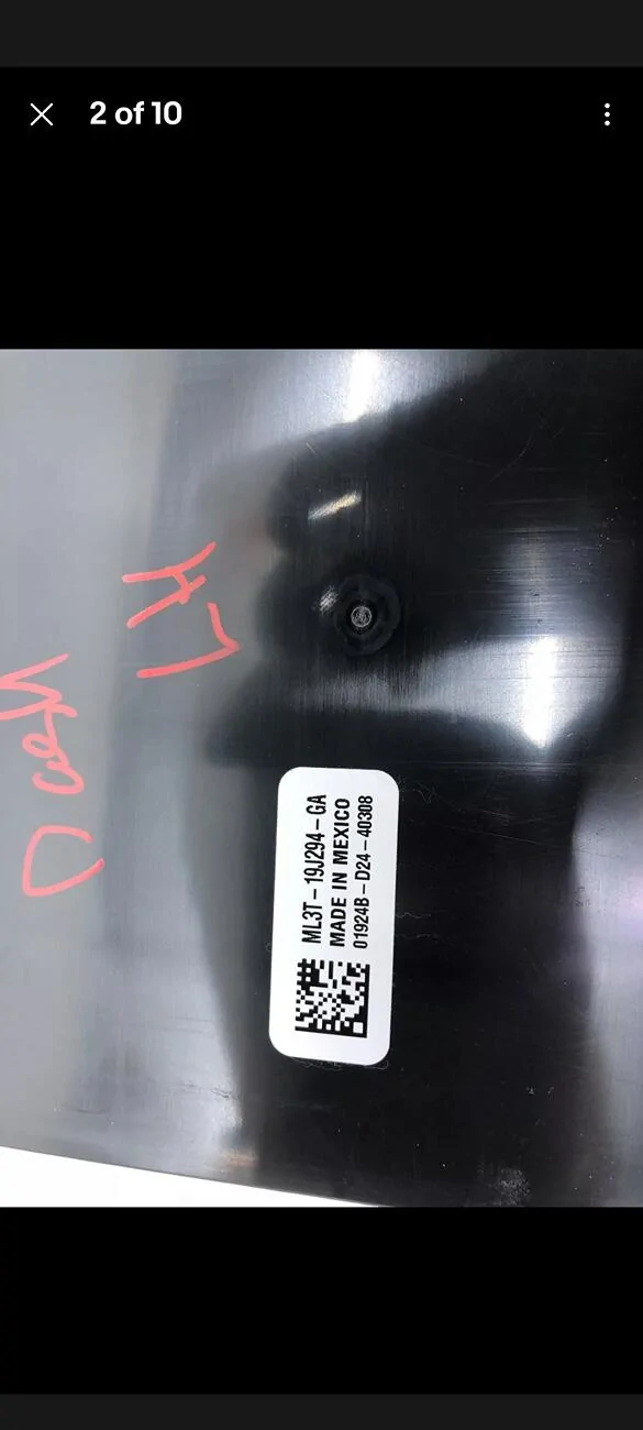

Is there anything stopping us from getting one of these and self-installing? I can't find the part on the major supply sites but found a few used. If the no-tow package units still have 7-pin wiring, does that mean the TRM module could plug-n-play? Other than harness compatibility, there is the question if you can even flash the unit once installed, or if it will fail to be recognized by its parent module? Haven't found any examples on here yet of someone taking this step. If not, I may take the leap to test but may need some insight from the hive mind on the flashing process, if even possible without a dealer.
This should be the factory trailer brake module needed. It appearsyou with need 2 small harnesses, the controller and the bezel for the factory look and operation.
