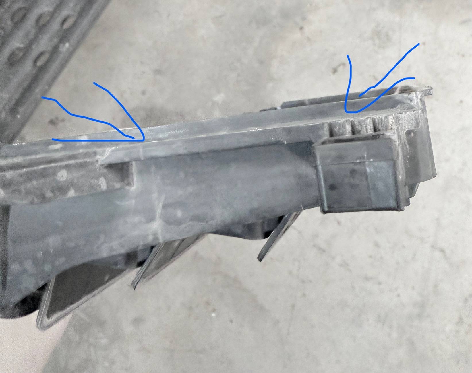

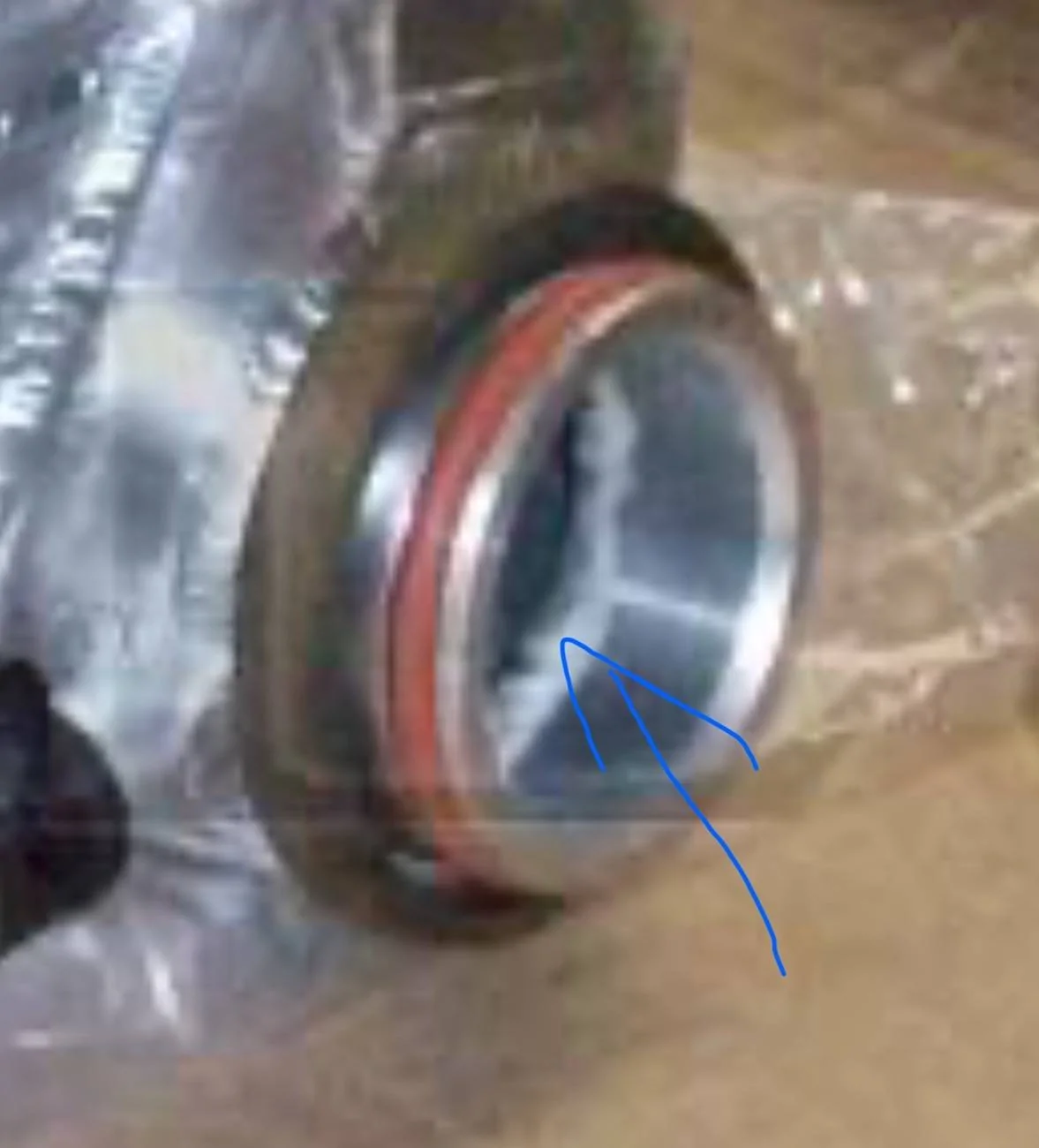

EDIT: I was annoyed I didn’t take good pictures of the charge pipe retaining clips. While reading the Cobb intercooler instructions, i discovered they had excellent pictures. I have attached them below.
Ford Ranger Wagner Intercooler Installation DIY How-To for 2024 Ranger Raptor IMG_2291
Note the blue arrows indicating the dimples in the clip opposite the open side. These dimples can be pushed out of their grooves and onto the surface of the charge pipe retaining clips connector, holding the clip open. Both must be pushed at the same time or it will snap back closed.

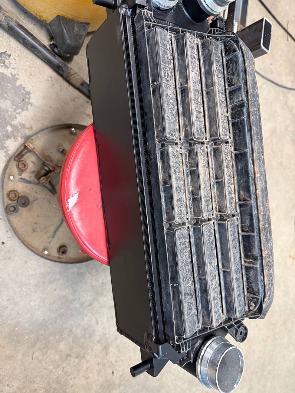

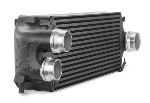

Side by side comparison of factory and wagner intercooler:
Ford Ranger Wagner Intercooler Installation DIY How-To for 2024 Ranger Raptor IMG_2195
Ford Ranger Wagner Intercooler Installation DIY How-To for 2024 Ranger Raptor IMG_2194
Step Six: Trim the rear louver assembly to fit the wagner intercooler. The lip that extends on the intercooler side of the mounting tabs needs to be cut off flush. It extends across the bottom of the louvers and up both sides. Arrows point to removal area.
Ford Ranger Wagner Intercooler Installation DIY How-To for 2024 Ranger Raptor IMG_2196
Ford Ranger Wagner Intercooler Installation DIY How-To for 2024 Ranger Raptor IMG_2197
I intended to use a dremel with plastic cutoff wheel for the removal, but after looking at the bottom thickness, chose to use an oscillating belt sander.

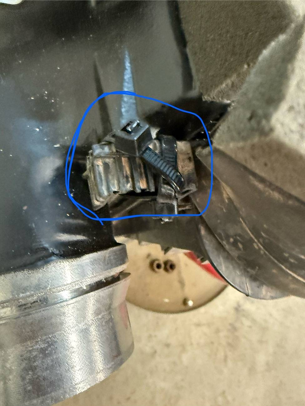

Step Sixteen: Install factory charge pipes onto Wagner intercooler, and engage factory wire retaining clips.

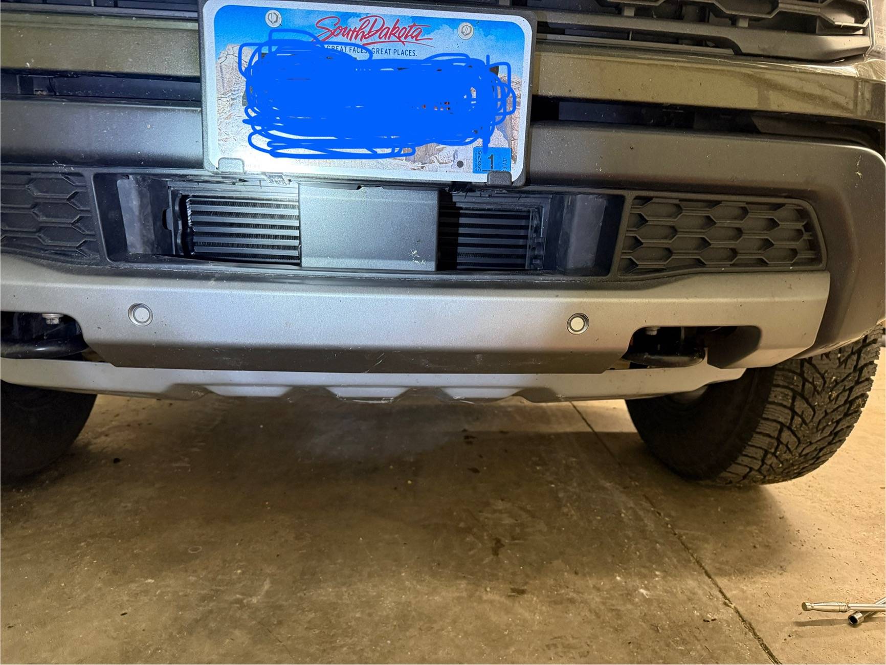

Step Eighteen: Reattach christmas tree wire retainer on front louvers assembly. Plug in louver motor and engage plug retainer.
Step Nineteen: Slide intercooler forward into position and install factory upper mount bolts (13mm wrench). As during removal, I used a ratcheting wrench due to tight confines.
Note: Front louver assembly no longer secures with top bolts. It is plenty secure wedged in place between bumper and intercooler, plus the two lower bolts.

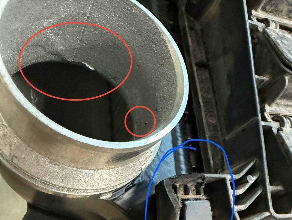

I have a general question, is the rough “as cast” inside surface normal for an aftermarket part? The main internal cavities of the end caps would have to be done at the factory, before the welding process, but it seems like the inlet and outlet pipes should be ported by hand at least a little, to smooth out the airflow. Or does it even matter in the real world? I would have dressed out that passage, removing the bigger lumps and pimples at least. The Wagner pic doesn’t really show the inside, but it does give the impression that it is a fairly even surface inside… Comments?

Yes, normal for aftermarket part. Nothing shows up ported unless you pay for it to be.
No, in my opinion it makes no difference. An as-cast surface for a few inches of the charge piping is minimal compared to the length of the intake and all the 90* corners involved. Plus, this is post turbo. Boosted air flow is much less sensitive to minor friction than pre-turbo under vacuum.
Yes, you could port it if you wanted to, will cause no problems. Just make sure you flush it thoroughly to remove all contaminants afterward.
If you take your intake off, i hate to inform you that ford did not clean up the head ports either. Or the intake, though the plastic composite is much smoother as cast than aluminum.

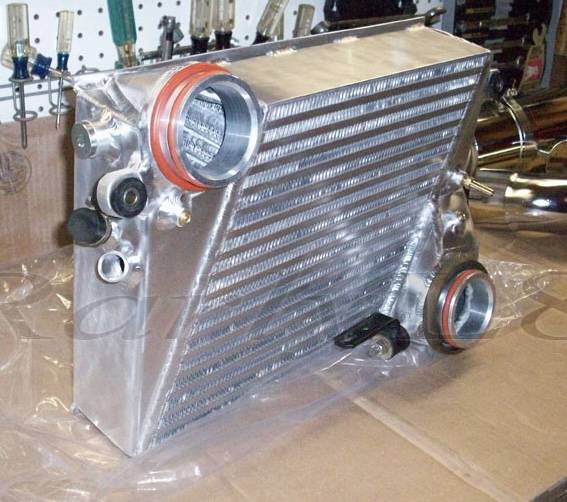

Thanks for the comments, I did see this one for Porsche and it got me wondering.., but it is also $1700.

That appears to be a fabricated unit, so there was never a cast surface inside the pipes. Notice they didn’t clean up the weld visible on the far side pipe.
Ford Ranger Wagner Intercooler Installation DIY How-To for 2024 Ranger Raptor IMG_2283
Between a fabricated unit and the word “Porsche”, I’m scared of what that costs. I’m betting not $600.
EDIT: I see you got me with the cost edited in to yours. Actually much cheaper than I expected. ?
