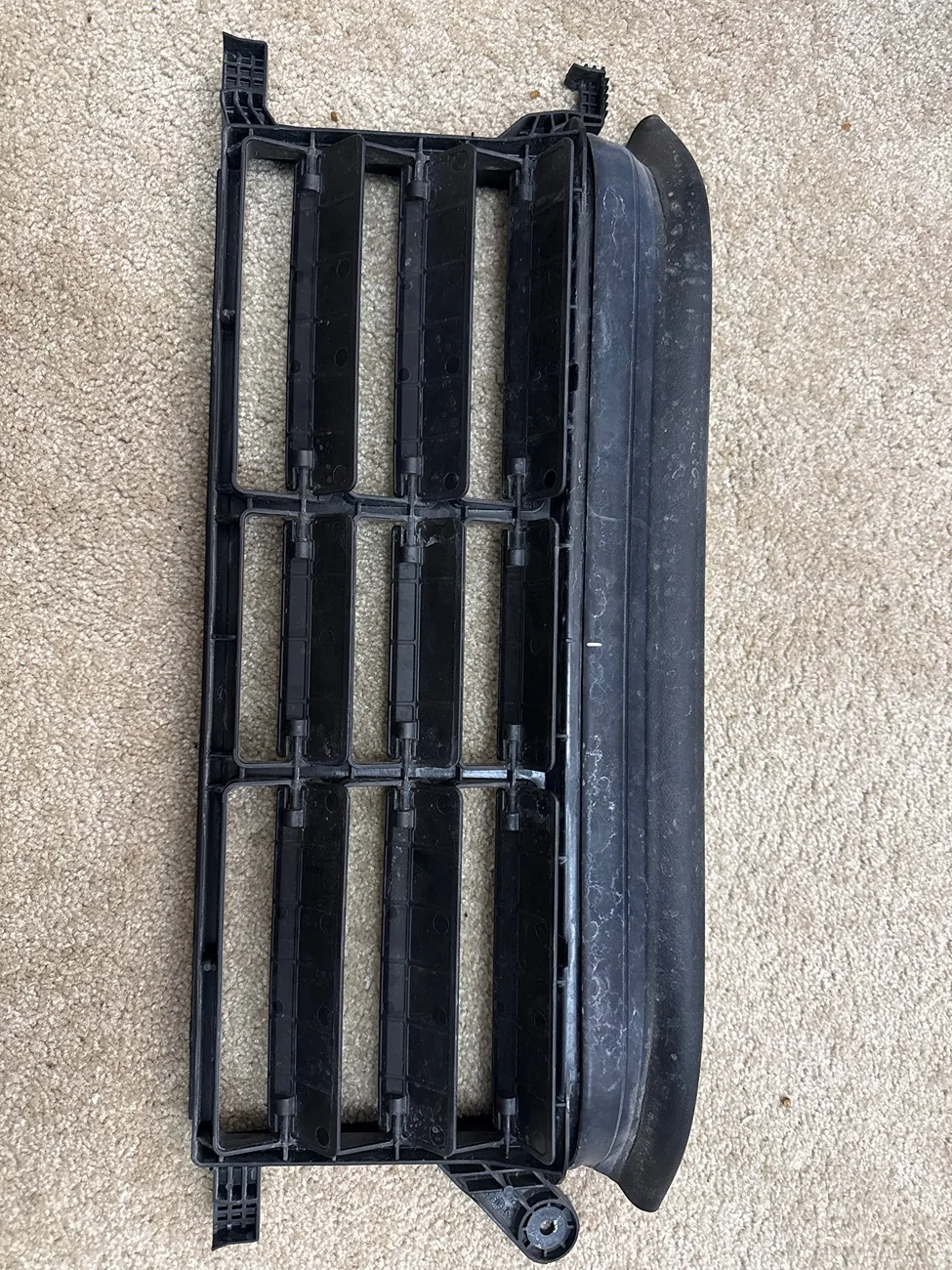

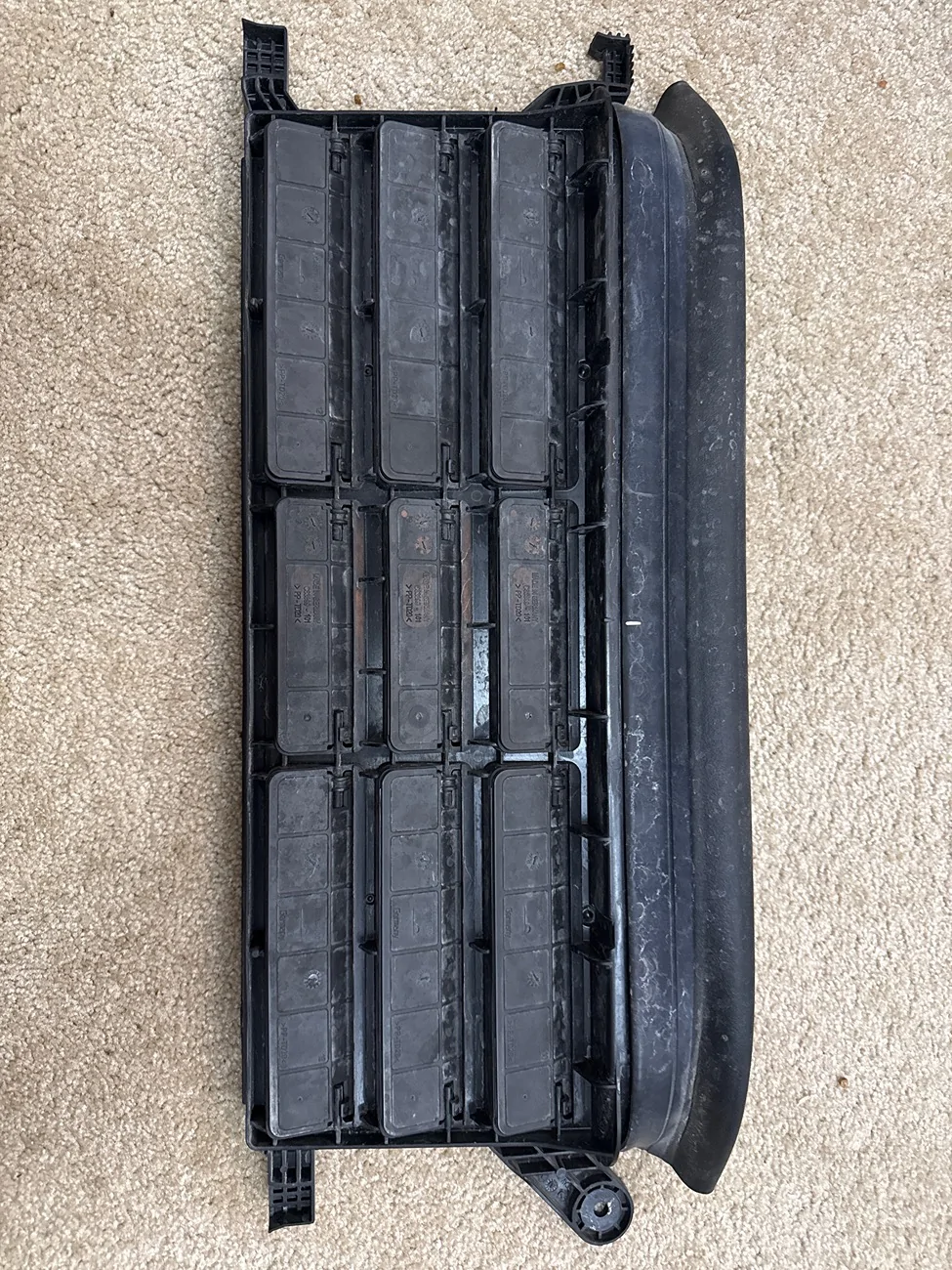

Ok I have read thru the entire Thread and have not found out what I am about to ask. Has anyone just taken off the Louvers on the backside of the stock IC? It really is simple. Pull the outlet pipe of the IC and there is one 10mm screw/bolt to take out and take it off. That’s it. Of course you got to put the hose/pipe back on.

Gravity hold the louvers closed with no air flow. They can be taken off without removing the housing also. The effect if any may not be noticeable at all. I have the FP Tune and have not driven it yet to see if I can tell a change happened.

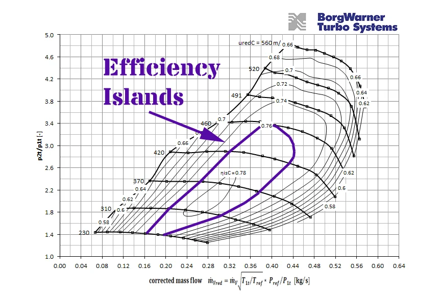

Your twin turbo truck pulls in air, compresses it, which makes it hotter, then runs it through the intercooler (like a radiator) to try and cool it back down before it goes into the throttle body, mixes with air/fuel, combusts, then leaves.

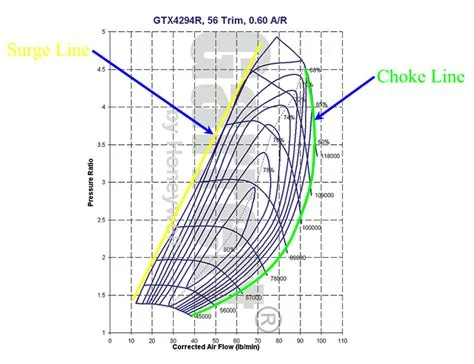

Adding to this, the other side of the coin is that the ECU will increase boost pressure to compensate for heat to achieve a target air density. Air density is related to pressure and temperature. If the temp rises, you can pump in more air at a higher pressure to achieve the same density.
HOWEVER, there's a catch to that. Your driving the turbo's harder and more out of their efficiency range. So your working the turbo's harder to achieve the targeted air density. I have a bit of a working theory that a higher performance intercooler could extend the service life of the turbos' by reducing the peak pressure needed to achieve the target air density at WOT.
The reason is pretty simple, if the IC is transferring more heat from the compressed air than the factory unit while maintaining a similar or better pressure drop, then the ECU is not going to command as much boost / flow form the waste gates to achieve the optimal air density post IC, which means they are staying closer in on their efficiency curve where there is less compressor losses = less back pressure and thermal wase.
Ford Ranger Ranger Raptor Intercooler List Thread 1776168774171-59
Ford Ranger Ranger Raptor Intercooler List Thread 1776168522695-lt
You want to stay within the efficiency islands as much as possible. Now I would imagine the stock ECU mapping or the FP ECU mapping is taking all this into account, so I'm not saying Ford is pushing the turbo's way outside their efficiency islands, BUT, that doesn't mean you can't improve upon it with a more efficient IC.
As noted, you're not going to make MORE power. Rather you will make more EFFICENT and CONSISTENT power, especially in hot weather where the higher performing IC has more thermal capacity margine. Technically you're also off-loading the radiator a bit as well since the turbo's have a water jacket. The bearings are oil lubricated and oil cooled, the housing is water jacket cooled.
The best way to make more power is by efficiency. Sometimes you can get away with old school more bigger, better aka the hot rod method. It works, but often there are substantial trade-offs in efficiency at the cost of increased heat (more rapid part failures, less operating margin) and lower fuel efficiency, sometimes also drivability characteristics that are non-ideal.

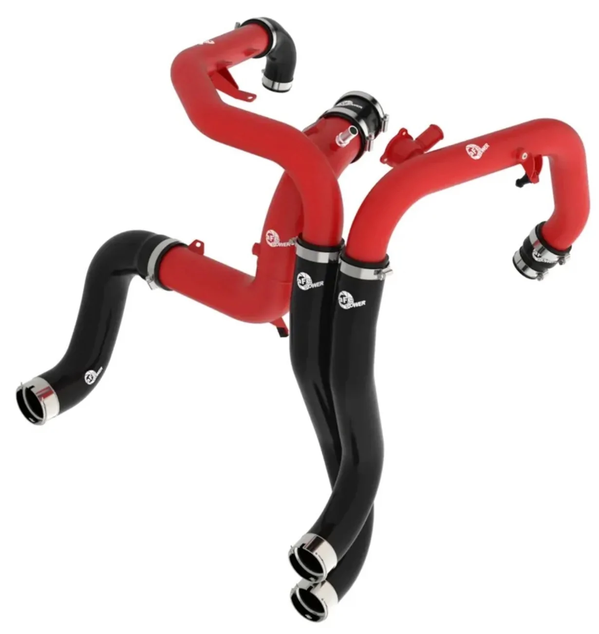

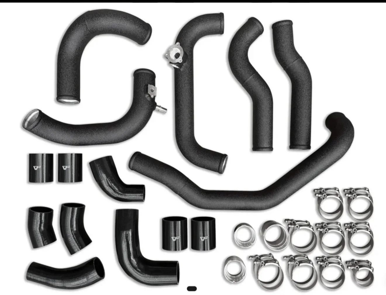

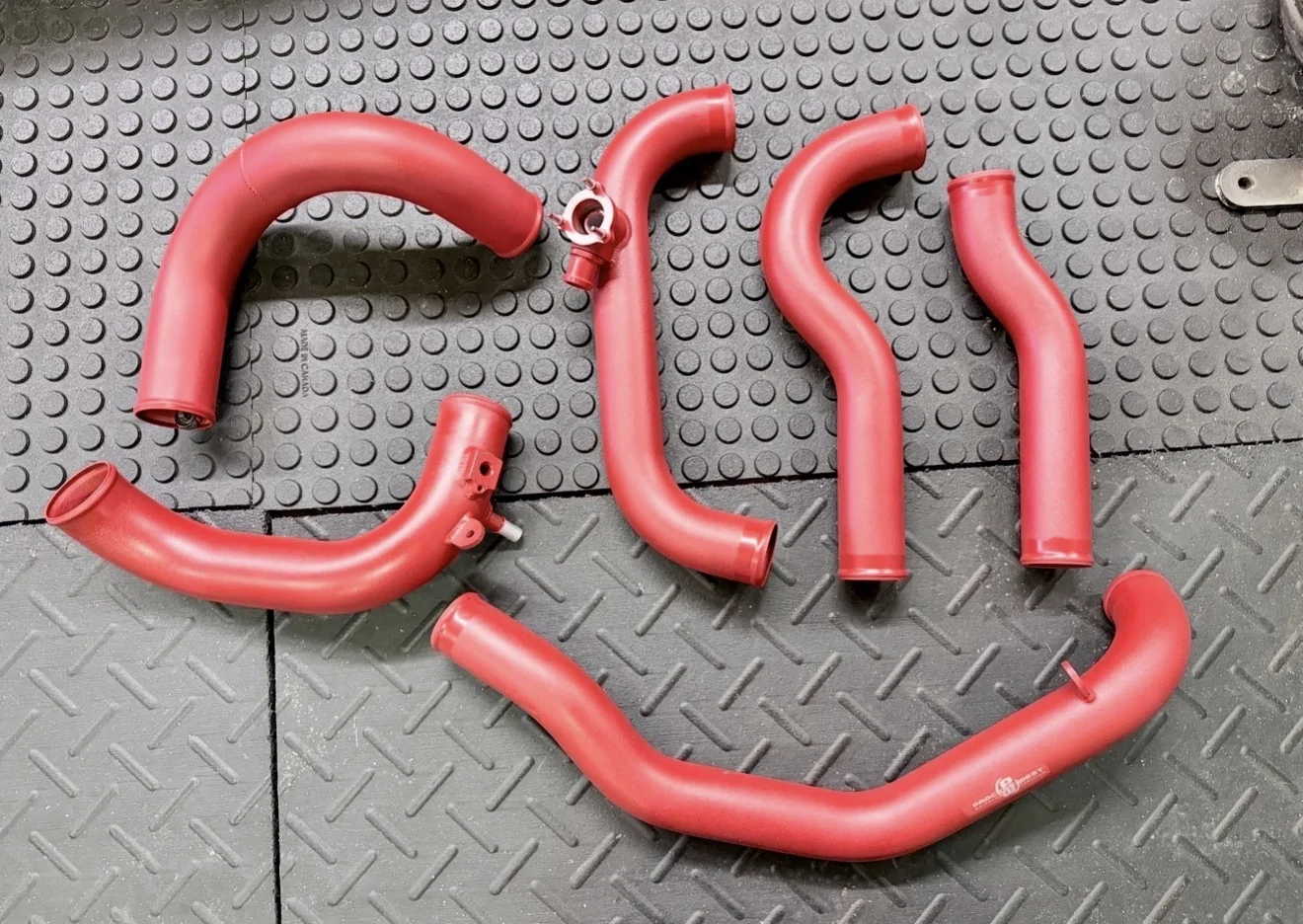

Not to beat a dead horse here, but also considering some upgrades with the IC & pipes.
Based on looking through this forum, top 3 ICs are cobb, turbosmart, & Wagner. Cobb and turbosmart seem pretty similar in price and install... Wagner retains the rear shutter shroud but needs cutting and some miscellaneous trimming... anyone have some hard opinions on turbosmart or cobb?
Also, does anyone find value with changing charge pipes? Ive only seen CVF and AFE, any other considerations? Pricing between the 2 is a few hundred bucks.. any have a preference?
Chris
I'm still undecided on keeping the CVF. In your shoes, and depending on the budget, I'd recommend Turbosmart. But it's all about what's important to you.
Pipes I want to do, and was leaning towards CVF. After my experience with the CVF IC I'll probably go AFE. That being said the price of CVF pipes and IC isn't all that much more than just a Turbosmart IC. From a cost perspective CVF products are in the lead big time.
AFE pipes are a lot easier to install. They are smaller than CVF so the two hot pipes fit better. Also the entire bottom is a silicon/rubber whatever material boot so they are very easy to work with.
The CVFab are the same diameter as Process West (3" cold & 2.5" hots). AFE 2.25 hots. I tried to lay out the PW pipes similar to the CVFab so you can see the similarities
I'm still of the mindset that the perfect trifecta for Ford Performance vehicles is FP Pro Cal, IC and TriboTEX In Situ DLC films with factory spec oil (particularly for oil pump belt compatibility).
You are da man! I'd decided I wasn't going with CVF. I'm not impressed with them. AFE are a lot more, but ease of install is worth it to me. I won't be chasing the biggest numbers, just a better soulution than the super soft and squishy OE rubber hoses. Those pipes with a Turbosmart IC, S&B intake and ProCal should be perfect.

The other caveat to driving the turbo's harder to generate more boost to compensate for air temp to achieve targeted air density is back pressure. So, as you move further up the pressure range and further out of the efficiency island, your losses from back pressure and heat increasingly off set any gains from driving up pressure to compensate.
At the end of the day, a more efficiency intercooler allows the turbos to stay in their efficiency islands more frequently because the ECU doesn't need to drive them as hard to compensate for temp-rise. Under ideal weather, aka, "turbo weather" in the 50-70F range, there's probably very limited gains from an IC.
In hot weather, 80's, 90's and up, you're going to see more benefits from an IC because it manages thermal waste much better at elevated ambient. So really, it's about making consistent power in worst case high temp conditions, but also avoiding the moisture issue that Ford encountered with the Gen 1 Ecoboost 3.5L where the factory IC was sized more like a "race spec" IC and was over cooling in humid / lower temp conditions, causing excessive moisture to build up on the intake side that lead to cylinder misfires and drivability issues.
I would NOT recommend a race sized IC for a street vehicle for that reason and also for lag due to the volume. I think most of the "OE replacement" sizes are a good balance between the two. Now for a big turbo engine with built bottom end...race size makes sense! It's all about sizing the core and optimizing it for the application.
