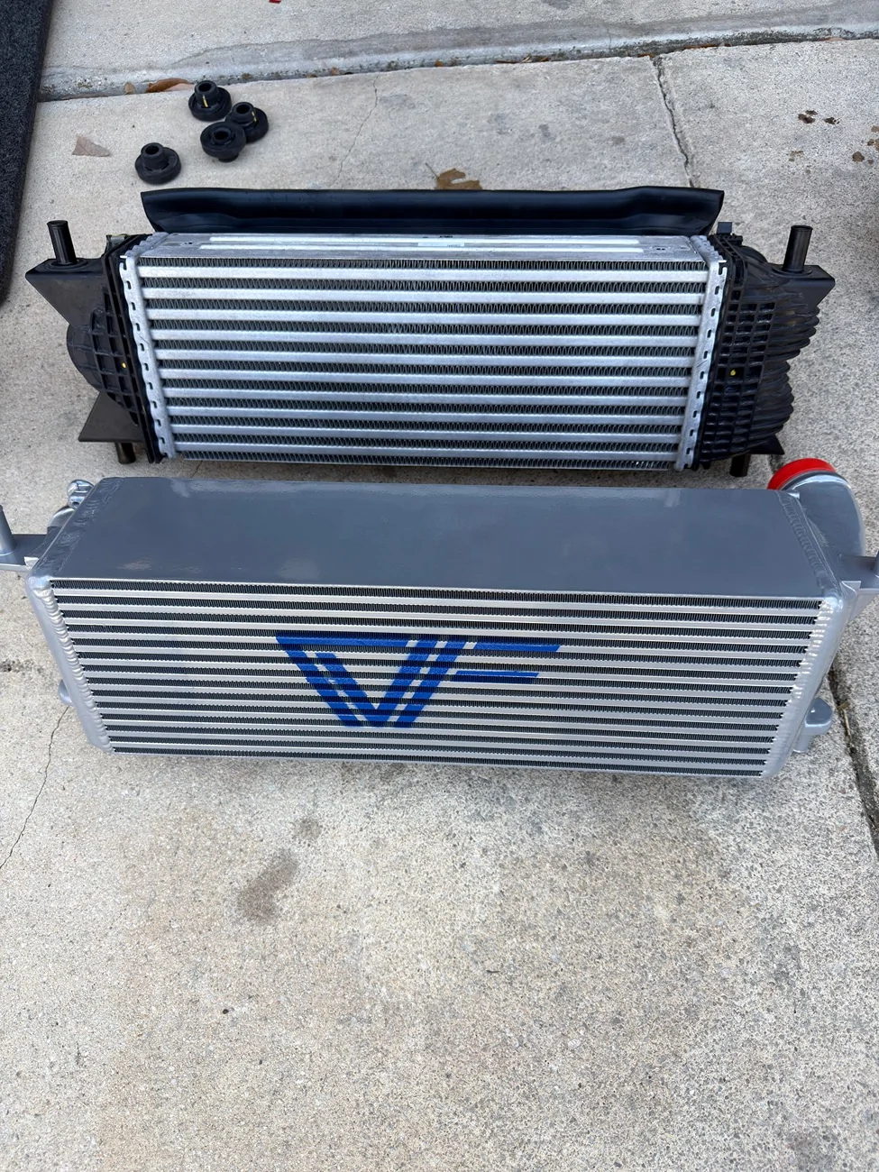

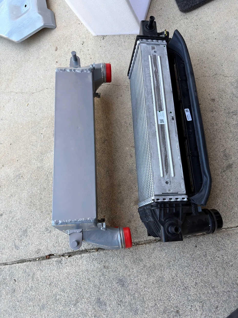

Mine showed up today. Not an install guide in sight either eh? For the cost the quality seems solid, but zero details on install is a big negative. Recalled seeing how you use the Whipple install guide.
I guess they're not going to bother with one and use someone else's. I still haven't yet but on the next month is the schedule. It doesn't look that complicated.

I did the CVF it was easy and took about an hour only a few bolts did not have to jack up the truck,
the shutters have to come off for the install and reconnect the shutter motor and snap tie it to other wires by the front grille or you will get a CEL.

I pulled the shutters ahead of time and it will generate a code but without the light coming on.. I ran codes after and found it. I have a fix that I'm about to test to the code won't generate.

So far after watching Braptor install vids I am not impressed. I was thinkin it's more like the Turbosmart IC and straight swap.
If I have to remove the bumper and ditch parts I may request a refund and eat the loss. I want simple and easy, if that means paying more...sucks. The lack of any install docs should have been a clue. I
