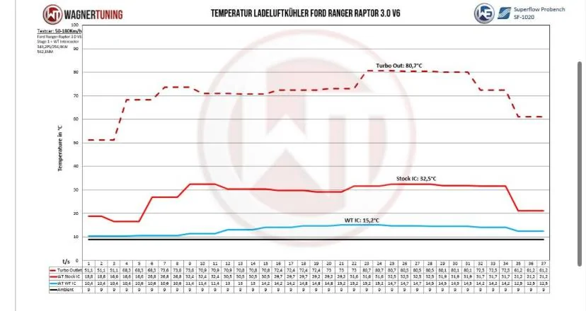

I’ll be picking up the wagner when available. Especially since I will be running the ford performance tune.
From their graph, it fixes the rapid spike under wot, and while does climb a bit, seems like a good compromise.
Ford Ranger Ranger Raptor Intercooler List Thread IMG_1614
I’m going this route for the lower cost, and to avoid the potential added lag tradeoff from volume of process west stage two.
