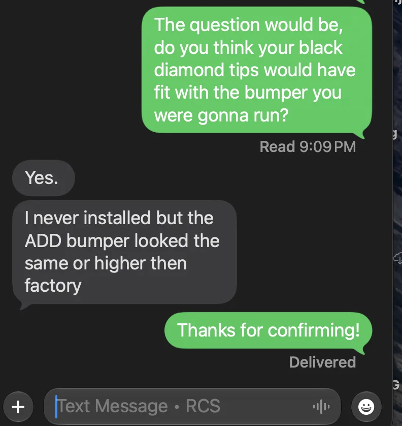

@DirtDerrick. Do you actually have the diamond black tip AWE exhaust in stock? I was told by AWE they are mostly made when ordered. I also have ADD phantom rear bumper and have not got a clear answer if I would have fitment issues. Any customers you had with that bumper? I don’t want to deal with fitment issues because of my bumper.

Let me ask the gentleman who's truck they used for development. He had front and rear bumper, but I don't think he installed them yet. One sec

Here is his answer.

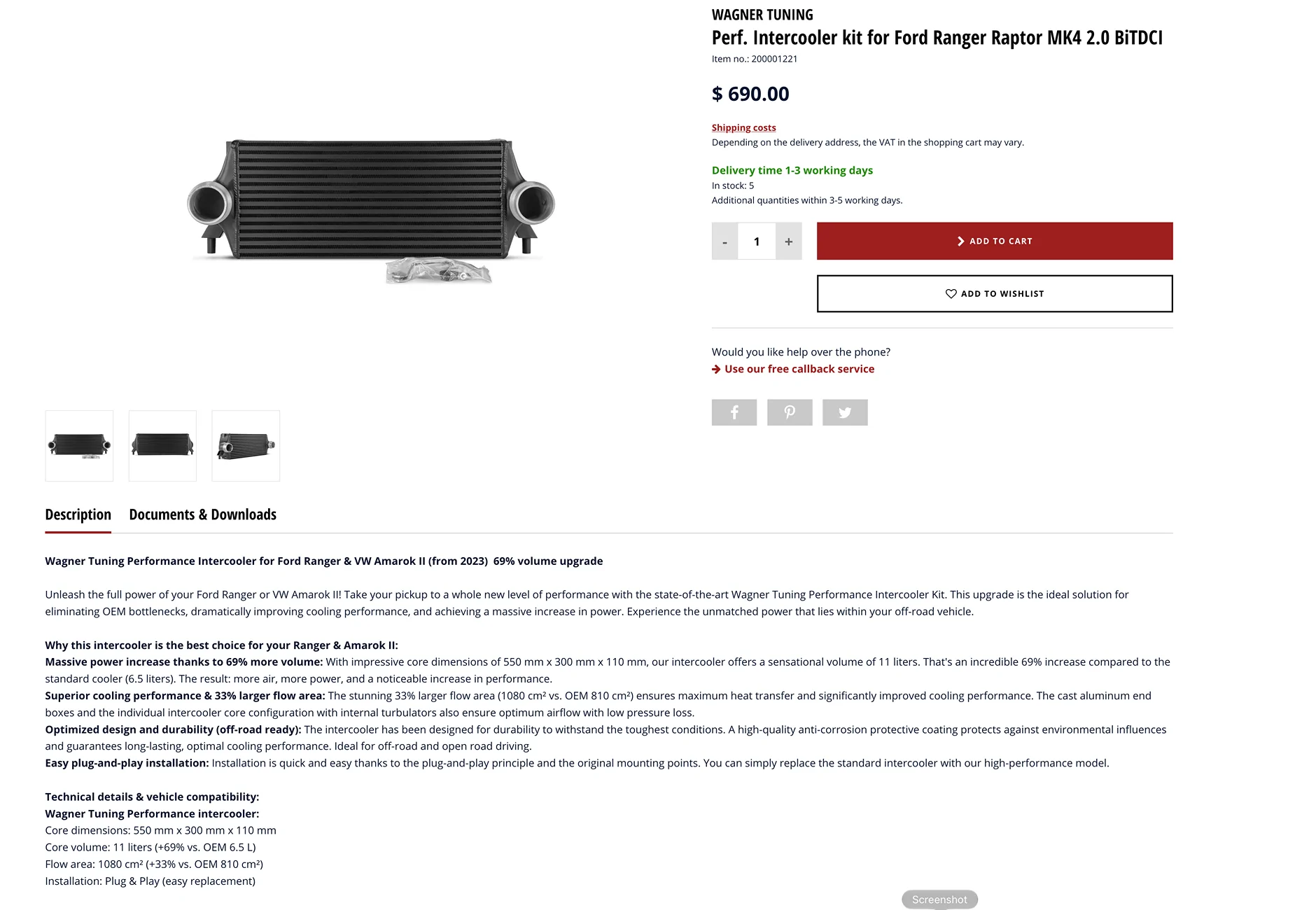

I can discount this one as well, if the DSR route is the way you wanted to go.

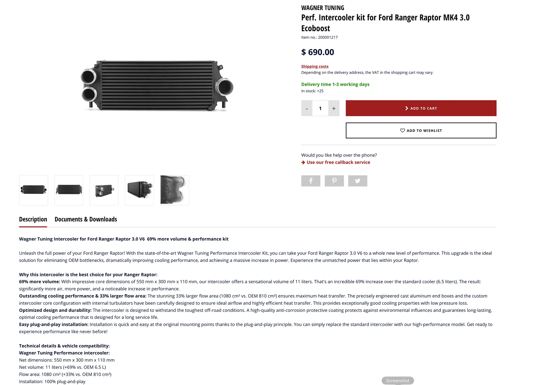

Wagner one is
With a core size of 550mm x 300mm x 77mm Can do this one for $800 shipped to you. In stock.
DSR one is
Core Dimensions 550mm x 300mm x 90mm
That Wagner looks interesting, but it's for a 2.7L. But, the DSR one looks like a pretty common core option from back in the day, so it's their pipes I'd really be needing for the Raptor.

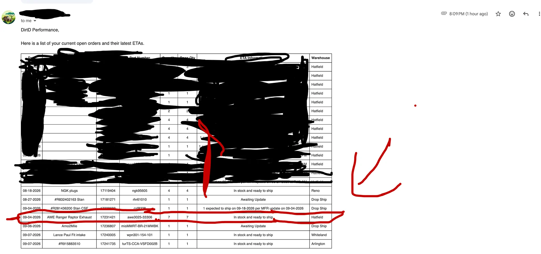

"Do you actually have the diamond black tip AWE exhaust in stock?"
My latest report from 8:09pm est. See below.
Ford Ranger Ranger Raptor Intercooler List Thread Screenshot 2026-09-07 at 9.24.29 PM
Yes. It is for a 2.7. I was just showing you a cheaper option here in the US.
You can get the Y from the 2.7 pipes.
Also the 2.7 intecooler from some company's are the same one as the 3.0.
They just added another hot inlet for the 3.0.
Lots of stuff from the bronco, Ranger 2.3, and Ranger 2.7 cross over.
Some perfectly, some require creative thinking.
Ford Ranger Ranger Raptor Intercooler List Thread Screenshot 2026-09-07 at 9.33.42 PM
Ford Ranger Ranger Raptor Intercooler List Thread Screenshot 2026-09-07 at 9.37.12 PM
Ford Ranger Ranger Raptor Intercooler List Thread Screenshot 2026-09-07 at 9.34.23 PM

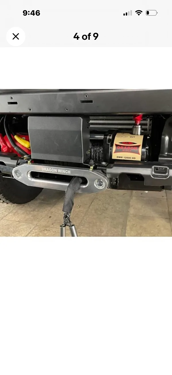

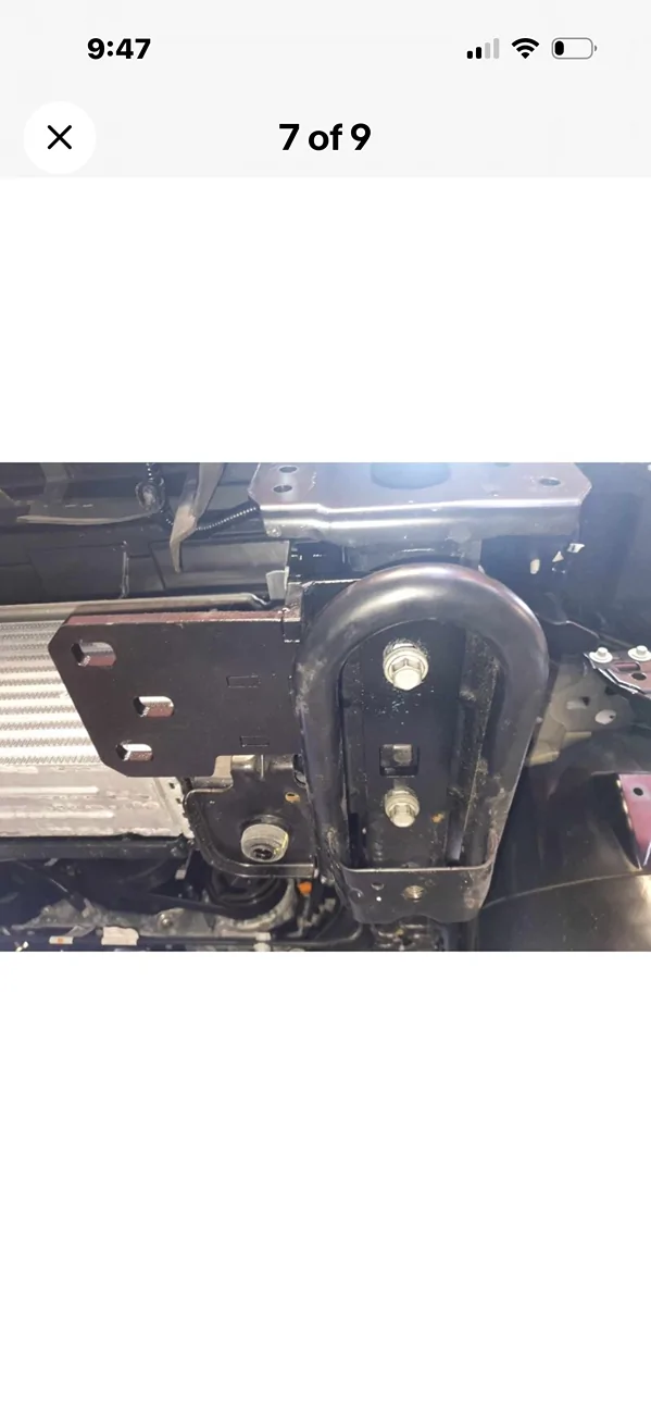

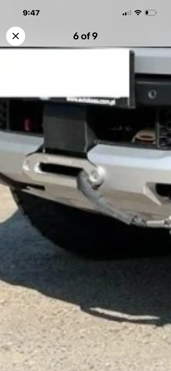

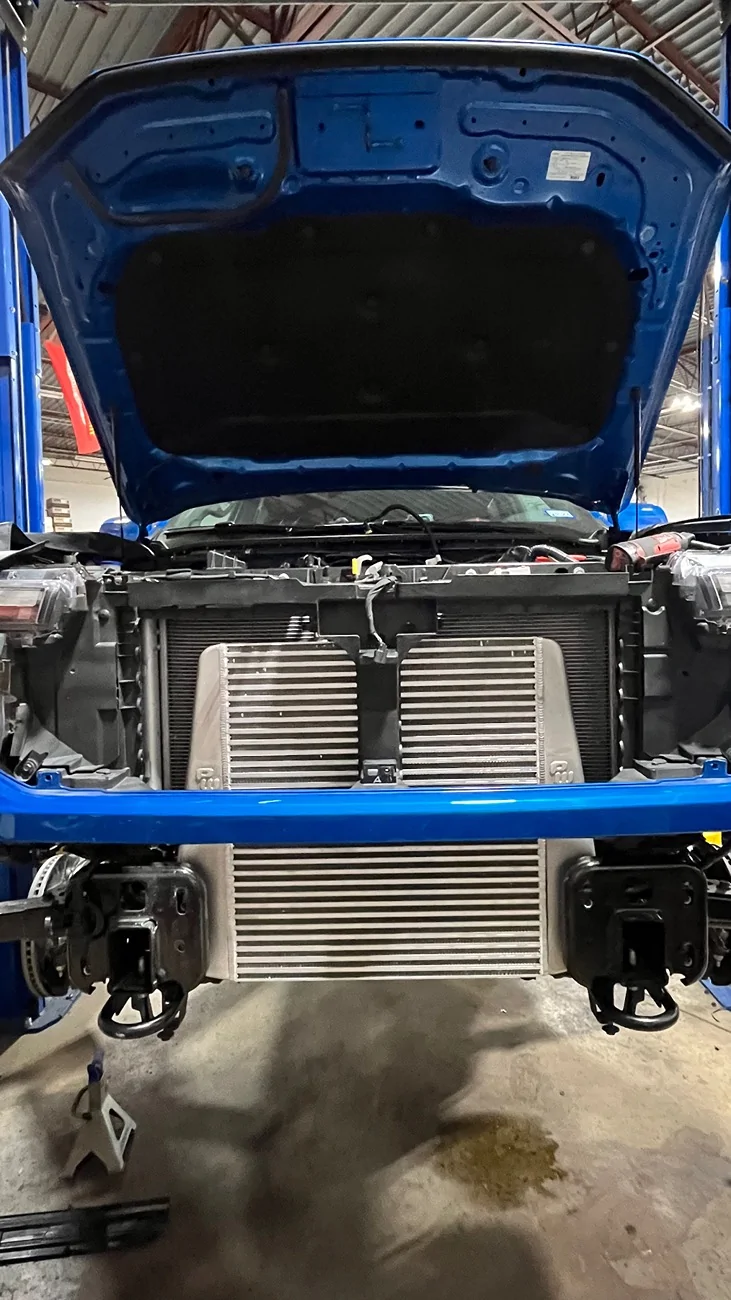

Buy the turbos—you will never find them that cheap—anywhere. Or the AWE exhaust—you can’t beat that deal either. I see you were looking at the DSR intercooler. I also wanted an option for a winch. Almost all the stage 1 aftermarket Intercoolers get fatter going forward and take away space for a winch. Have you considered the Process West stage 2? I have one. It is only about 2” thick—where a stage 1 is about 5” thick. There appears to be plenty of room for a winch. Every winch bumper I have seen is designed to run with the stock Intercooler shutters in place. The PW stage 2 removes the shutters and is thinner than the factory Intercooler (because it is almost as big as the radiator —it’s thinner). I had measured it out, and it almost would fit a hidden, behind the bumper winch—something like that new Warn flattop winch. More importantly the PW is $1k cheaper.
If I was going for max power I'd be on the turbos and PW2, but those days are behind me. I'm happy with what it has, minus the 107mph governor.
I'm thinking of putting the winch in the stock bumper, and from what I've seen behind the lower valance, a high mount IC is necessary to free up that lower area for a winch plate. I'm not 100% sure it's feasible, but until I'm at the point of needing a winch for an upcoming trip, it's vaporware.

a few pics to show the room in there with a hidden winch mount. The first pic is my truck with the PW stage 2. The remaining pics are with the hidden winch mount installed with the stock intercooler and no shutter. There is more room with the PW than the stock IC.
