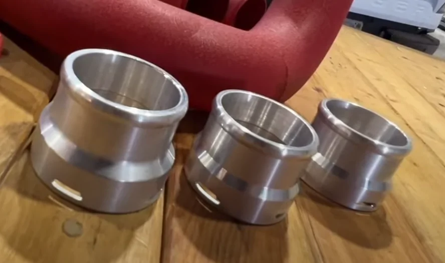

I got the full kit from fenix, pipes and intercooler. Quality is amazing. Only thing I would add would be the oem pipe to intercooler fittings to switch back to oem intercooler during ford visits and not having to take out the whole pipe kit. Anyone know any place I can get these alone?
I've been looking at this kit and have been considering it over the Cobb intercooler & AFE charge-pipe combo.
It comes in less expensive than the Cobb combo, but the fittings are also my concern if I were to need to take it to the Dealer for any Warranty work, like the dreaded cam-phaser.
The Cobb intercooler has a leg up on the Fenix one being that Cobb intercooler has a CARB EO# and is 50 State legal. This alone makes me lean towards Cobb, but I would need to wait for a Sale before I would buy it.

Definitely go for COBB and have your dealer install the piping so you can have everything under warranty. It just takes 8 bolts to replace the intercooler once you are out of the dealer. Regarding afe I noticed half the kit is silicone so to save your bucks either go full metal with process or keep the stock one which is solid unless you plan to up the boost.
