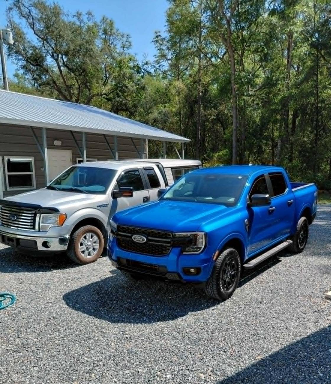

Just bought this gorgeous Ranger 2 weeks ago. Now the brakes are intermittently losing pedal, it goes almost to the floor and you have to stand on the pedal hard to get it to stop. Ford dealership has it and said they are replacing the front pads and shaving the rotors. Seems like this is not going to help as sometimes the pedal is high and it's easy to stop, it is like it is losing pressure. Anyone else have this problem? Thanks.
